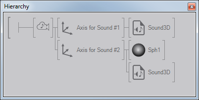

To create such effects the combination of two Nodes is necessary. The SoundSource 3D node represents the position, velocity and orientation of the sound source. The ViewListener node represents the position, velocity and orientation of the listener.
The SoundSource 3D Node represents a sound source which can be positioned in 3D space using a regular Axis node. This node comes with a multitude of input properties to control the 3D sound effect.
