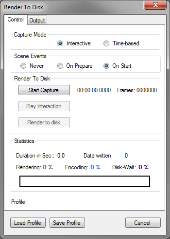

The Control tab provides some scene initialization options and the main controls for the recording and playout steps. The Scene Events option specifies if the active scene should receive a Scene Activate event when the playout starts. If this option is either set to On Prepare or On Start, the scene will act as if it just has been loaded. The option On Prepare is only available in Interactive capture mode. In this case the event gets fired before the initialization phase of the recorded interaction. Nodes like Scene Event, Movie Clip as well as state based Keyframe Animations react on Scene activation.

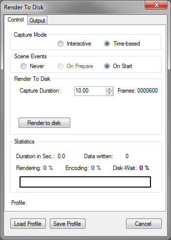

The option Capture Mode specifies if interaction with the scene via mouse, keyboard, touch devices or TUIO devices should be captured during the recording step (Interactive mode). In Time-Based mode, only a capture duration can be specified and scene interaction is only possible via the Scene Activate event.
In Interactive mode, the Render To Disk section provides controls to start and stop the recording steps. If user interaction has been recorded, it can be played back by triggering the Play Interaction button. The actual playout to disk is started by pressing the Render to disk button. Note that both buttons are disabled if no recorded data is available.
The interaction recording is divided into two phases: in the first phase (preparation) the user can record, reset and initialize inputs; in the second phase the inputs for the actual playout are recorded.
In time-based mode only a capture duration can be specified which defines the number of frames to capture.

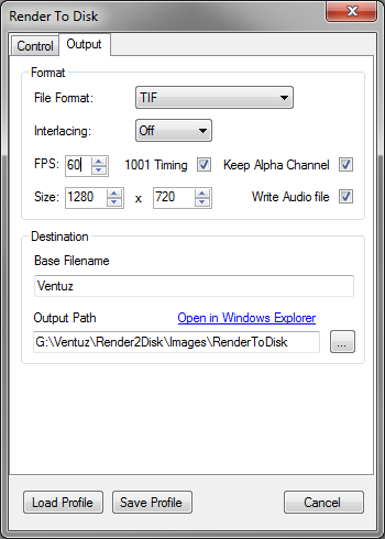

The Output tab provides options to specify the image or clip format of captured frames, the frame resolution, the capture frequency, the file naming and the destination folder.
Four Image File Formats are currently available, all of them supporting an alpha channel: BMP, PNG, TGA, TIF. Following movie formats are available: the QT Animation format writes a Quicktime Animation (loss-less RLE compression) in a MOV container; the HuffYuv writes a movie with the according codec to an AVI container; the XDCAM format creates movies in XDCAM 442 format to MXF container. Note that the XDCAM format only supports the standard 720p, 1080p and 1080i broadcast formats.
For Render-To-Disk in XDCAM format an additional encoding License Option is required! Please contact Ventuz Sales for license questions. Without license the created movie is branded with a Ventuz logo.
The Interlaced Mode option specifies if the captured frames are saved in a progressive mode (Off) or two consecutive frames are saved in an interlaced format (On).
Keep Alpha Channel option specifies if the alpha channel of a captured frame should be preserved or dismissed. The removal of alpha is a separate operation because a Ventuz scene frame is always captured with alpha.
If the option Write Audio file is enabled a .WAV file is written. This file is always two channel, 48000Hz PCM, 16bit that contains the audio passed to the first stereo pair of the Ventuz audio output device. See also Audio Devices
If speed is an important factor, PNG is not a good choice. It is the slowest format to encode, although generating the smallest files...
The FPS value defines the frame-rate of the image sequence. A value of e.g. 30 will generate 30 images for every second of rendering. If 1001 Timing is enabled, the resulting frame-rate is calculated by FPS * 1000 / 1001. This provides the possibility to capture with frame-rates like 59.94 and 29.97.

The two Size values specify the render and capture frame resolution. The default value is set according to the Direct3D Project Properties. On graphics cards with sufficient memory this value can be set up to 16384 x 16384! Note that extreme resolutions will make the playout very slow and need huge disk-space!
The Base Filename defines the naming for the image files written to disk. A five-digit number is automatically appended to the base name so that the resulting image names look as follows:
<baseFilename>_xxxxx.<imageFormat>
The Output Path specifies the destination folder for the image sequence. Click on the Open in Windows Explorer link and a new Windows Explorer window with the specified path will be opened if the path is valid.
