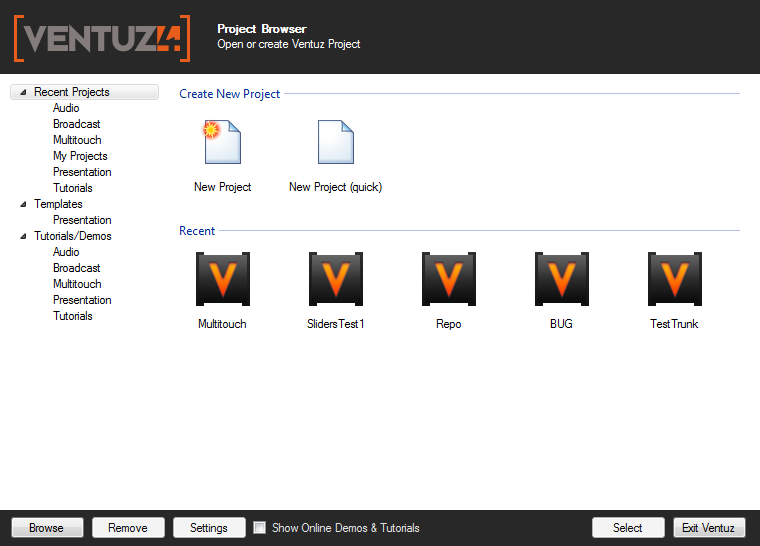

The first thing you'll see after the Ventuz Designer has finished launching is the Project Browser. A project is a collection of presentations (called scenes) that use common resources (Assets) such as images, movie clips and so on. Since you don't have one yet, choose "New Project". Once you have created and used some projects, they will be listed in the "Recent" section of the browser for quick access.

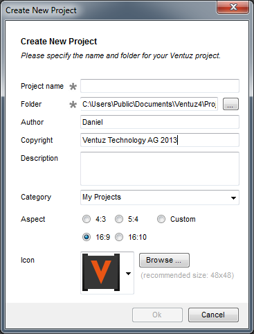

A project stores global information about the project like Project name, Folder , Aspect Ration and do forth. Fill out the fields and press Ok to create the project.

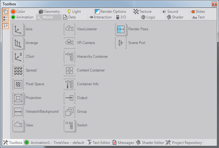

Once you're done, the project will be created, opened and you'll see the Ventuz User Interface which consists of multiple dockable windows. Ventuz automatically has created a new empty scene and since there is nothing in there yet, the render output in the lower right corner is black. Let's change that. In the lower left corner you'll find a tab saying Toolbox. Click on it to activate the Toolbox which hosts all the Nodes that are available in Ventuz.

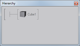

Nodes are the building blocks for constructing a Ventuz scene. Each node has a name, an icon and some function it fulfills. There is, for example, a node to render a Cube. Click on the Geometry tab inside the Toolbox and locate the icon next to the label saying "Cube". left mouse button Left-click on the icon and hold the mouse button. Continue to hold the button and move the mouse cursor straight up to the big area with the label Hierarchy on top of it. Release the mouse button and you should see a white square in the render output. You have added your very first node to a scene.
Hierarchy and Content
The area you dropped the node in is called the Hierarchy Editor. The Hierarchy of a scene is a tree of nodes that tells the graphics card what elements and in what order it should use to render the scene. This can be geometry, Axis to position elements, material assignments, and much, much more. You may have noticed in the Toolbox that there are nodes that have black brackets to the left and right of the icon and others with orange brackets at the top and bottom. The former ones are Hierarchy Nodes which belong to the Hierarchy, the latter are content nodes which belong to the Content of a scene. As you can see in the Content Editor (right next to the Hierarchy Editor), the cube belongs both to the Hierarchy and the Content. This is true for all Hierarchy Nodes. In contrast, Content Nodes only exist in the Content Editor. They provide or process information but do not directly interact with the way the scene is rendered. For example, the Windows Mouse node can be used to track the current mouse position which in itself does not change the render output. Go to the I/O tab and drag a mouse node to the Content Editor. Did you note that the Mouse icon had multiple lines around its icon? This is because there are multiple nodes listed under that icon. When releasing the mouse button after dragging to the Content Editor, Ventuz will ask which of the nodes in the list you want to insert. Choose Windows Mouse.

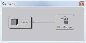

Select the WinMouse node. Unlike the Cube, this node actually generates output values. To check what the current values are, click on the small magnifying glass icon on the top right of the Property Editor (Monitor Values). Now click into the renderer window and as you move the mouse, see how the values change. So what can we do with this? Actually, quite a lot. We can actually use the outputs of one node to feed the inputs of another.
Select the Cube again and switch the Property Editor back to inputs. Again, locate the row with the label "X" but now drag the name on to the mouse node. When you release the mouse button over the node, Ventuz will pop up a list of all outputs on the mouse node that are compatible with the input you dragged. Let's say we choose "ClippedX". A black arrow is created between the two nodes in the Content Editor to show the binding. Now move the mouse cursor inside the renderer window and see what happens. The farther the mouse goes to the right boundary, the bigger the cube gets!
Okay, this may be a silly example, let's delete it. left mouse button click on the arrow between the two nodes and click on the little cross to delete the binding. Let's try something else:
