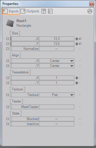

The following screenshots shows the properties of a Rectangle node:
The top row of buttons selects whether only input, only output or both property types in a split view should be shown. The button on the top right is the Monitor Values button. When activated, the user interface will update the shown values every frame. This causes a small performance penalty but is great for understanding what is happening in a scene. When deactivated, the values are only updated when the selection changes or the user chooses another of the four view buttons (input, output, splits).
Below the icon, name and type of the Node, the properties are listed, grouped in categories.
You might not see all these properties depending on your Ventuz configuration. The default behavior is to only show Favored properties when the selection is done in the Hierarchy Editor but show all when the selection is done in the Content Editor.
A property is favored to indicate that it is among the ones that are most often used by a typical user. This is visualized by a black bar on the left of the name column (in this case only the X/Y properties). One can access all properties by either selecting the node in the Content Editor as opposed to the Hierarchy Editor or by unchecking the "Show only favored Properties" option under Tools/Options/Tree Editors.
To mark a property as favored, double click on the small, left-most column (not the little box at the very left!). This column is only present when the selection has been done in the Content Editor.
If a hierarchy node is selected in the Hierarchy Editor, all favored properties of all content nodes bound to that hierarchy node are shown as well. For example, the file property of an Image Loader attached to a Texture Node is shown when the texture node is selected.

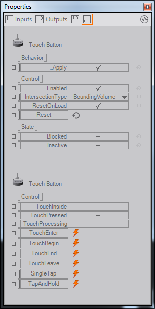

Most properties represent values that influence or are generated by a node. A number of nodes also generate or listen to events that fire when a certain situation arises. The following screenshot of the Touch Button node show both input and output properties and events.
The red square next to the Reset property can be clicked to fire the Reset event, in this case causing the button to reset to its internal state. The output events on the other hand fire when a certain situation occurs, for example the SingleTap event is fired when the user presses and releases
the button within a short timeframe. Apart from triggering the action the button is intended for, this could, for example, also be used to animate the color when the button is pressed to give the user a visual feedback.

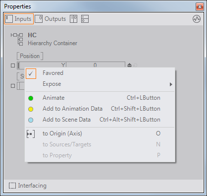

If one wants to navigate to the node that exposes its properties to the higher container level, a long click
on the interesting property will display a context menu. Not all menu entries are enabled. This depends on the exposing level and the binding state of the selected property. For the navigation in an Exposing hierarchy the menu entries to Origin and to Origin Root are useful. to Origin navigates inside a container to the node that exposes the selected property. This can be any of the Ventuz node. to Origin Root navigates to the root of an exposing chain over multiple container nodes. In this case the destination node can be any of the Ventuz nodes except the container nodes.
If an input property is bound, the menu entry to Source Node will navigate to the node which is bound to the selected property. The navigation to Property is only possible if the Favored option is enabled. In this case a Hierarchy node inherits the favored input properties of all bound nodes for display in the Property Editor. Selecting to Property on such an inherited property will navigate to the real owner of this property.

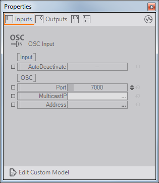

Some Nodes like OSC Input Node or the Script Nodes can have a user-defined number of Properties. The ability to add or remove properties is called a Custom Model. It is usually accessed by a button at the bottom of the Property Editor.
