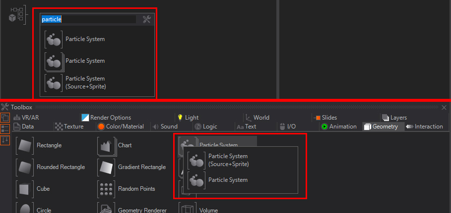

There are two different presets to create a Particle system. You will find the Particle System node and the Particle System - (Source + Sprite) node available to select from.
The Particle System will create a simple and empty particle node which has no inline stream nor any kind of module or modifier. You would need to create the inline stream and the according modules on your own, you start with the very basic empty particle system in this case. The Particle System - (Source + Sprite) starts with a very basic system, which contains of an emitter (Source) and a renderer to at least create a basic fontain without gravity. The last system is used to have a rough starting point and is good for basic "try outs". The mentioned Inline Stream is basically where you start a particle system in. The stream goes from module to module and therefore changes or alters the behavior of a particle - they read and write to the attributes. Basically the most compact stream would be the Particle System (Source + Sprite), it contains as mentioned above just of a source emitter and a renderer. Therefore the stream would look like : Particle got born - "emitted", has basic values like lifetime, size and direction and got "rendered"... and hence the lifetime it will die. As another alternative to understand the inline stream or the stream itself the section for the fretboard would be a good further reading.

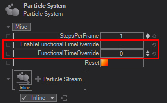

The simple differences from a designers perspective between a functional and a simulated particle system is that you would be able to scrub the particle time in a functional system. This makes it possible to pause, forward and play the particle system also backwards. This way you can have an explicit timing possible - you have full control over the timing. You would enable the timing control by using the EnableFunctionalTimeOverride boolean and use the FunctionalTimeOverride value to scrub or animate the time.
A simulated particle system can be created by simply using the according module for it - Simulation. As soon as you use the module Simulation the Functional Override or the Functional System will no longer work. Enabling the Time Override and Scrubbing will be ignored and have no effect. With a simulated system you can now use the Collision- and Curl Node, as well as some more which would need to have a simulated system. The reason is the difference in the Particle system internal calculation. A Simulated Particle System will need to calculate the next frame for the single particle based on the attributes from the last simulation step (or frame), therefore it is possible to have a collision or bounce from a collision plane only if we can change the velocity-, speed- and direction change based on the actual frame. The information for such are stored on a per frame basis. These information can then be used for the next frame to estimate the new position and behavior for the particle. This calculation is then called a Simulation loop.

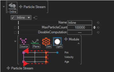

The Fretboard

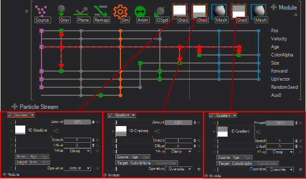

The above Image shows a typical Fretboard from an example Particle System. The Fretboard is made to help you understand whats happening inside the Particle System and guides you which module uses a certain channel and modifies that, such as the Position, Velocity, Age, Color, Alpha, Size and so on. The Fretboard can be read and understood as follow: On the very left side you mostly see an emitter - even a secondary emitter which is depending on an already existing stream. On the very right side you see the used and available channels, for example Age:
The Source particle starts with an Age, the Age is used for several modifiers, like the Gravity, and three times by the Gradients. In the case for the Gradients you can see that the Source is the Age and the Target for each Gradient is Size and two times for the ColorAlpha. That means for the over time (Age) the color or alpha (ColorAlpha) will change for the particles. So by analyzing the Fretboard you can see what individual channels control or where they are used for - at which point a value gets grabbed and modifies something else.

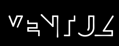

The Path Emitter can use any 2D SVG ,3D imported- or vpath to generate particles from. There is an option to use multiple paths. The difference is that the particle system will take for example a text as a single path or each indiviual letter. If you shorten the Extend value to 0.5 animate the Mid value from the Path Emitter you can see the particles emitting as a flow from letter to letter:
If you check the MultiplePaths property you can see that each individual letter will emit particles at once:

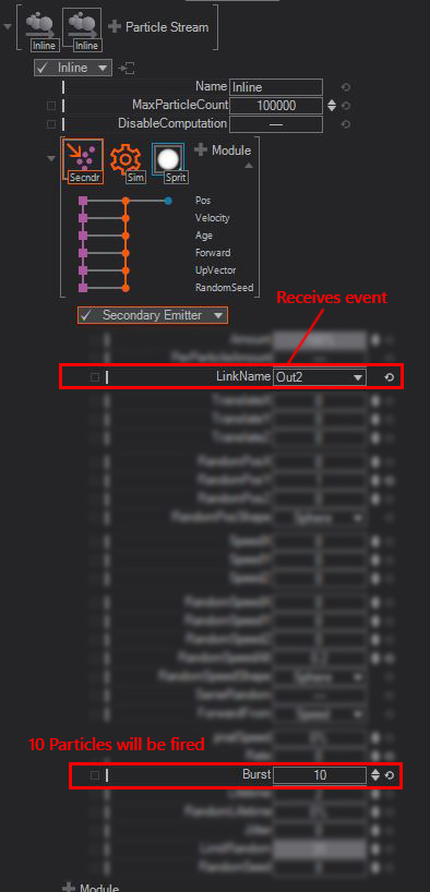

The Secondary Emitter makes it possible to hook another stream onto an existing particle by using the LinkName. This way it is possible to create trailing particles, which follow a single particle which has been emitted by another emitter. If you combine the Secondary emitter with events from another module you can trigger the burst of the secondary emitter to emit particles as well. A good example of this is a raindrop creating a splash when it hits the ground or a firework rocket. Please refer to the Buffers and Events section in this document.

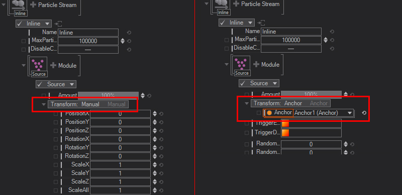

You can use the Transform property to change for example the position of a particle system. One of the best use cases is to have the Particle System follow your mouse position. To do so you can bind the X/Y/Z values of the particle system transformation to your actual mouse cursor position. Another useful option is to use the Anchor and the Anchor node instead of a manual transform.
The best result for a moving particle system would be a simulated particle system, since the particle source only will follow your mouse, and the already emitted particles will stay in place.

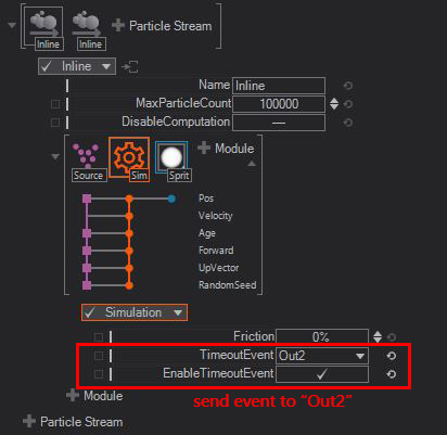

The particle system has an internal event system which you can use for several use cases such as firing the burst for another inline stream. Events can be fired from a Collision-, Simulation- and Touch module.
You would need to enable the send of the events by set the appropriate boolean and set a unique name for the buffer to write the event into (Out2).
A receiver for such events could be a Secondary stream, which would fire the burst for this stream - in this case whenever the event named Out2 has been fired.
Events can be send upon a hit on the collsion or a bounce off the surface, if a particle is dead because its lifetime is exceeded or manually by using the Touch module.
