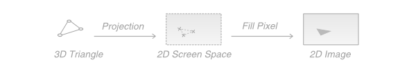

The purpose of a graphics card is to create a 2D image that can be shown on a screen, and that of course as fast as possible. Over the years, two major techniques have been established: Raytracing and Rasterization. The former is primarily used in movie production or anywhere else where the time to create an image is less important than the quality of it. The name Raytracing comes from the process of casting rays through the 3D scene in order to calculate what the user sees at a given pixel from his point of view. In its simplest form, such a viewing ray may bounce between various objects until it hits a lightsource, at which point the algorithms can calculate what color the pixel that cast the ray should be. While this can be quite computationally intense work, raytracing can easily deal with shadows, reflections, transparencies and many other real world phenomena. Although many optimizations have been made over the years and processor power has increased tremendously, raytracing is still too performance intense to create 60 or more frames per second from a scene that constantly changes.
While Raytracing tries to mimic real world physics, Rasterization takes the completely opposite approach: It projects triangles to the screen instead of searching through the 3D space. The vertices of a triangle run through a series of matrices to simulate the effects of a camera such as perspective shortening, thus transforming them from 3D space to a 2D space.
The main part of this projection process is split into three matrices:
  • World: Used to position an object in the scene. Most objects are modeled to have their own local coordinate system with the origin, for example, set to the center of gravity. Using the world matrix, the object can be translated, rotated and scaled without having to change the vertex coordinates stored in the mesh.
  • View: Contains the position and orientation of the camera in the scene. Instead of moving objects in the world to have a specific position in the rendered image, the world stays fixed and the camera is moved much like in a real life photo shoot.
  • Projection: Simulates the effect of perspective shortening (i.e. objects farther away appear smaller). This is often defined by specifying a view angle (also called field of view). When a more schematic look is required, this can also be an orthogonal instead of a perspective projection which does not have any perspective shortening at all.
Once the 2D vertex positions have been calculated, the triangle can be converted to pixels by connecting the vertices and then filling the interior of the triangle. This step of going from a 2D continuous space to pixels is what gives the whole process the name Rasterization as the 2D triangle is discretized to the 2D raster of pixels.
Rasterization will generate a number of Fragments which can be thought of as potential pixel changes. A fragment contains the 2D coordinates of the pixel it belongs to as well as the color of the triangle at that point. Before assigning that color to the pixel, the fragment has to run through a number of tests which can each reject the fragment and thus prevent the triangle from changing that particular pixel. This can be used to mask off certain parts of the screen or prevent overdraw to simulate occlusion effects as will be described later.

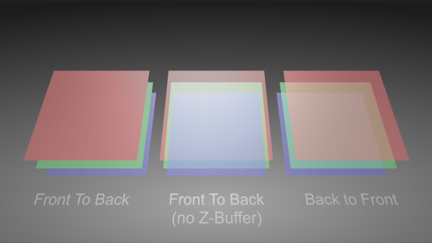

At one point or another, every scene will contain some (partially-)transparent objects. Whether it be the front window of a sports car or the surface of a pool of water, transparency is an important part of the physical world... and again, Rasterization is not really capable of handling it. Same as with visibility, transparency is the effect of light bouncing of a surface and traveling through a medium until it reaches the viewer. This interaction of multiple objects does not fit to the per-triangle fashion of processing triangles as Rasterization uses it.
What was introduced to address this problem is a way to influence how the contribution of multiple fragments to the same pixel is mixed. The alpha value of a pixel in a texture or the color of a material describes the opacity of the object, zero being complete transparent and 1 being completely opaque. When a triangle is drawn to a pixel, the graphics card computes a weighted sum of the existing and new color value based on their alpha values and a blending function. The most common use is to increase the contribution of the new color the larger its alpha value is, completely overwriting the existing color if alpha is one.
There is however one problem with this approach: The rendering order. Imagine three sheets of glass, each in a different color. Let's say they are, from front to back, red, green and blue. Each has an alpha value of 0.5.
In the left configuration, the red glass doesn't look transparent at all. Why is that so? The render order of the objects is red then green then blue. When red is rendered, the Z-values in the depth buffer are set and no fragment from another triangle with a farther away Z-value will be rendered at all. So there is no chance to blend green and blue because their fragments are discarded before blending.
In the center configuration, depth testing has been artificially turned off. First red is rendered with nothing to blend it with since it is the first thing rendered. Then green is rendered and blended and blue is rendered and blended. Each time the new object will take 50% of itself and 50% from the already rendered objects, so at the time blue is rendered, only 25% of red will be left.
In the right configuration, depth testing has been re-enabled but the rendering order has been changed to back to front: First blue then green then red. When red is rendered, it takes 50% of itself and 50% of the already rendered objects which creates the correct effect.
As opposed to occlusion testing, there is no simple way around having to sort the objects back to front. Note however that the amount of work can be reduced by first rendering all non-transparent objects in any order and afterwards rendering all transparent objects back to front.
