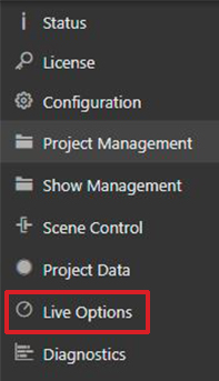

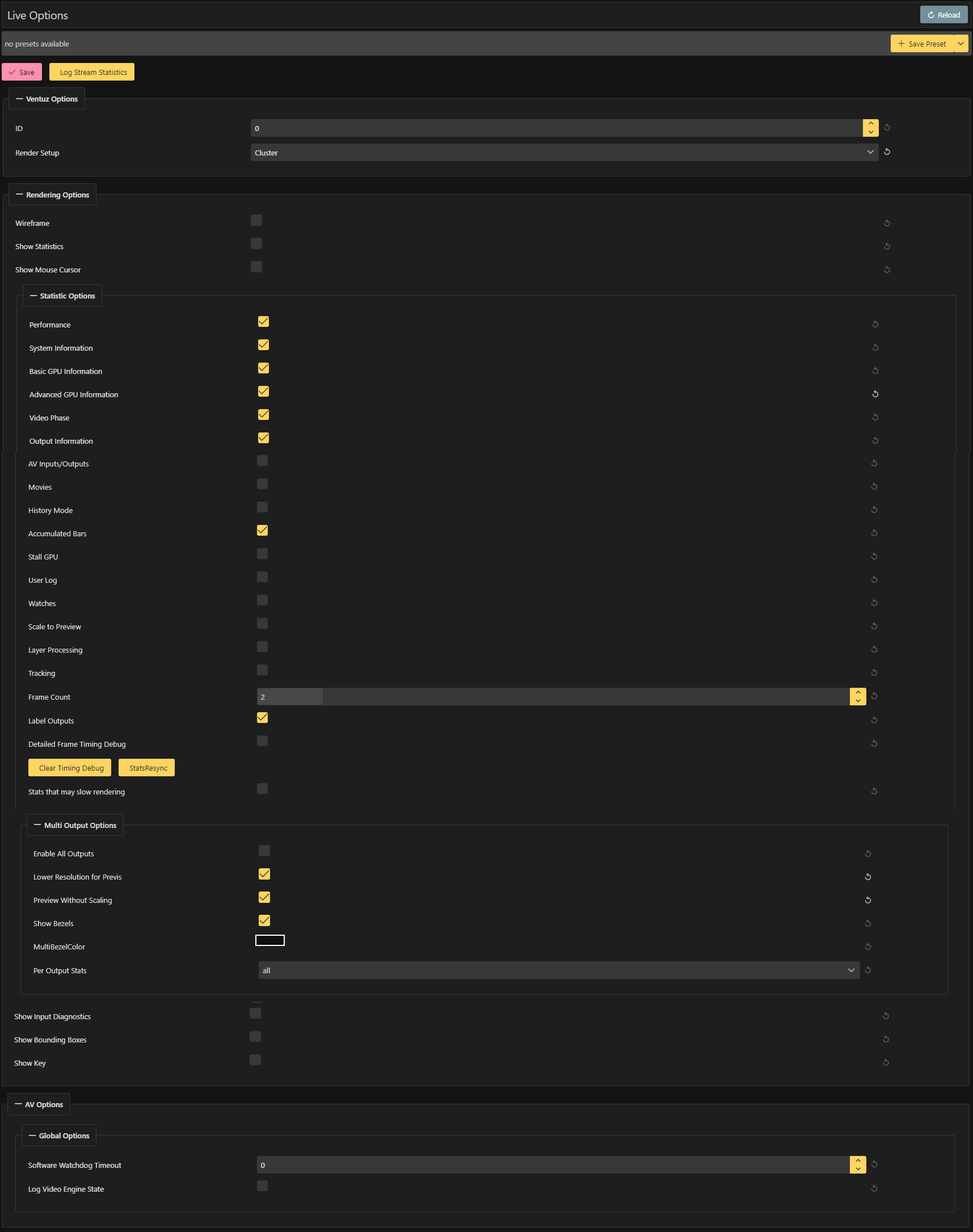

While running a show in the Runtime, you can access the Live Options via the Live Options either by the Configuration Editor application or by the Web Browser. The Live Options button will be grayed out if no show or scene is running. When pressing it you will be greeted with many options that can be turned on and off, for a detailed description of these options have a look here.
Another way to access the Live Options is via Remoting and will be covered later in this page.

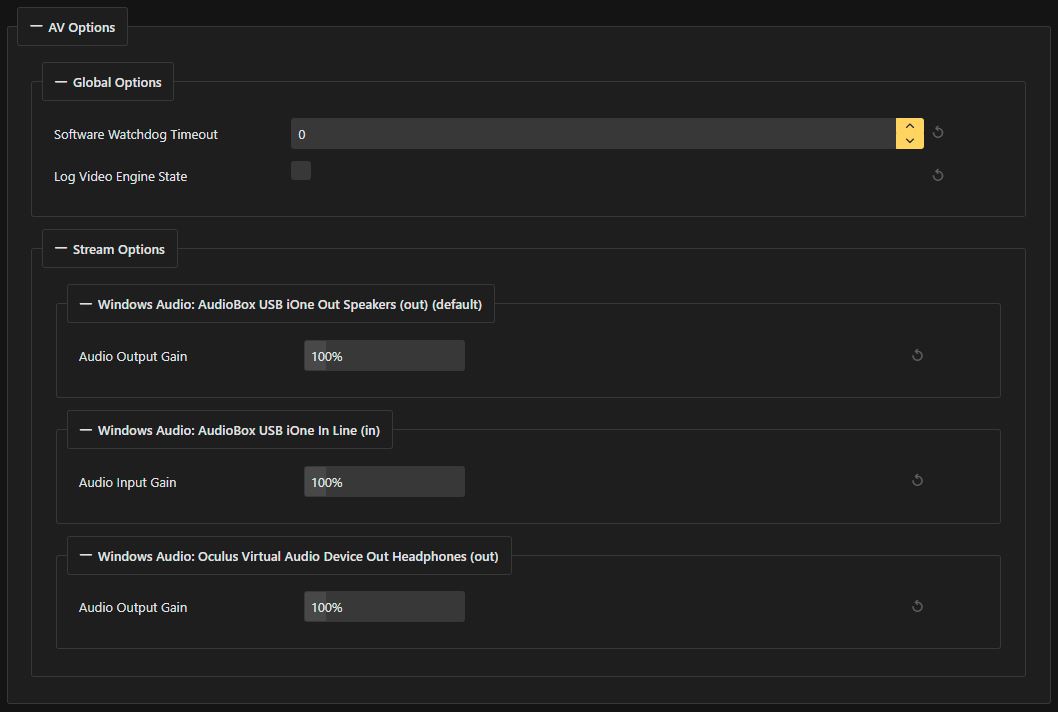

If you scroll down a little bit in the Live Options you will find options for controlling each of your configured audio devices.
Generally speaking, all audio devices needed for a presentation are setup in the Device Configuration before its start. Switching to non-configured devices is possible during a show but can impact the rendering.There are some properties that can be changed on the fly, like the audio gain. Which controls the volume.
To see the Audio gains while working in the Designer, Enable Physical Outputs needs to be activated to be able to see these options!

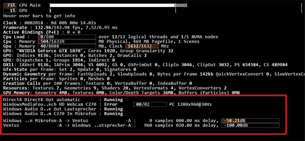

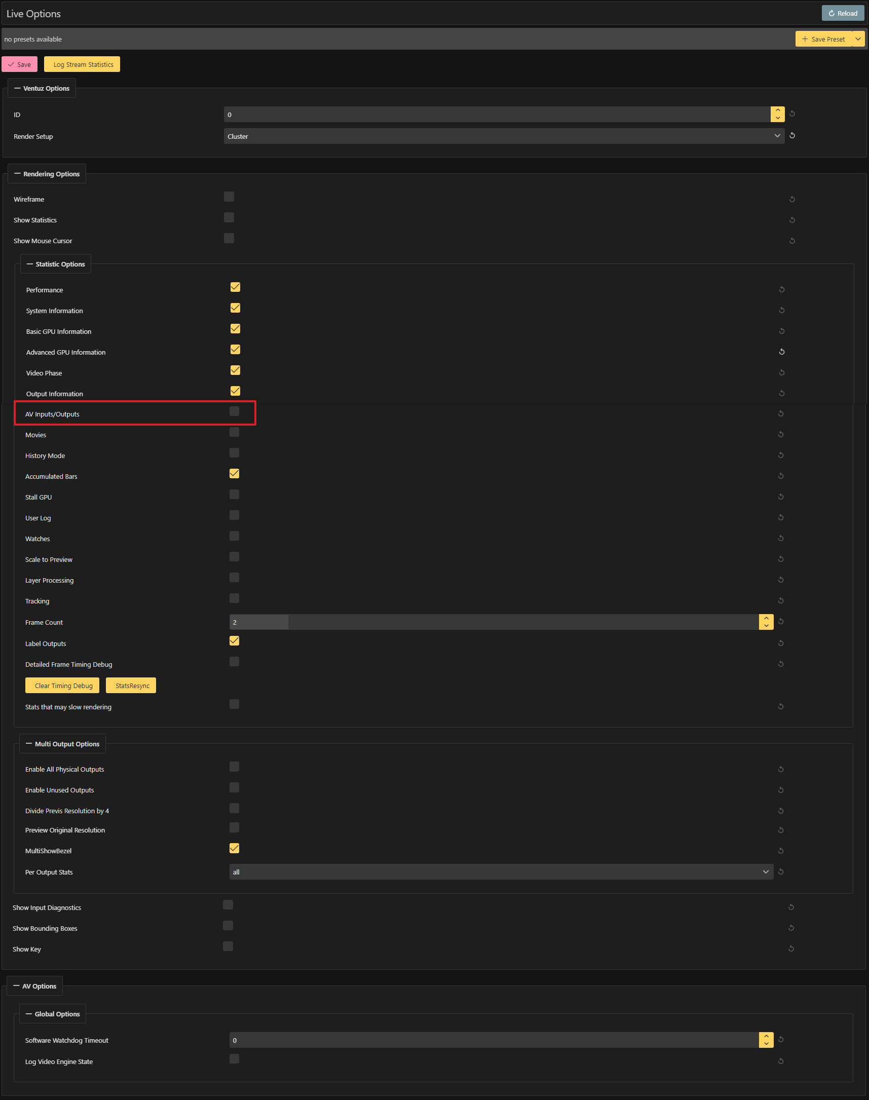

In the Performance Statistics section of the Live Options further up the list, you can find the Show Statistics and AVInput/Output Statistics flags. By activating both you get a overview of the connected devices and its status on the output of your running presentation.
Here you might find indicator on what might be wrong with your Audio - like devices that are not running or a that they are connected to the wrong ordinal. What these different states of the audio mean can be found here.

While most options of your stream must be set before starting the Ventuz Runtime, there are some options that can be changed on the fly to make their tweaking a lot easier.

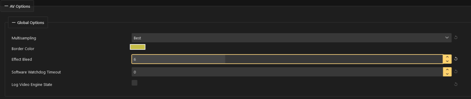

Multisampling:
  • Select the desired multisampling quality. Only affects the edges of geometries. It does not affect the quality of textures, texture based text or live video textures. Best (default): Selects the highest available level of multisampling quality depending on the output device. Medium: Selects the mid range (Best/2) of available quality levels. Low: Selects low quality level. None: Disables Antialising
Use the boarder color to see unused render space.
The Effect Bleed option in the makes it easier to adjust Post Processing Effects like the Blur in a Machine Cluster for video walls. Effect Bleed adds an extra margin around the rendered content. The value is the amount of pixels added to all four sides. It will not extend the visible/physical output, but will allow layer effects to create better results close to the machine borders in a Cluster Setup.
Log Video Engine State:
  • Dumps the current status of the rendering engine into the log when the checkbox is set.

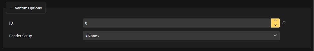

It is also possible to change the Render Setup on the fly to better test your presentation. The drop-down menu can be found on the top of the Live Options.

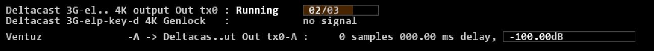

While working with SDI signals there are some things that can be adjusted while the Runtime is running. After activating the live options with the AV in and output, you will find this in the statistics:

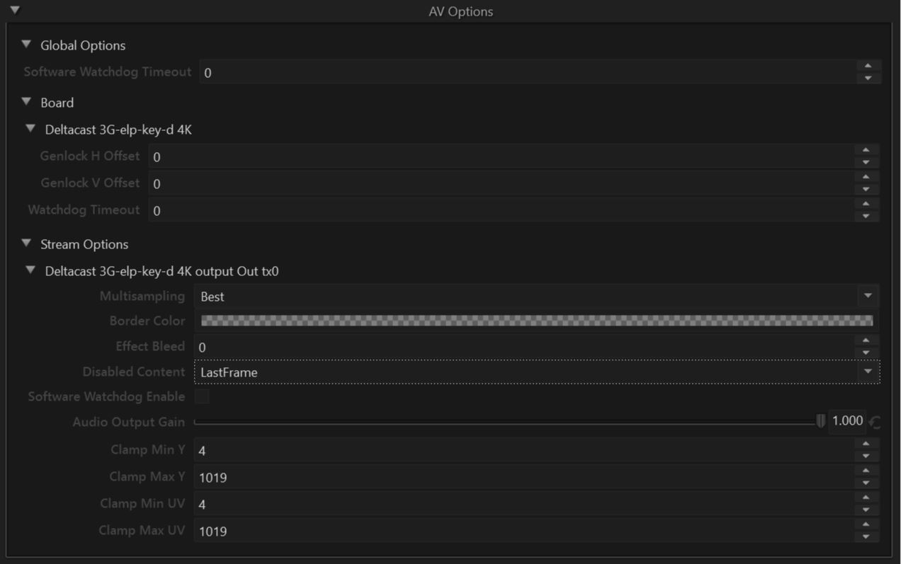

If you are using a ​Genlock signal, you can determine whether your output is synchronized to it or not. In the Live Options are some more things that you can troubleshoot.
Here you can offset the genlock either horizontally or vertically to match your signal. The timeout for the ​Hardware Watchdog can also be changed here. Please note this value is given in millisecond and for some boards there might be no hardware watchdog and only a software option.
Further down you will find similar options to the standard GPU options. Like Multisampling, Effect bleed, border color and disabled content. For a more detailed description of these options take a look right here. The Clamp Options can only be found on Video signals using YUV that can be clamped to a certain range. Values are always specified in the 0 to 1023 range of 10 bit. if the stream uses an 8 bit YUV buffer, values are internally converted to 8 bit. If the stream uses an RGB buffer, this option is not available.

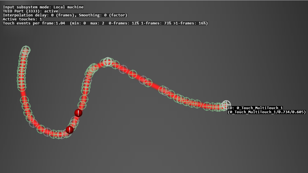

The Performance Statistics overlay displays several properties such as average number of updates per frame, and input sub-system mode. While a minimum of one touch is inside the render window, markers are drawn to visualize the raw touch input:
  • Green markers show position updates that were used.
  • Gray markers show updates that where dropped when there were more than one update in a single frame
  • Red markers show a frame where there has been no updates from the device although the touch was moving above a certain internal threshold.
  • Yellow circles show the processed position used by Ventuz when smoothing or interpolation is activated.
Input Diagnostic is currently not supported for 3D/VR controller, Previs Portal Touch and inside the Design Preview!
If there is a issue with the Touch input you will most likely spot it in these Diagnostic. These ! marker will most likely appear because there was no data send. If possible try changing the send rate of your input device to make the tracking more accurate.

As mentioned in the beginning there is a third option to change properties in the Live Options. Via Remoting4 and a few lines of code you can e.g. change render setups from within your remoting program or your Ventuz Scene. This needs to be prepared beforehand inside the Designer with the C# Script Node. You can copy the following lines of code directly into the Editor. Read the comments or take a look at this page.

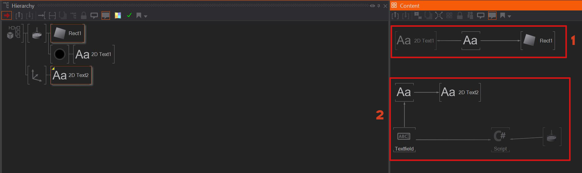

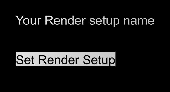

In order to use this script you need to setup a small logic to be able to switch the setups directly in the Runtime - following is a short example of that.
  • 1: The Text Provider Node's Bounding Box Property is set to static and the Rectangle's Size X and Size Y value is connected to the Text Provider's Width and Height. This
  • 2: The second text node is connected to the IME textfield input, and the C# script node is also connected to the IME node with the "RenderSetupName" property. Also the "SetRenderSetup" property is connected to the single tap event of the touch button.
With this setup you can simply type in the name of your render setup that you want to switch to and click on the button. Now you only have to export it as a Ventuz presentation(.vpr) and start it.

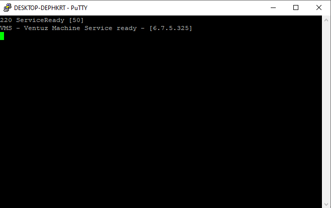

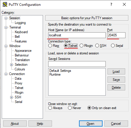

With the help of a ​Telnet Client like ​PuTTY you are able to remotely control some functions of Ventuz. In our case we are going to discover which Live Options are remotely controllable. Visit the Wikipedia page, if you need to find a download link for PuTTY. Alternatively, you can also use the Windows Telnet Client. If you are connecting from the same pc, you can simply type in localhost for the IP address. Connecting from another pc in the same network needs the local IP address. Ventuz is using the port 20405.
Here is the PuTTY client window. Make sure you selected Telnet as connection type.
After starting you should see a message that tells you that the VMS service is ready. Assuming the Runtime is running.

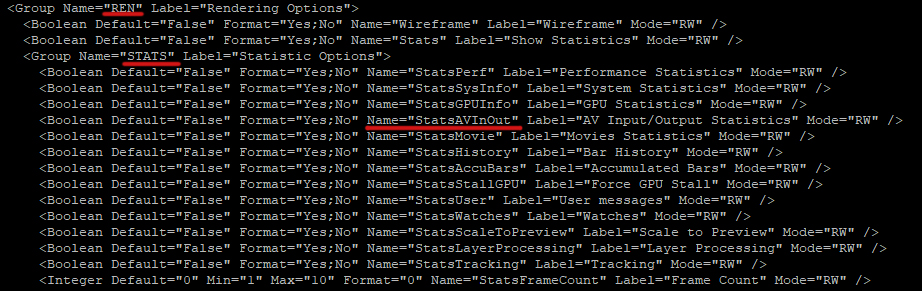

Here you can find a list of all available commands. But for now we are concentrating on the OPT command which holds the live options. If you just type in OPT you will see a list of all available command groups and there name. The group we are looking for is called REN which lists all rendering commands. There you will find another group inside which is called Stats.
So in order to show the Performance Statistics, type in OPT .REN.Stats true.
Important: always type the superior group name first and after that which part of the underlying group you want. This argument after the group name needs to start with a . and between two groups or properties this is also the seperator. Setting the .REN.Stats to true will show them on screen. To turn them off again, set them to false instead. Here is another example on how to show the Audio/Video Inputs and Outputs - this requires us to get another step deeper into the option's hierarchy.
Since we are still in the REN group, and we want to get into the STATS group where we still need to get one level deeper, which is done by adding the .StatsAVInOut. So the command would be: OPT .REN.STATS.StatsAVInOut true.
