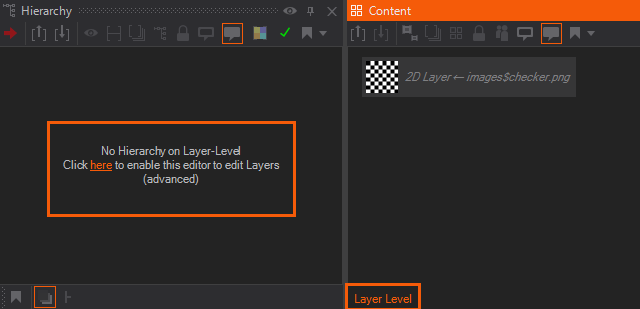

When you select a Layer (just click the Layer), all your editing will be on the Layer Level. This will be indicated inside the Hierarchy- and Content Editor. You can spot a note inside the Hierarchy Editor and a note at the bottom of the Content Editor:
Layer Level Editing makes it possible to bind content nodes to layers. That gives you the freedom to control the layer properties and exposed properties from inside the layer on a layer level. You can use any content node inside the Content Editor. That makes it possible to have Layer to Layer bindings or control different kind of layers by multiple selections and distribute values across them.
When you select a layer, the Properties Editor will show the exposed default properties. You can gain access to more layer-specific properties by clicking the pencil on the left to the selected layer and then click the Layer Root Node inside the Content Editor. The Screenshot shows, for example, the 2d-Movie Layer with the enabled Layer Editing Mode and the Movie Clip Node which connects to the Movie Layer Root Node. To have full access to all available Movie Clips related properties you would need to click the Movie Clip Node in the Content Editor. The Properties Editor will then show ALL Properties available.

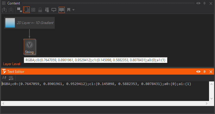

With the Gradient Layer you can create a fullsize gradient background. Click the Gradient Thumbnail to bring up the Gradient Editor window, which is used to create and edit the Gradient used in this Layer. For more information on the Gradient Editor functionality please refer to the Gradient Editor section of the User manual. An advanced usage of the Gradient - Texture Property is to bind it to a string like in the screenshot:
You can now alter the gradient by a string instead of using a Color Picker or using the Gradient Editor. With this solution, you could change the gradient with the animation timeline. You should avoid too many changes in a short range: e.g. don't change the color every frame.

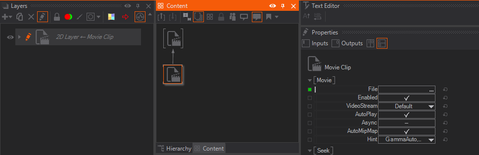

With the Movie Clip Layer you can easily load a movie and have it as full-screen. When using a Movie Clip Layer it will not be affected by the multisampling or antialiasing set in the Ventuz Config. When selecting the Movie Clip Layer the Layer Properties will show you some default properties like Audio, Volume the controls to Loop, Restart, Play, Pause to change the Orientation and to select the File. You can load a movie also by clicking the Layer Thumbnail, both will bring up the Windows File Browser. Additionally, you can choose to load a movie as a reference, this can be enabled by using the "Reference" checkbox in the File / Load dialog:
Also under Control you can find the Control Property which can be bound to a Keyframe Animation node to control the playback in the time-line of the Animation Editor.
To access all properties of the Movie Clip Layer node, use the Layer Edit Mode and select the Movie Clip Node inside the Content Editor Area.
In the lower part of the Properties Editor you can find a custom verb which is called Configure. You can configure Movie Clip related options like the Buffers.

The difference with the standard Gradient Layer is that the Gradient Texture Layer creates a Gradient Texture Node which can be accessed by entering the Layer Edit Mode and selecting the node in the Content Editor. You can edit the Gradient with the Color Gradient Editor.
By using a Convert To Text Node you can also dynamically build your own gradient to which you can bind the Gradient Property. The markup for the Expression is as follows: RGBA;c{0}:({1}, {2}, {3});c{4}:({5}, {6}, {7});a{8}:({9});a{10}({11}) This defines a Gradient with two keys for each, color and alpha. The range of all variables is from 0 to 1 The meaning of the different variables is shown in the following table:
