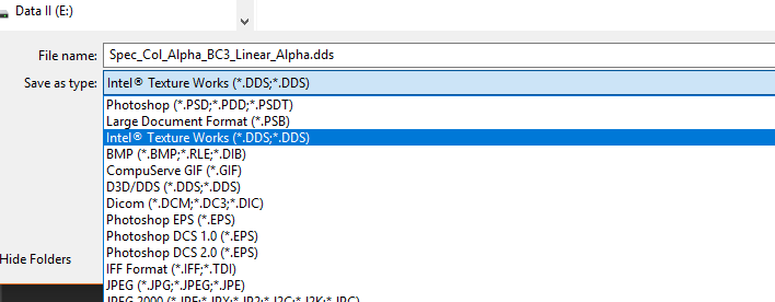

To export DDS files with the latest support of BC Levels, we suggest the Intel Texture Works Plugins for Photoshop, which can be found ​here
Intel Texture Works
After installing the Intel Texture Works Plugin, you can create or convert your textures by choosing the Intel Texture Works DDS Type from the Save as type dropdown:

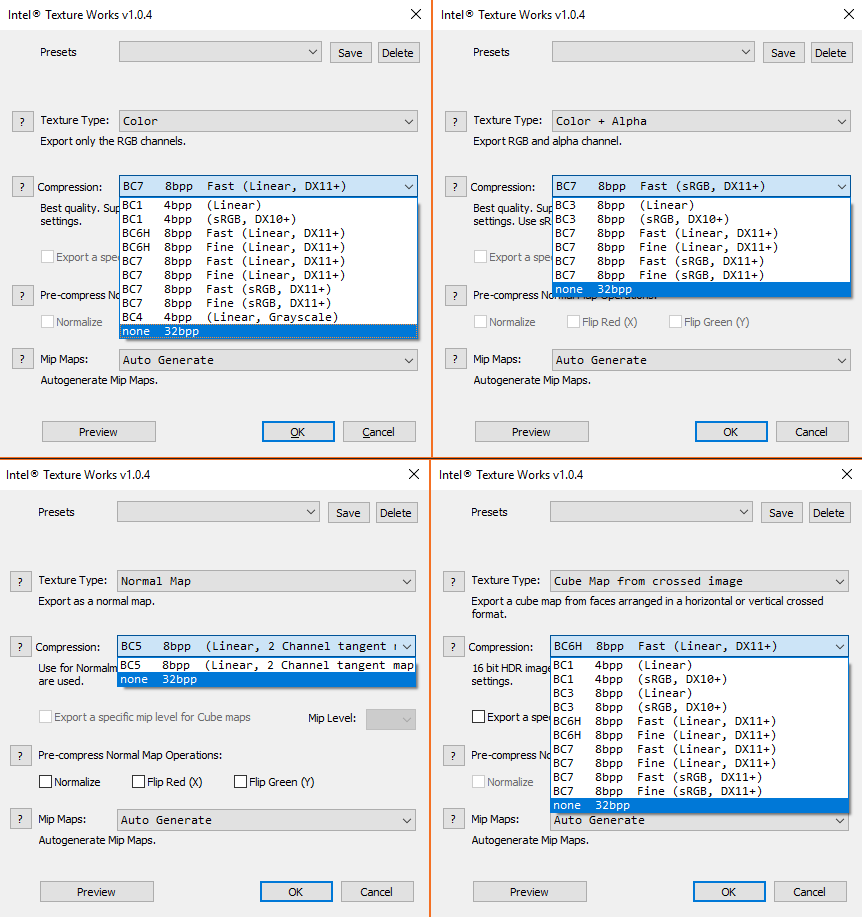

By choosing a filename and clicking the save dialog, another dialog will pop up and ask you for the Texture Type and Compression. See available types and formats;
You can go for any of the available types and compressions. The decision should be made according to the usage of the texture. A simple heightmap should not be saved with BC7 since you will mostly use a grayscale image only. In this case a BC4 linear grayscale would be the perfect match.
On the ​Intel Texture Works Plugin homepage is a very good table with hints about each type of BC and their usage :
BC1 RGB 4BPP aka DXT1 Useful for color maps or normal maps if memory is tight. Contains RGB types of data
BC1 sRGB 4BPP aka DXT1 Same as above with sRGB extended header only on DX10 + level hardware
BC3 RGBA 8BPP aka DXT5 Useful for color maps with full alpha, packing color and mono maps together. Contains RGBA types of data.
BC3 sRGBA 8BPP aka DXT5 Same as above with sRGB extended header only on DX10 + level hardware
BC4 R 4BPP Grayscale Useful for height maps, gloss maps, font atlases or any other grayscale image
BC5 RG 8BPP aka 3Dc Useful for tangent space normal maps. A two Channel Tangent Map
BC6H RGB 8BPP Fast Compression Useful for HDR 16 images only on DX11+ level hardware
BC6H RGB 8BPP Fine Compression Same as above with longer optimized compression time for a finer result
BC7 RGBA 8BPP Fast Compression Useful for high quality color maps, color maps with full alpha. It provides the best quality compression only on DX11+ level hardware
BC7 RGBA 8BPP Fine Compression Same as above with longer optimized compression time for a finer result
BC7 sRGBA 8BPP Fast Compression Same as BC7 Fast above with sRGB extended header only on DX10 + level hardware
BC7 sRGBA 8BPP Fine Compression Same as BC7 Fine above with sRGB extended header only on DX10 + level hardware
None RGBA 32BPP Uncompressed
