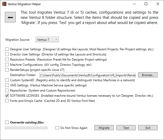

Migration Options
Most of these options are self explanitory, we will briefly go over each of them here.
Please note that these import settings are machine specific. Importing the following settings will only modify the settings on the computer that the Migration Helper is running.
Resolution Presets, Director & Designer User Settings
These top three options will import User Interface (UI) settings such as layouts, shortcuts, resolution presets and per-project settings.
Machine Configurations
This option will import the Machine AV Configuration including input and output mapping, remoting protocols, Director topology, touch settings, machine name ID, group ID, etc.
This import method is machine specific. Selecting this option will only modify the settings on the computer that the Migration Helper is running.

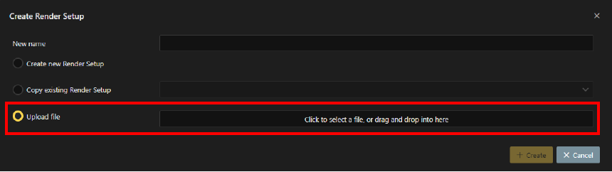

Render Setups
This option will import the Render settings from Version 6 to Version 7.
As mentioned above, one of the major changes in Ventuz Version 7 is the way Render Setups are handled. Render Setups are now associated with a project. This means that you can have multiple Render Setups that are unique to each Project.
When using this option, you can select a location to save the Render Setups on your computer. The default location is C:\Users\Public\Documents\Ventuz7\Configuration\V6_Imports\RenderSetups.
After they are imported, they will need to be associated with each Project where they are needed.
To Import an existing Render Setup file,  Click on "New...", in the pop-up select "Import Render Setup" and navigate to the location the desired Render Setup file is stored.

This option is selected by default.
All existing Software Licenses are imported from Version 6 to Version 7.
Not every Version 6 license supports Version 7. Please contact your sales representative for more details.
Fonts and Emojis
This option will import all cached 2D and 3D font and emoji files.
Select this to prevent Version 7 from needing to create the cache files again.
Migrate and Test
Migrate
This button will execute the migration.
All files will be copied from the Version 6 folders to the Version 7 folders. With the "Overwrite existing files" option disabled, any files that already exist will be skipped, and a notice will be displayed inside of the text file that is displayed after the copy is done.
Test
This button will only display the files and folders that will be copied when the "Migrate" button is pushed - NO COPY HAPPENS in using this option and is not destructive when used. Use this option to review the settings that will be copied when the "Migrate" button is pushed.
