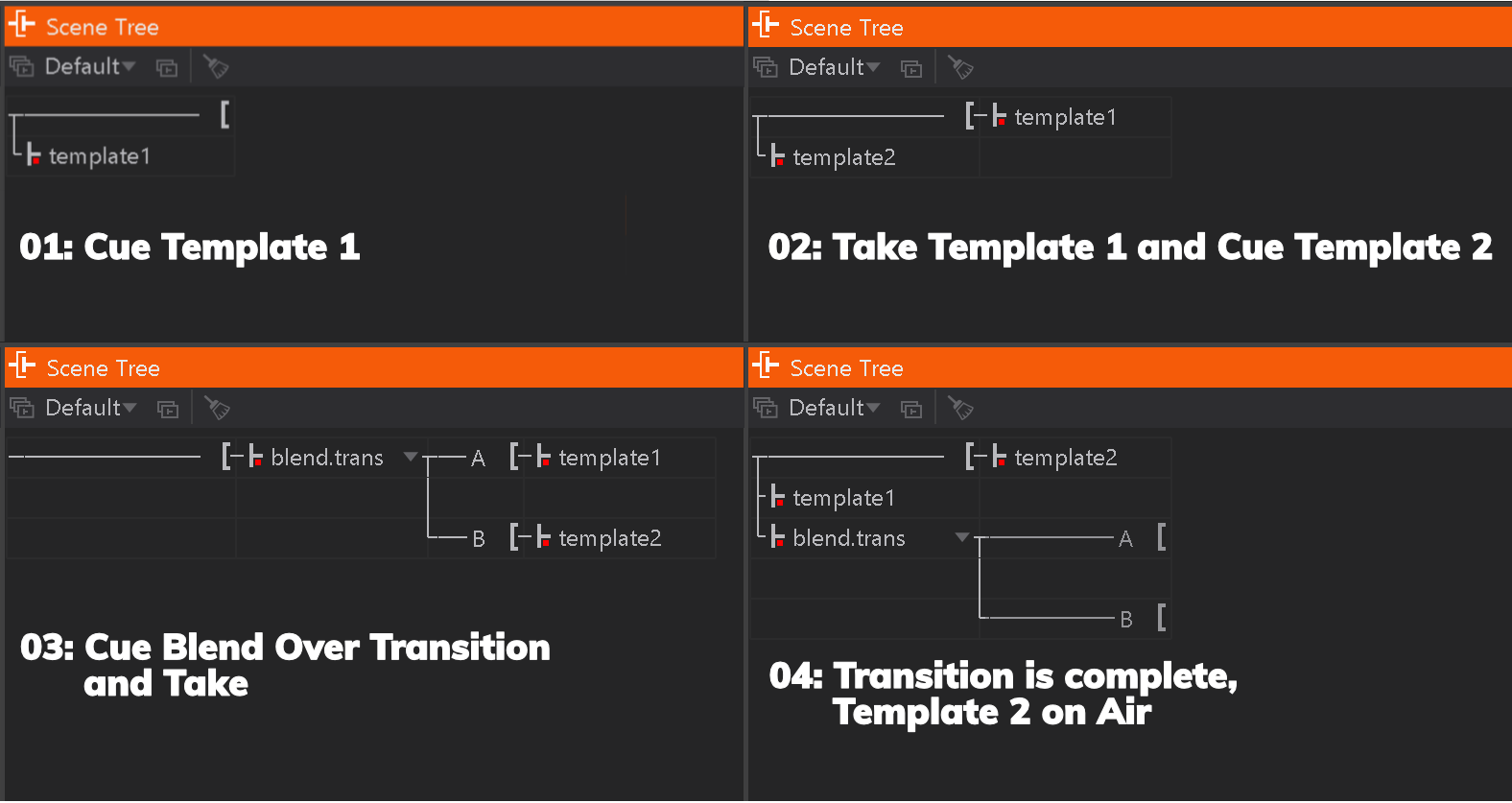

This graphics shows the process of a cue and take with a Transition in the Scene Tree window, with an break-down below:
  • 01: Standard Cue of template 1.
  • 02: Take template 1 and Cue template 2 (so far, this is the normal process).
  • 03: Now the Blend Over Transition is added to the cued template 2. The blend.trans Scene is placed in the Layout Scenes (Program & Preview) and holds the on-air template 1 and the cued template 2. Since the Transition blends between both Templates, it must hold the on-air Template as well as the new one. Please keep in mind, that this process is happening when the Transition is cued. So two performance heavy Scenes can have impact on the rendered Program Pipe's output.
  • Take: during the Take the template and transition animations are running.
  • 04: After the Take is done and the Transition's animation is done, the blend.trans Transition Scene is removed from the Layout Scene's port and only template 2 is on air.

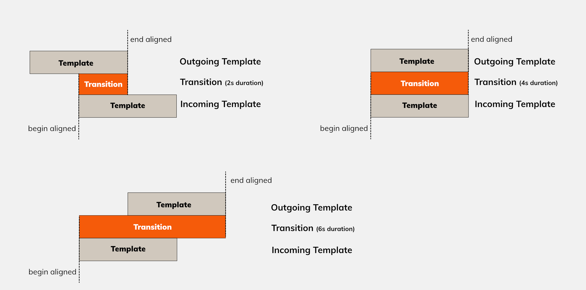

The timing of Templates together with the Transition is shown below:
Depending on the length of the Template animation, the Transition will align relatively different.

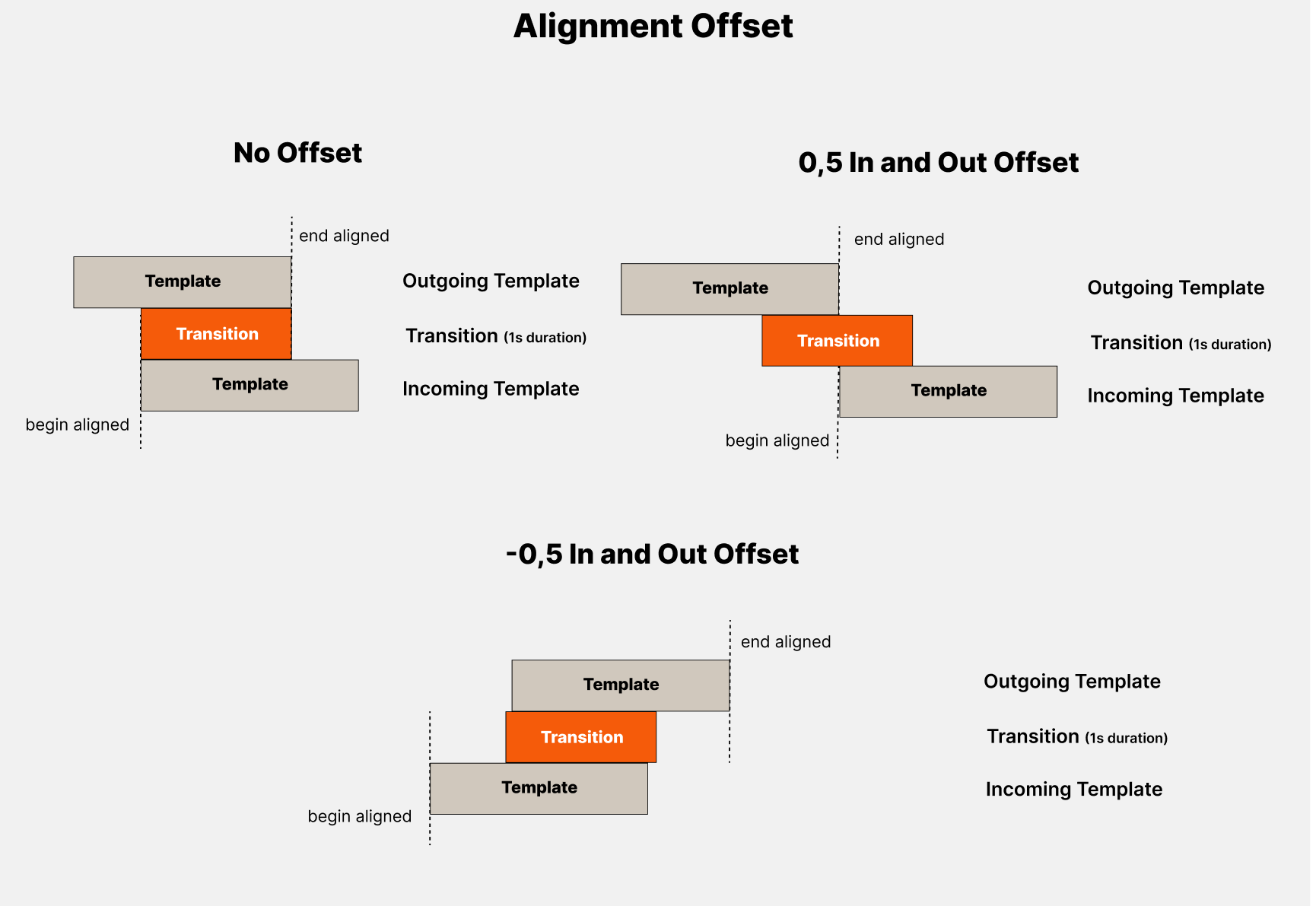

Alignment Offset
With the alignment offset it is possible to shift the timing of where the transition is coming in. A positive value will always move templates towards the center of the transition, while negative values will shift them in the opposite direction. In both cases the Alignment will determine from which position the timing will be shifted. The value set inside the Property Editor is in percentage. So for example as shown in the picture below, a positive offset of 0.5 will add a 50% timing offset. Which would be half a second in this case. Because the transition has a duration of one second.
Alignment Offsets are relative to the duration of the Transition Animation!
