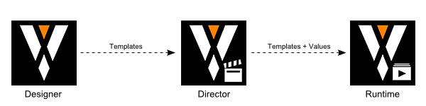

The Director is a control application that cannot create any 3D output by itself. Instead, it manages one or multiple Ventuz Presentation Runtimes and instructs them what to do. The Presentation Runtime interprets those commands and loads the required Ventuz scenes. Moreover it assets, plays animations and does the steps necessary to produce the proper 3D output. Therefore setting up the Ventuz environment and machine communication is of great importance.

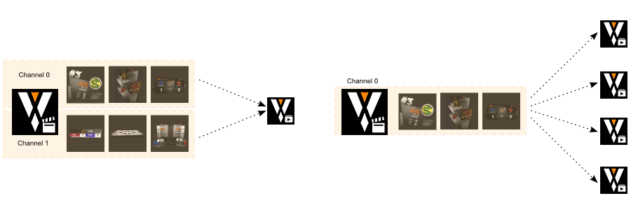

The Director’s concept is built around the idea to work with separate channels; separate feeds of content. Much like an audio application can have separate channels (tracks) for vocals, guitars and drums, which mixed together produces a single song, the Director can provide multiple channels to manage separate content within a single show. A channel allows multiple machines to connect to the same stream of templates and/or to have multiple layers of content on the same machine. For example, a single operator may drive the content of a game show on a big screen wall in one channel, while also controlling other displays for the audience with a completely different feed in another channel.
A typical Director show consists of a single channel. This is sufficient for the majority of applications and the reason why most of this documentation won't explicitly refer to multiple channels. All concepts of Director that are introduced in the following chapters extend to working with multiple channels and it is therefore left to the later chapters such as Topology or Channel Configuration to discuss the more advanced scenarios.

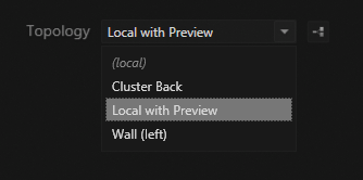

Which machines are actually attached to a channel is specified in the active Topology. A topology can be created, modified and saved via the Topology Editor which is usually done by the IT department managing the machines way before any show is run on a given setup. The Ventuz Director operator simply selects the correct topology from the empty workbench and launches his show.
In addition to the topologies stored in the local machine's configuration folder, the list of available topologies always contains a simply default topology for the local machine called (local). This configuration is ideal for new users that want to learn Director, working with remote machines is discussed in a dedicated chapter.

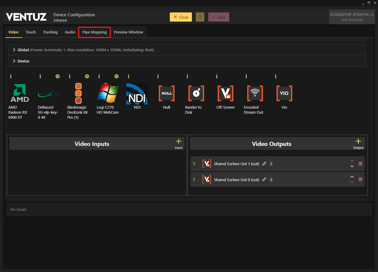

Each channel connects to two so-called pipes provided by the Ventuz Runtime: Program and Preview. Each pipe has an independent output and a template engine that controls the content shown on that pipe. Both can be configured inside the Device Configuration on the Pipe Mapping section. But usually pipe mapping in Ventuz is only needed if you are mixing different devices or different types of outputs, because by default the Director will open all pipes needed for your configuration. The Program Pipe usually shows the final result the audience will see. The Preview Pipe is used to provide visual feedback to the operator while he is editing a template.
Renderer Windows
In the default configuration, the Director layout includes two renderer windows. One for the program pipe (pipe 1) and one for the preview pipe (pipe 2). They are either manually configured as Shared Surface in the Device Configuration or auto connect to a GPU output. When previewing an HDR project on a SDR screen, Preview with Tone Mapping enables tone mapping in the preview window.
