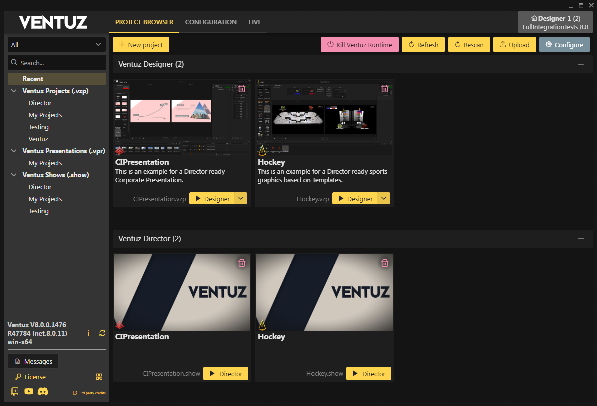

The Project Browser shows the used Designer Projects (.vzp), Director Shows (.show) and Runtime Presentations (.vpr). On the left side you can either see the recently used files or browse projects, shows, presentations based on their categories. Every displayed file type allows to be started with the associated application. This can be done clicking the button in the lower right corner of the displayed tiles. Presentations (.vpr) can only be started with the Ventuz Runtime, Director Shows (.show) can only be started with the Ventuz Director whereas Designer Projects (.vzp) can started with the Ventuz Designer or Director because Director Shows are always initially created based on Designer Projects. Clicking on a tile in the browser gives provides you further information for the associated file.
On top of the browser page you will find a row of buttons to perform certain actions:
| New project | Provides a dialog to configure and create a new Designer Project |
| Kill Ventuz Runtime | Allows to stop running Designer and Runtime (this button is only visible if either Designer or Runtime is running) |
| Refresh | Reloads the browser content. This can also be achieved by pressing F5 key. |
| Rescan | Starts s project scan in the configured VMS search paths and updates the browser content if new projects have been found. |
| Upload | Allows to upload VPR files to a remote machine where Ventuz is installed. |
| Configuration | Configure the project search paths for the VMS project scanner. |

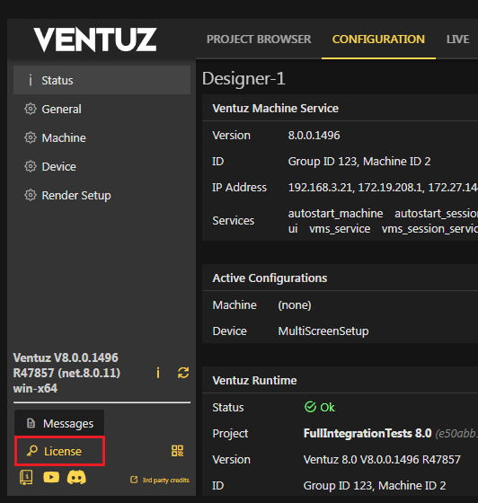

The Configuration page consists of the following sections:
Status: Here you can the basic information about the Ventuz Machine Service (running), the selected configurations and the (running) Runtime. At the bottom of this page you have the possibility to download log files for the different Ventuz applications.
Generall: Set the Name, numeric ID and Group values and Tag string here to identify this Ventuz machine in a network and assign it to a Ventuz Cluster if necessary.
Machine: Select or create new Machine Configurations here.
Device: Select or create new Device Configurations here.
Render Setup: Select or create a new Render Setup for an existing project or presentation here. It's also possible to start any of the listed projects and presentations.

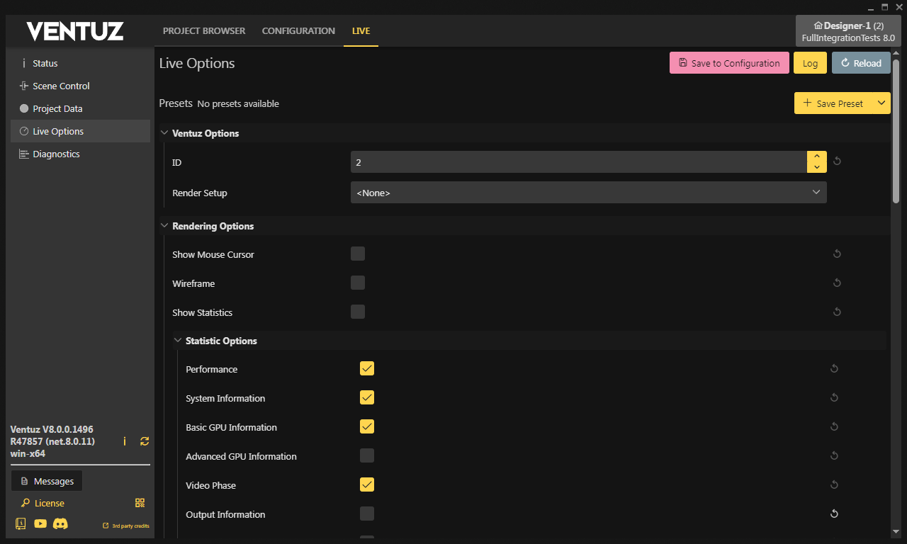

The Live page consists of the following sections:
Scene Control: This page gives you the possibility to to load scenes from the active project to the ScenePorts of the active LayoutScene.
Project Data: Here you can modify the Project Data of the active project and create presets from these data sets.
Live Options: This section allows to enable and modify certain parameters that can be changed during Ventuz Runtime is running without the need of changing the Machine Configuration or Device Configuration. These are e.g. the Statistics or some Rendering options. For a full description to Live Options.
Diagnostics: Here you can see the Performance Statistics as they are usually displayed on the render output. This comes handy if you do not have visual access to the render output.

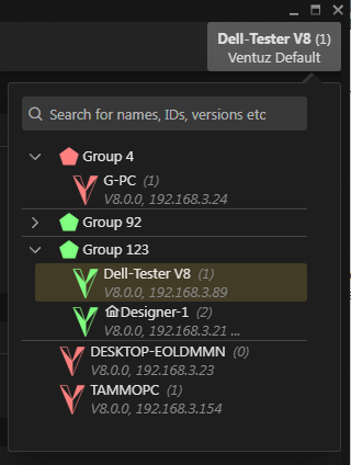

The Machine Selector shows all machines discovered within the network. All these machines can be configured from your local or web Configuration Editor. The Ventuz Machine Service broadcasts its VMS signature periodically. The Machine Selector receives these messages and add the entries to the selector. Machines without VMS running can't be discovered and configured!
The entry with the House Icon on the left marks the local machine. The local machine is the default selection when the Ventuz Configuration Editor is started.
The selector automatically groups all machines with the same GroupID. To select a group click on the group label (here Group 2).
With the Search Bar it is possible to search in the available machines via the name, the ID or the Ventuz version and list the machines accordingly.
Each entry has a colored Ventuz icon. The color indicates the current state of the running Ventuz process on that particular machine:

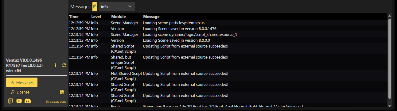

By pressing the Log button in the Live Options the current status of all streams (audio & video) is logged in the message window.
This information is only visible if the message level is set to info or debug. The message level can be set using the dropdown menu.
Changing an output stream for example or setting a new resolution will be written to the Messages.
For a GPU output the resolution and refresh rate will be printed, the input streams and other devices are written to the Messages log as well. With a running system this good way to get an overview of the configured devices.
More critical events are logged as Warning or Error.

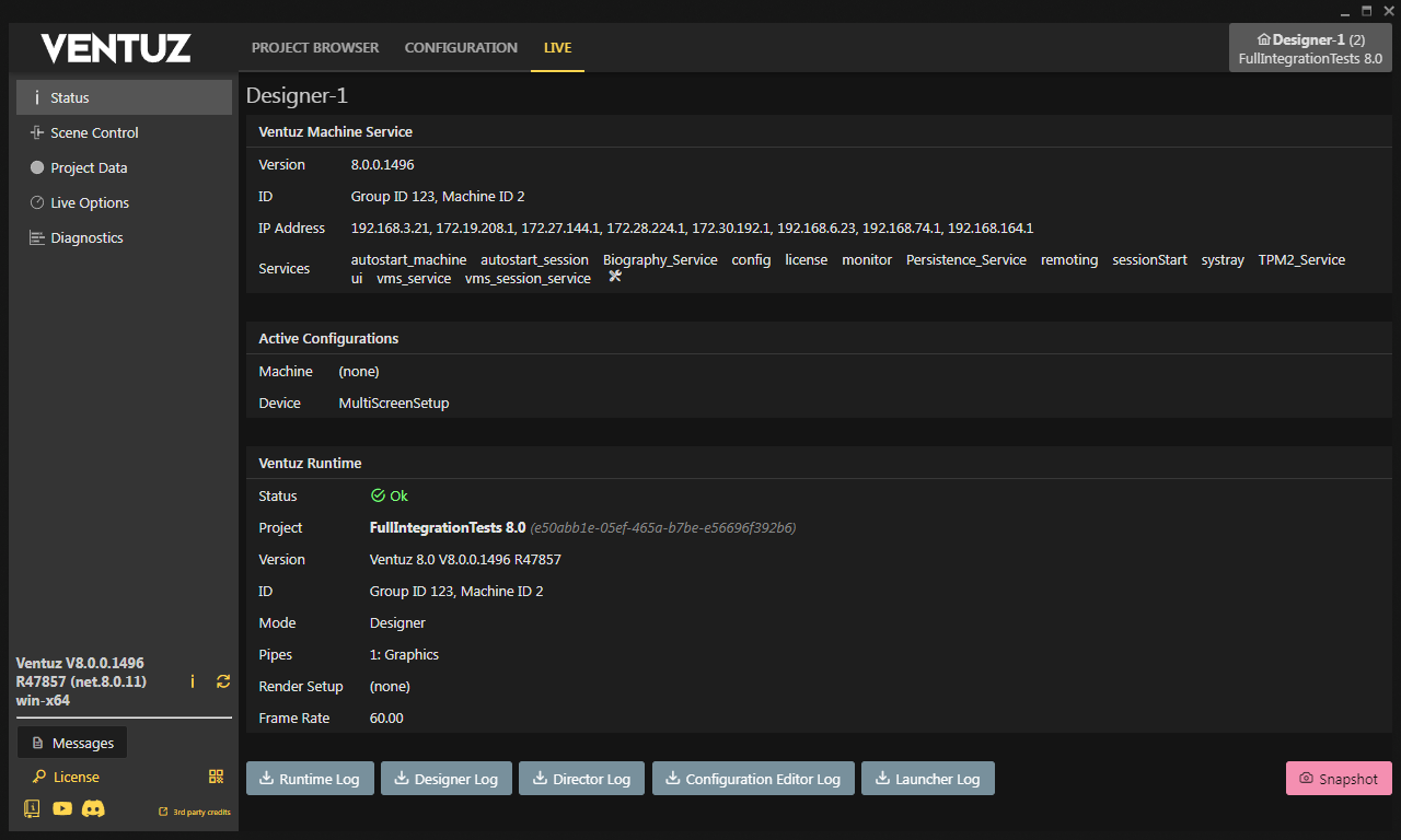

The Status page from the Configuration or Live tab gives you detailed information about the current state of your selected machine(s).
This includes:
For more information on the different states that the VMS can be in, take a look at the VMS Documentation.
With the Snapshot button in the bottom right corner, a snapshot of the current Ventuz Runtime rendering will be displayed and is also downloadable.
If a Group is selected in the Machine Selection tab, this window will display the information overview of each machine in parallel.
The Logs Quick access provides all the different application Logs. By pressing the Log button you can download the log file. They are also saved in the Ventuz configurations folder next to the Configuration Files on your harddrive.
With this you are able to monitor the logs with your tablet, smartphone or PC / laptop in your local network. Without the need of installing Ventuz on it.

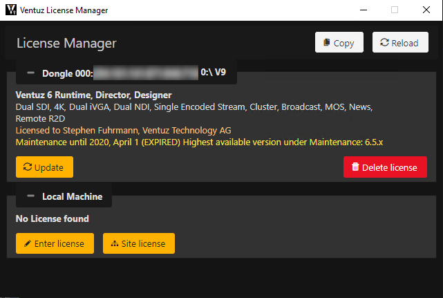

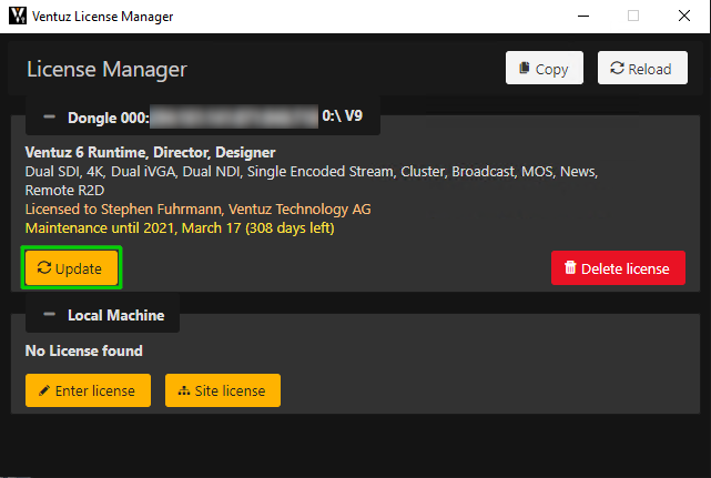

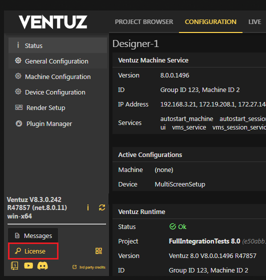

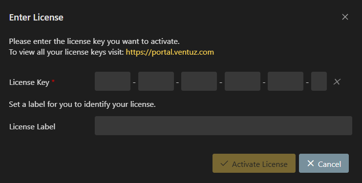

In the License section the system Ventuz license can be added, updated or unregistered.
This License Manager in the Configuration Editor has the some functionality as the standalone application installed with Ventuz.
With the Copy button all license information are copied to the clipboard.
Sometimes it might be necessary to press Update to reach out to the Ventuz License server to verificate your license after a change.

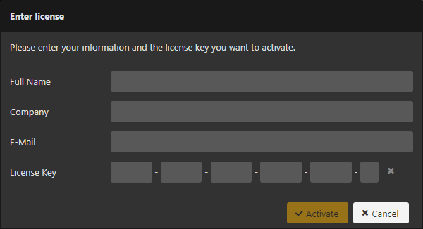

When you are running your license for the first time or if your dongle does not contain any license keys, you must click on Enter License, and a new screen will appear (see below). The same goes with system and TPM licenses. Please enter the license key information listed on your license certificate in this form. Optionally, you can also enter a custom license label for your internal license management.
If you try to run Ventuz Designer, Director or Runtime and are presented with the Ventuz License Manager with red text in the license panel this is an indication that your Maintenance period has expired and the version of Ventuz that you have installed is too new. In such a case please contact your Ventuz reseller or sales@ventuz.com. Highest available version under Maintenance indicates which is the most recent version of Ventuz that will run with your current license. You can download older versions here: https://www.ventuz.com/resources/downloads/

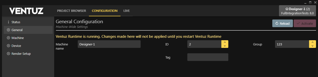

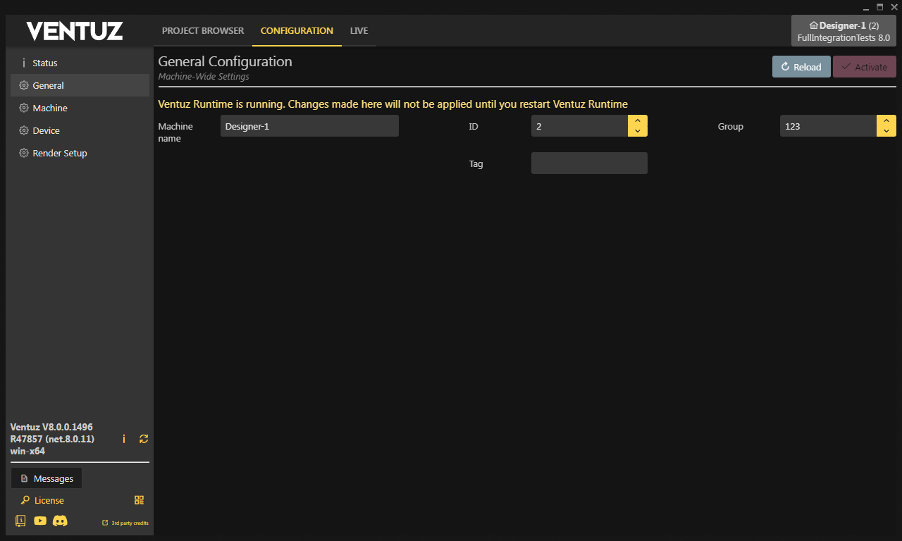

The General configuration tab contains information about the Ventuz Machine.
It defines the Machine Name of the machine as well its numeric ID and GroupID.
The ID determines which machine will be Master and which Client(s) in a Machine Cluster. The lowest ID will be set as Cluster Clock Master. The ID is also used to select the correct part to be rendered in the multi-machine Render Setup. With the Live Options, the ID can be changed while the runtime is active.
The GroupID must be set to a value greater than zero if a machine is part of a Cluster (group). Only machines with a GroupID can interchange their timing (cluster clock) to synchronize Remoting, animation and movie playback. For proper synchronization a valid Cluster Option is required.
The Tag is used by the Runtime to determine the Layout Scene that is to be used.

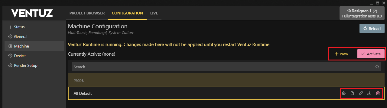

The Machine Configuration and Device Configuration files are selectable and editable in the Configuration Editor.
New creates a new configuration file. It is possible to upload a file from the hard-disk, also a duplication of an existing configuration file can be done in the creation dialog. With Activate the selected configuration is activated and will be applied, also while the runtime is running.
With pressing the Cogwheel Icon the selected configuration will be opened in the editor. If you want to edit the configuration directly without the interface, you can edit the JSON file via the UI, by pressing the Paper Icon. With the Pencil Icon an existing, not activated, configuration can be renamed. With the next button the configuration file is saved to hard-disk. The Red Bin Icon deletes the configuration.
All Ventuz configuration files are stored in the system's public documents folder in the Ventuz8\Configuration directory. On most systems this path is:
C:\Users\Public\Documents\Ventuz8\Configuration\
Except the Render Setup files are stored within the Content\Project\RenderSetups folder structure within the Project.
If you upload your configuration file to a remote machine with creating a new configuration it will be saved at the remote machine locally in the same folder structure.

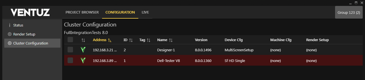

If a Group / Cluster is selected the General Configuration section shows an overview of the machines configuration.
It is possible to see the activated configurations and Render Setups for each machine and the VMS status for each machine. The machines can be sorted by each category. With the arrow at the end of each machine line, the Configuration Editor will switch to this machine for editing configurations.
The red marked bar indicates that status or the configurations of both machines is not according to each other. In this case the runtime of the first machine is not running.
