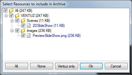

In order to export a Ventuz Presentation, open the main scene in the Ventuz Designer. After a final review of the scene in the Runtime Layout, select Scene/Export/Ventuz Presentation (vpr) from the main menu. A resource selection window will request which resources should be included in the VPR file. In most cases, the automatic resource selection does not have to be modified and can simply be confirmed by pressing Ok.
This dialog shows all resources used in the exported scene including resources of sub-scenes. If any additional resources are required which are not automatically selected use the Resource Linker Node to add them to your scene.

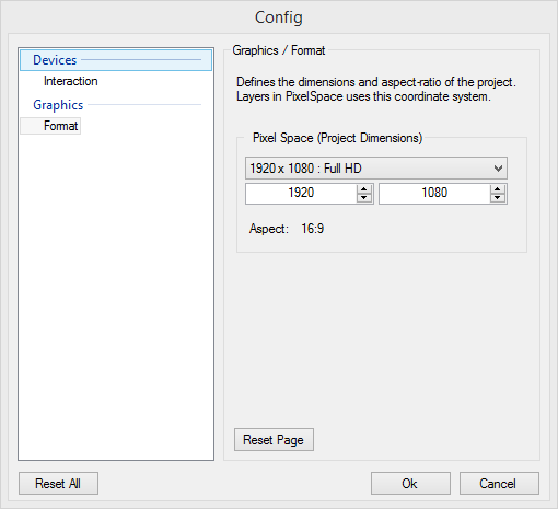

In some cases it might be necessary to change the Project Properties that have been used for the VPR export without re-exporting the whole presentation. This might be necessary for example if the aspect ratio of the display changes. To perform a settings override, click  on the .vpr file and then click  Configure. This brings up the Project Properties editor in a reduced version.
Make the necessary changes and click the OK button. A .config file with the name of the according presentation file will be saved next to the .vpr file containing the modified settings. Every time a VPR is started the Presenter will look for an according .config file. If one is found, the containing override settings will be used; otherwise the original settings which have been saved in the VPR during export are used.

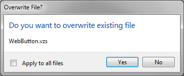

In order to import a VZA archive into an existing Ventuz Project, open the project and select Scene/Open in the main menu to open up the Open Dialog. Search for the VZA and open it. The following Resource Selection dialog will ask which resources should be imported into the project. If a resource already exists, the user is asked whether to overwrite or keep the file.
