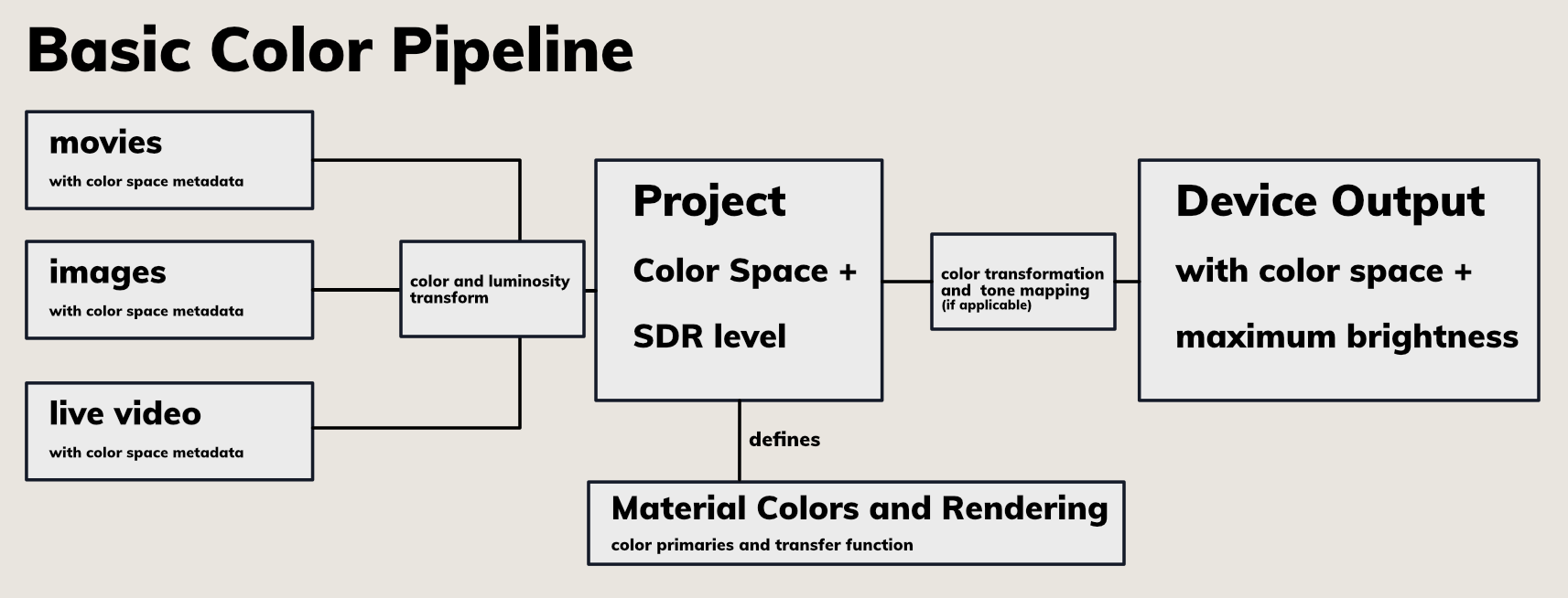

With color processing for the whole rendering pipe, Ventuz ensures that an incoming video in a specific color space renders color-accurately on the output, where the rendering color space is independent of the output device's color space.
Ventuz auto-detects the color space and other meta-data for all incoming and outgoing video streams and applies the correct color transforms in real-time, to ensure a workflow with minimal additional configuration. In general, all incoming video will be converted to the Project's Color Space. On the device output, the video stream is color transformed again to match the output device independently per Output. For specific use-cases, all of these transforms can be manually adjusted.

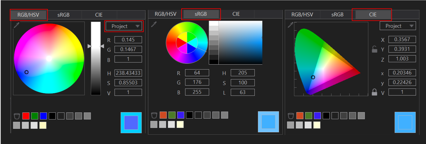

With linear color space, the Color Selector in Ventuz with different tabs and settings. The main tabs are RGB/HSV, sRGB and CIE. RGB/HSV uses a Hue and Saturation circle in combination with a Value (brightness) slider. The color shade is separated from the brightness level. The values can be set via RGB or HSV float numbers directly. This is the default tab to work in linear spaces. With the dropdown selector the color space of the Color Selector can be changed. This is a very useful feature when working in a wide space, like Rec.2020, while not exceeding the gamut of a more confined color space. E.g. if you plan to play out on a Display that supports a P3 color space, you can select this space and stay within these boundaries. The selected color value will be transformed to the Project Color Space value internally. So the RGB or HSV float values on this tab will automatically refer to the dropdown menu's selected color space. Internally all of the values will be processed in the engine's color space and also displayed in these values on a color property.
The sRGB tab functions as legacy color selector, which only uses sRGB values. Use this one to enter known sRGB int values or select a color on the picker as before. If the currently selected color value from another tab exceeds the sRGB gamut, a warning will be shown in the color picker window.
The CIE tab displays the CIE 1931 xyV/XYZ color space and value boxes. It also displays the currently selected color space gamut within CIE as highlighted rectangle. If the selected color is outside the selected color space, a warning is displayed. It is very useful, to check wether a specific color is inside a gamut and also for a better understanding of the color spaces. The xyY or XYZ values are also converted to the Project Color Space values.

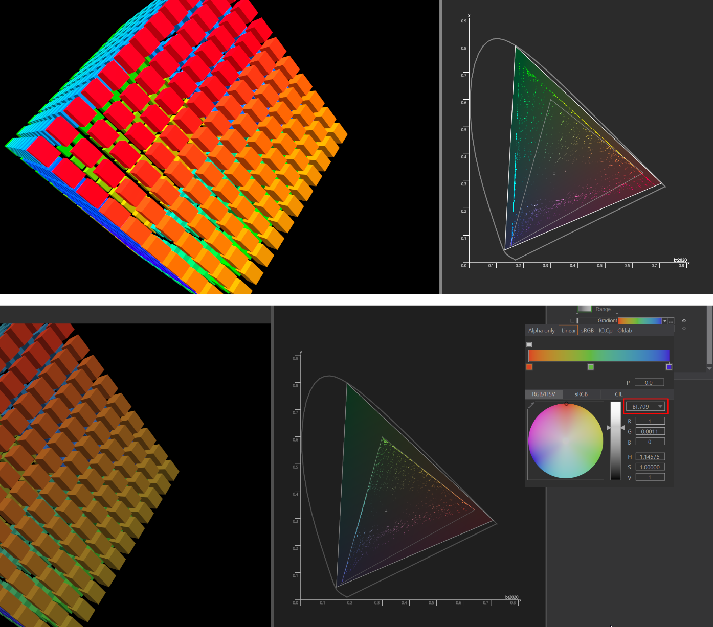

First activate the video scope with this button and select the CIE Chromaticity scope with the dropdown menu, for the CIE Auxiliary Gamut select Rec.709:
In this example we have a rendering which vastly exceed the gamut of Rec.709 (upper image). The Auxiliary Gamut shows the boundaries of Rec.709.
Now we limit the colors, by setting the Color Selector manually to BT.709 (red rectangle). A value of (1.0 : 0 : 0) will be converted to the project color space and it is easy to stay within the limits. meta I have a movie clip and want to check if its within Rec.709 levels

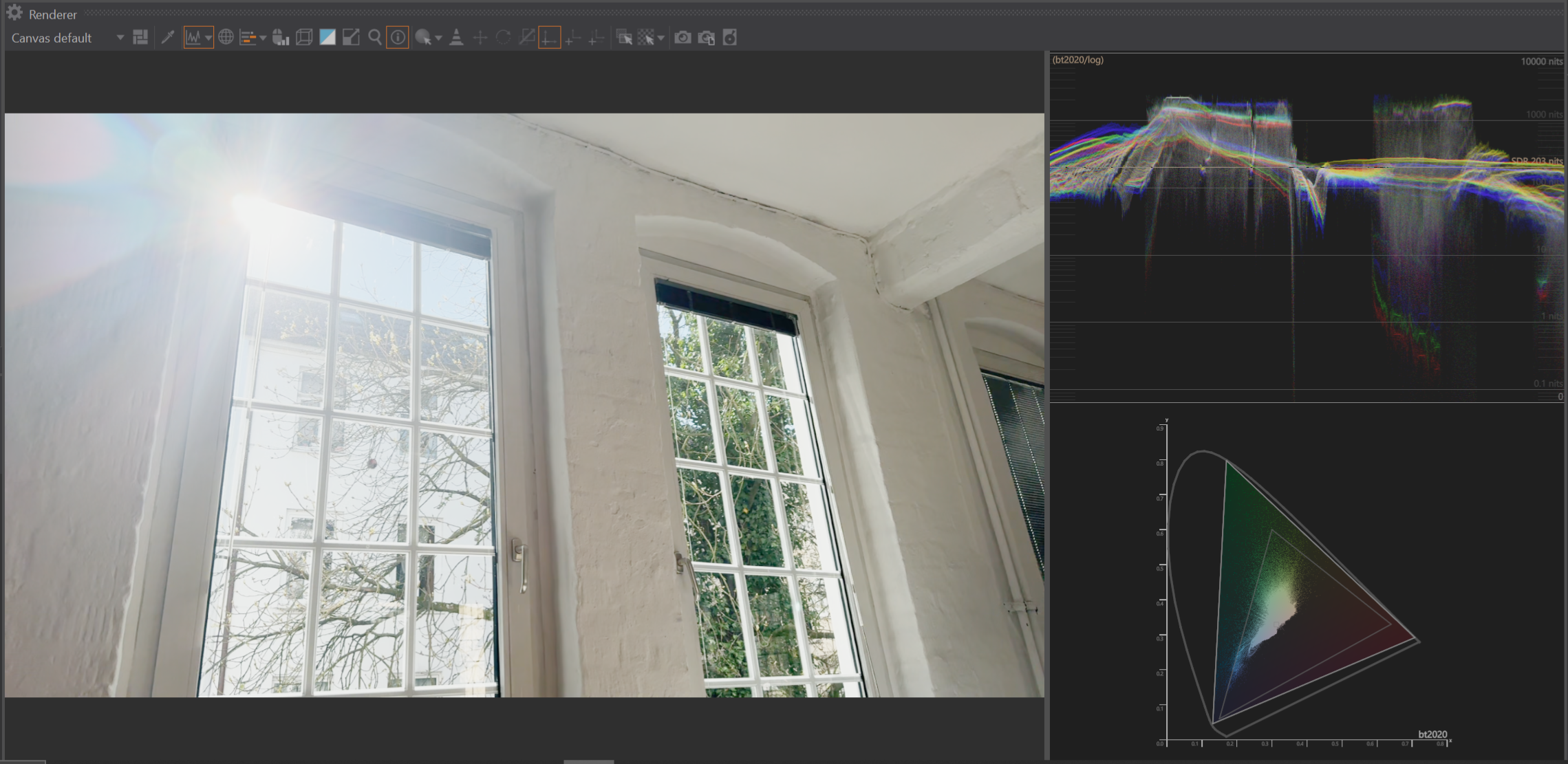

The following screenshot is from a bright scene in a SDR video:
It is clear to see, that the video level stays under the SDR Level in the histogram view (right, up). Also the color values stay within the Rec.709 gamut, which is drawn as Auxiliary Gamut. On a SDR output, this would be played out unchanged and exactly as on the screen.

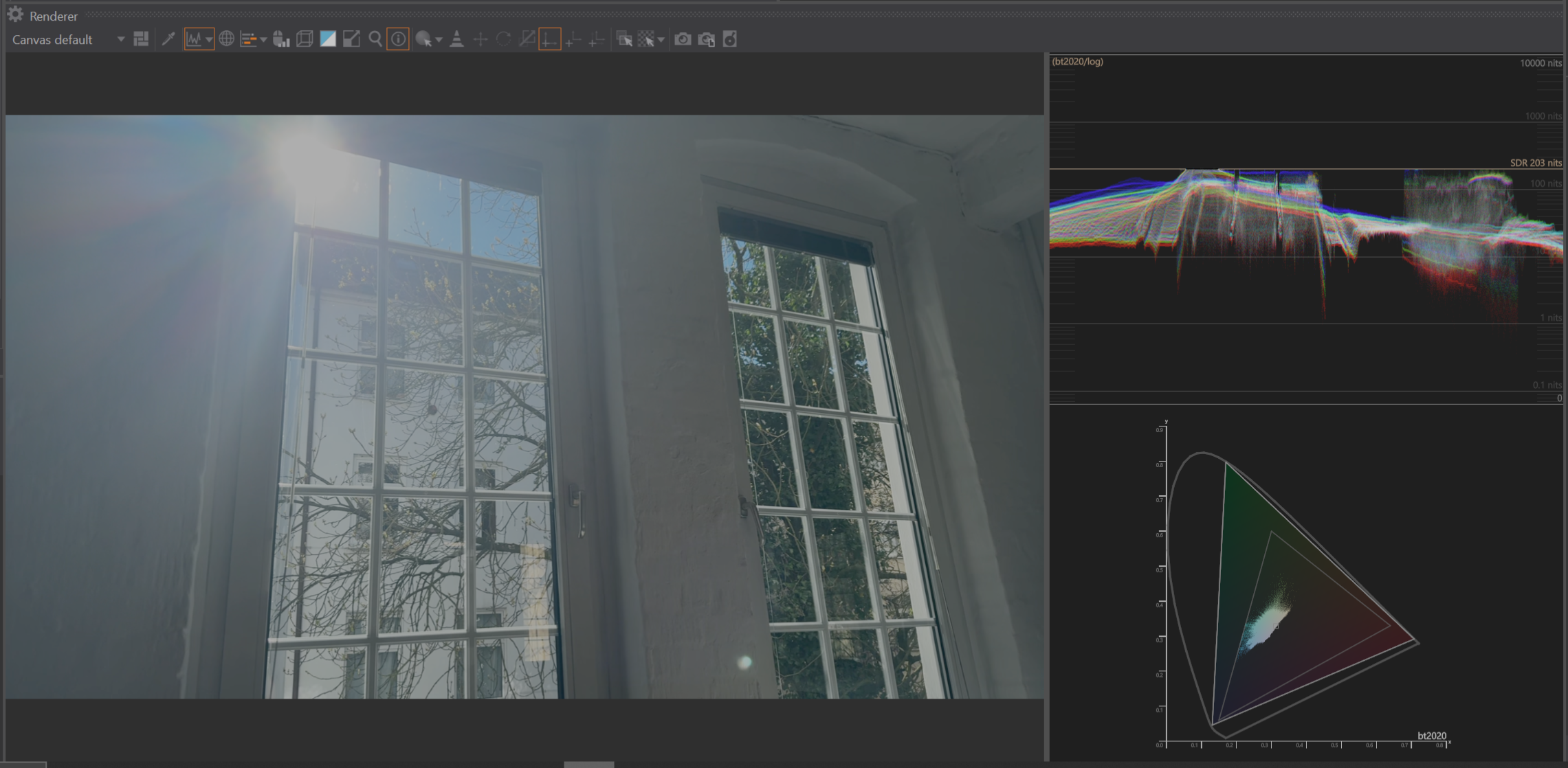

The second video uses a HDR range. The histogram shows many color value above the SDR level. It also include color values which are outside the bounds of Rec.709.
