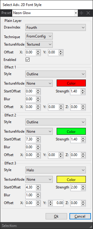

The style can also be modified via the Adv. 2D Font Style dialog when you click Edit... in the Style property dropdown:

Text 2D supports a plain layer and up to 3 effect layers. Each layer can be positioned with the XOffset and YOffset property. Effect layers also have a ZOffset property. This can be used for drop shadows.
By default, the plain layer is on top, followed by the three effect layers in that order. With the DrawIndex property the plain layer can be positioned between the effect layers.

The color of the plain layer is taken from Material or Color nodes in the hierarchy. The colors of effect layers can be set directly in the style

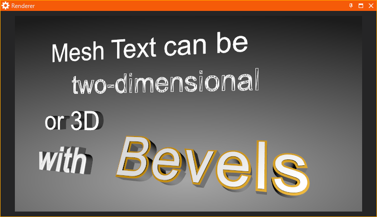

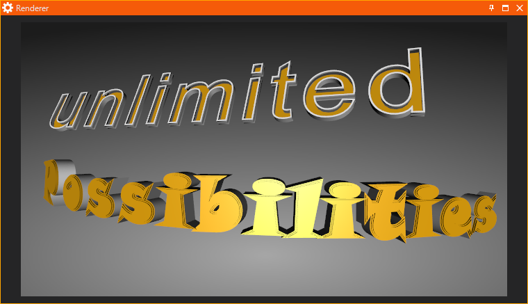

Text 3D is a Hierarchy Node and is used to render two- and three-dimensional text. The characters displayed by this node are actual geometry consisting of triangles that form the shape of the character.
Like any other geometry, Text 3D can be used in combination with textures and shaders, regardless of the text being 2D or 3D. Bevels can be added to extruded mesh text to either soften the corners of the text or to create new designs. The individual parts of an extruded and beveled mesh font, such as front and back face, the extruded hull and the bevel itself can be individually controlled and combined in order to create custom styles and designs.

Quality defines the number of vertices used to visualize the rounding of a glyph. Medium quality creates enough vertices for most regular applications. Low quality offers only a very low resolution and should only be used for very small texts. High quality offers very smooth rounding and can be used for most applications. The Very High quality setting renders extremely high resolution meshes and can be used even for very close shots. The Very High quality setting requires a lot of memory however and should therefore be used with caution.
Extrusion sets the depth of a mesh font. An extrusion of 0 will result in a plain 2D mesh. A value of 1 corresponds to the extrusion of Mesh Fonts in Ventuz 2006. Only styles with extrusion can be beveled.
If a Font is extruded, the user can choose which part of the mesh is to be displayed. Front and Back are the 2D Faces forming the shape of the mesh, Hull is the actual extrusion. If no face is selected only the Bevel itself is rendered.
Ventuz offers many predefined Bevel shapes. The bevel Size defines the scaling and size of the actual bevel. If both Font and Back bevel are calculated, the bevel size is restricted to half the extrusion in order to avoid corrupted meshes.
The bevel Mode determines whether the bevel is calculated outwards or inwards. Which bevel mode to use greatly depends on the font used and the general design. Outer bevel changes the font weight. The font appears bolder than it really is. The Inner bevel does not change the font weight but might produce glitches in the mesh and slightly overlapping polygons due to inconsistencies in calculation. A small outer bevel is generally the better recommendation as it produces perfect meshes and displays the font only slightly bolder as it actually is.
