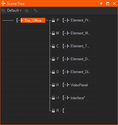

Below you can find a very common scene tree setup. One main scene loads and displays several sub-scenes. The limit exceedance depends on how many nodes each scene has. For the examples we assume a limit of 500 nodes:
  • Case 1 - The_Office and all seven sub-scenes each have 50 nodes: The limit is not exceeded as in sum they have 400 nodes.
  • Case 2 - The_Office and all seven sub-scenes each have 100 nodes: The limit is exceeded as in sum the scenes have 800 nodes, although each scene alone has less than the given limit.

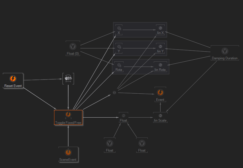

Bindings are visualized as arrows which connect nodes in the Content Editor. To create a binding, select a node, go to the Properties Editor and drag the input property onto another node. When released, Ventuz will open up a list of compatible output properties of that second node. Upon choosing one of the properties, a connection is created and visualized by an arrow going from the output node to the input node. For more information, see Property Editor. When a node is selected its bindings will be highlighted as shown in the picture above.

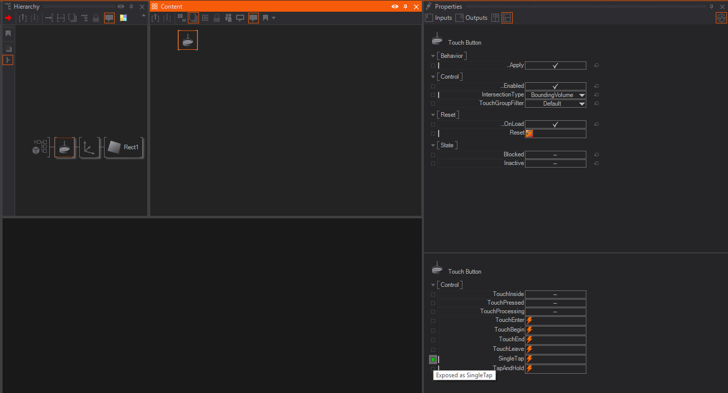

It is possible to have bindings across Layers. Before you can use a property and bind it from one to another layer, or bind the property to the Layer Level content nodes you have to expose the values up to the Layer Level. The following screenshots show a Touch Button which has the TouchPressed exposed from the 3d Layer (User interface) and is bound to the 2D Movie Clip Layer to control the Play.

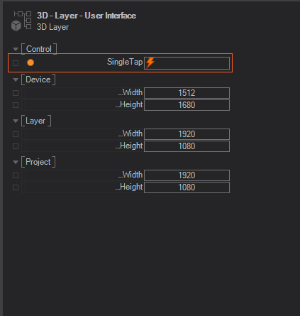

Inside the Layer3D - exposed the SingleTap
Layer Level - The exposed SingleTap is visible and can be bound

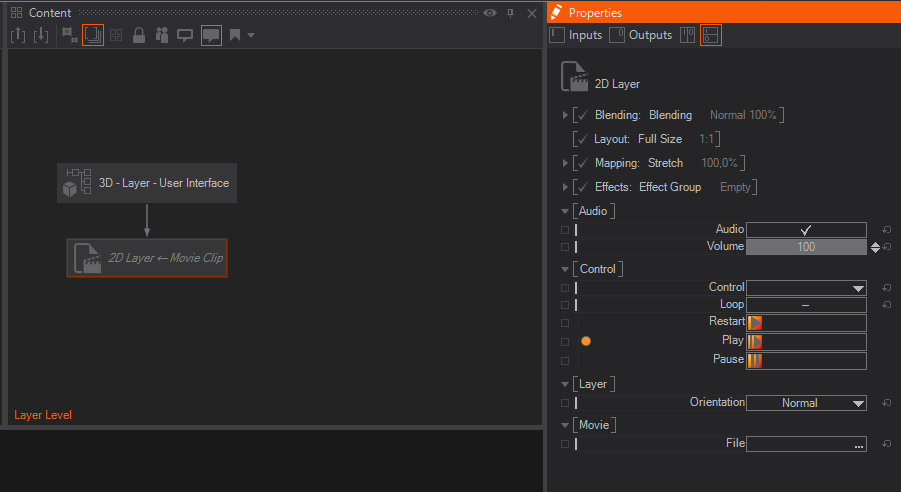

The Play event from the 2D Movie Clip Layer is bound to the SingleTap
