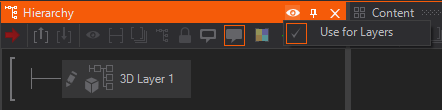

Use the Hierarchy Editor to edit Layers
To save screen space Layers can also be edited from within the Hierarchy Editor. Check the Window Option Use for Layers.
For sure the behavior of the Nodes does not change based on where you edit them but the Editors differ in some ways.
Here is a list of things that are different from editing Layers in the Layer Editor
  • In contrast to the Layer Editor you can apply Annotations to Layers in the Hierarchy Editor that will be hidden in the Layer Editor.
  • does not unfold the Properties of the Layer. To edit the Properties you have to use the common Properties Editor like for any other Hierarchy Node.
  • on a Layer i.e. an Image Layer does not open the Open File Dialog.

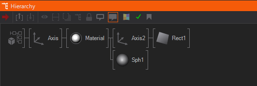

Selection

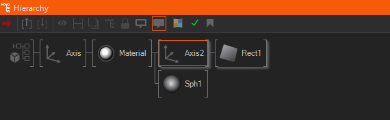

Clicking  on a node selects it, which is represented by an orange box drawn around the node's icon. This simple click  will also add a shadow below the selected icon and all of its children. This visualizes that any operation affecting the current selection such as deletion will also affect the children.
In the example, the Axis2 node has been directly selected but the Rectangle has also been indirectly selected. To select a node without indirectly selecting its children, press and hold CTRL while clicking  on the node.
Instead you can also  click and drag to create a Selection Box and select multiple nodes at once. Without the CTRL-modifier, selecting multiple nodes in the same subtree will select the topmost node only (and the subtree is selected indirectly).
If nodes have already been selected, holding SHIFT will add the new selection to the existing one.

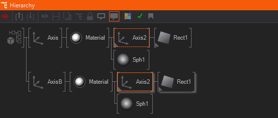

A selection can be moved to a different position in the hierarchy by dragging the selection to its new place. The drop zones as mentioned here still apply.
By pressing CTRL while dragging, the selection will not be moved but a duplicate will be inserted at the new position instead. All content nodes that are bound to the select will be duplicated as well so that a truly independent copy is created. Using CTRL + P inserts a copy of the selection as a sibling to the original nodes.
If CTRL + ALT are held during the drag, a so called reference copy is created, duplicating the Hierarchy Nodes but not the bound content nodes. For example, if an Axis is bound to a Mover, the reference copy will create an additional Axis that is bound to the same Mover. CTRL +  SHIFT +  P does the same and inserts the new nodes as siblings.
If CTRL + SHIFT are pressed, a link (in some programs also called a reference) to the existing nodes will be inserted instead of a duplicate. This is a very powerful but also potentially error-prone and complex feature when working with tree structures. It is powerful in that the same nodes can be used multiple times in a scene although only one copy resides in memory. The problem with multiple linking is that the linked nodes appear at multiple positions in the Hierarchy Editor but the user still has to keep in mind that there is in fact only one instance. Any change done to the one item in the tree will also affect the others because there is only one node. Similarly, deletion of linked nodes can create unintended or unforeseen consequences when linked references are forgotten about. Nodes that have multiple links are designated with a gray triangle in the lower left corner of the node icon, see here.
In the example above, there are two axis nodes but only one material node. The material node has been linked to each of the Axis nodes.

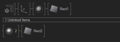

Unlinked Items

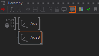

All Hierarchy Nodes shown in the Hierarchy Editor are by default in a linked state. That means a Node is linked to another one, which again is linked to another and so forth until the container's or layers's root has been reached. An Hierarchy Node also can be in an unlinked state if its node is not part of such a link-chain described above. Unlinked nodes are part of the scene (or container) but are not traversed by the Renderer.
To unlink a selected Hierarchy Node, either select the menu entry Edit/Unlink or press SHIFT +  DEL. Unlinked nodes are displayed in a special area at the bottom of the Hierarchy Editor.
To re-link nodes that have been unlinked before, simply drag&drop or copy paste them into the normal, linked area. If no more unlinked nodes are in the container or scene the Unlinked Items area disappears.

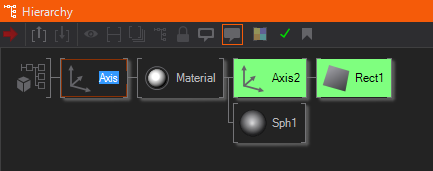

Node Name and Color
Each node can be given an individual name by double-clicking  on the node (or pressing F2). This is a great way to mark certain subtrees, for example as "main menu", "red button", and so on.
As a further functionality to keep an overview in complex scenes, nodes can be assigned a node color by choosing a selection and then selecting a color from the top menu bar or from the context menu (pressing and holding  until the menu appears).
If a color is set at one node, it will be inherited by all its children. In the above example, only the Axis and the Material node have been explicitly assigned a color. Note that only Hierarchy nodes can be colored. The coloring is generally most effective when used sparingly to avoid a colorful chaos in the Hierarchy Editor.

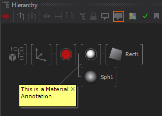

When coloring is not enough, the user can also add a "note" to a node by selecting the node and then choosing Annotation from the top menu or the context menu (pressing and holding the right mouse button until the menu appears). The box can contain any HTML or Markdown formatted text, thus being the ideal place to leave notes (i.e. keyboard shortcuts, ...) to the person that will actually run the show or to a colleague also working on the same scene.
The visibility of annotations can be toggled in the top menu.
For more information about Annotations take a look at this Page
