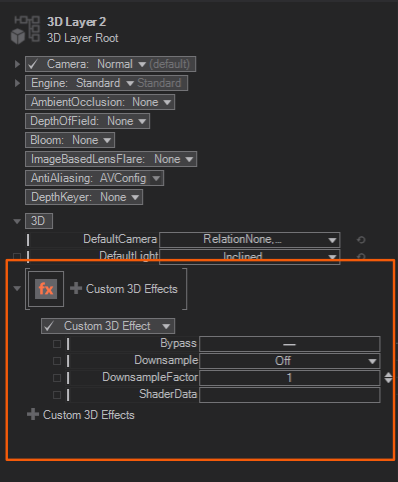

  • 3D StandardThis is a standard 3D Layer
    3D HDR This is a Layer using the High Dynamic Range engine mode
    3D Layers
    3D Layers allow you to access the Ventuz Hierarchy workflow, and thus the Hierarchy Editor in Ventuz.
    3D layers are 3D hierarchies which can be combined with 2D layers and which support the addition of Post Processing Effects, also called IPP Effects. These IPP Effects will affect all the elements inside the 3D Layer as a whole, therefore if you want to apply different effects to different part of your scene, you have to place these elements into separate 3D Layers.
    To access the Ventuz Hierarchy Editor for each 3D Layer, click the Edit Icon of the layer you want to edit. Please refer to the Hierarchy Editor section of this User Guide for further reference.
    Ventuz 3D layers have 2 different render engines or modes:
    • Standard: This is the default render mode used since Ventuz 5 and, as you can see, it is not using vertex-based lighting and therefore is more similar to industry standard 3D applications using other lighting techniques. As with legacy mode, the properties change to match the available features of this render/lighting mode.
    • HDR: The 3D Layer calculates internally with 16-bit float values and is able to calculate with more accuracy. This results in better lighting and fx calculation, but requires more computing power. For in depth-information see here.

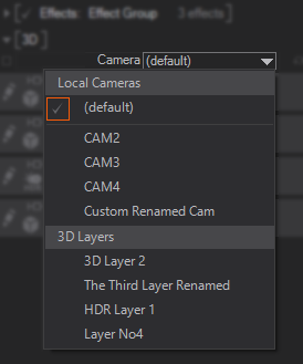

    With this drop-down menu you can assign the actual Camera. The options are Local Camera default and all other Cameras available in the actual Selected Layer, if available, other 3D Layers cameras will be listed here - Right under 3D Layers as shown on the screenshot. It is a very powerful feature of Ventuz to use an existing camera from another 3D layer as the actual camera for the selected layer. Whenever you control, change the position or orientation of the assigned camera, the changes will be applied to the 3d layer, where you assigned the camera to.

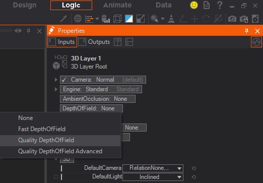

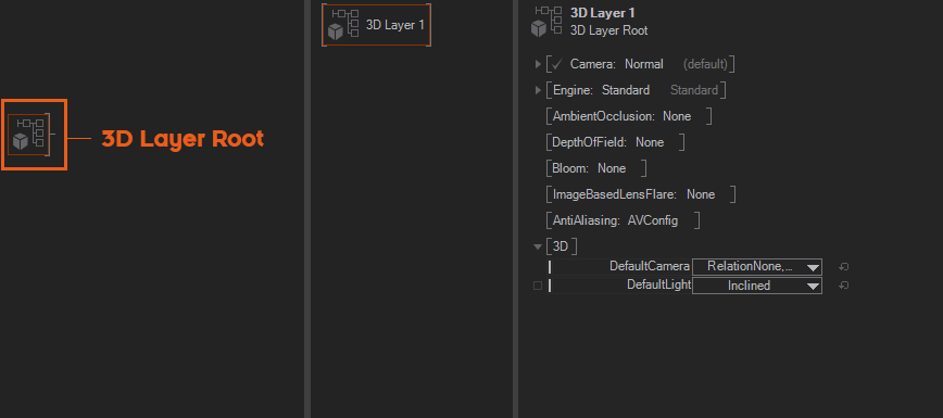

    3D Layer Root Node
    There are several properties available on the 3D Layer Root when using the Standard Render Engine, HDR engine specific properties will be explained at the end of this section.

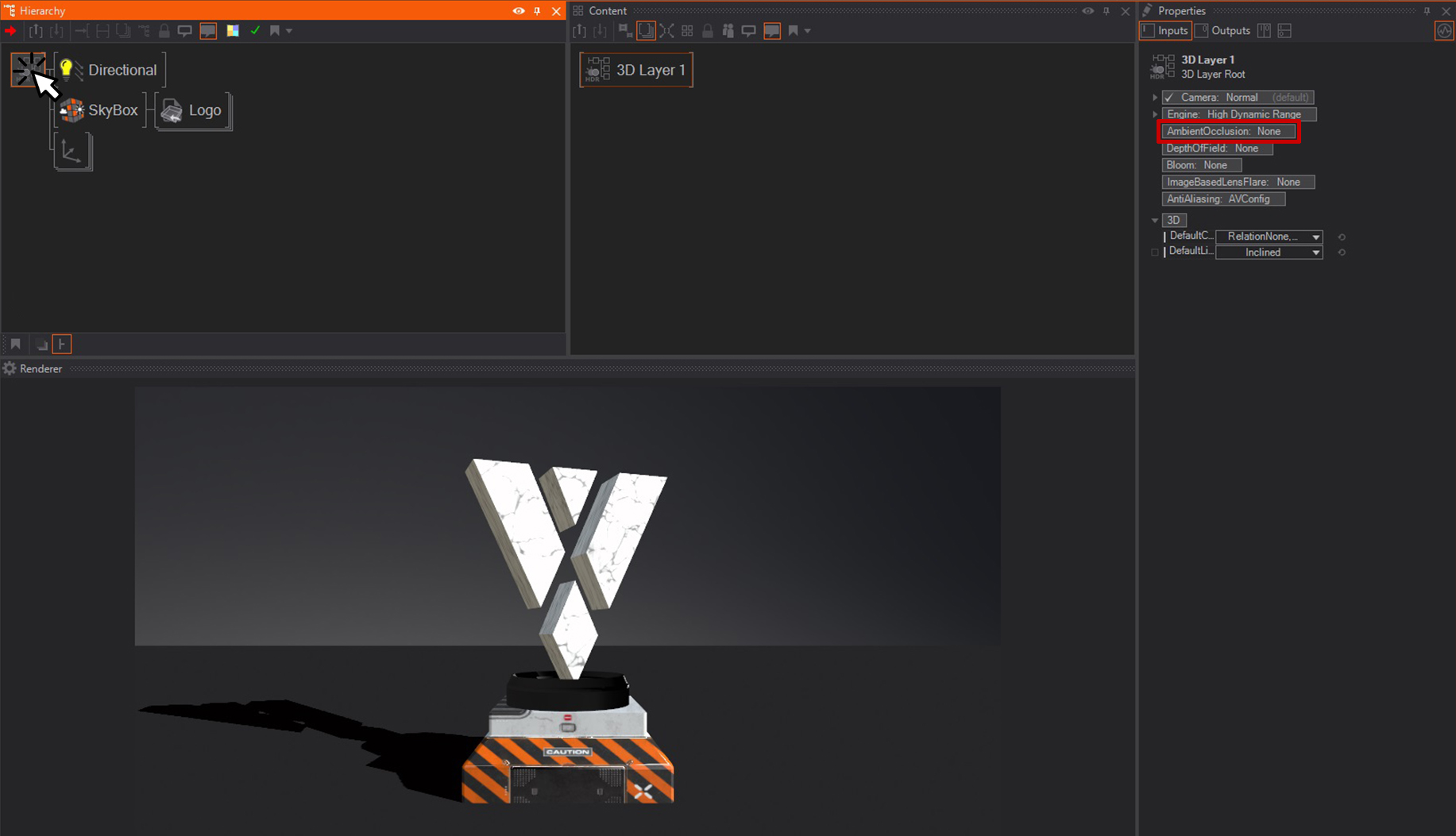

    In order to access the different render modes, click on the Layer Root that appears in the Hierarchy Editor of every 3D Layer. This layer root holds all the render properties of each of the available render mode.
    Keep in mind to unfold or open the properties by right clicking on the properties or click the small triangle in front of the properties.
    • Camera: A drop-down menu used to select the camera that would be used in that 3D Layer. One powerful feature of Ventuz is that cameras can be shared between 3D layers, allowing an effective combination of 3D compositing and 2D post-processing in the same environment. There are two types of camera options available, with these particular parameters:
      • Normal: assigns a separate camera per 3D Layer, the default option that appears on the drop-down menu. Below is the default camera, you can find the rest of the 3D cameras available in the scene - 3D cameras are named accordingly to the 3D Layer they belong to, but can be renamed more usefully instead.
      • A/B: This option allows selecting two cameras and blending camera position between them, it is mostly used to make 3D camera transitions between two existing 3D cameras. These properties are available:
        • Camera A: A drop-down menu used to select the first 3D camera for the camera transition, initially uses the default camera.
        • Camera B: A drop-down menu used to select the second 3D camera for the camera transition, initially uses the default camera.
        • Amount: controls the blending between the camera positions. It expresses blending as a percentage and the default value is 0%, meaning that the result is Camera A position, while 100% means that the result is Camera B position - intermediate values interpolate between those two values.
    • Engine: A drop-down menu used to select the render engine/mode used in this 3D Layer - the selected Render Engine appears in gray close to the engine drop-down menu. The default value is Standard mode. If you want to use HDR select High Dynamic Range.

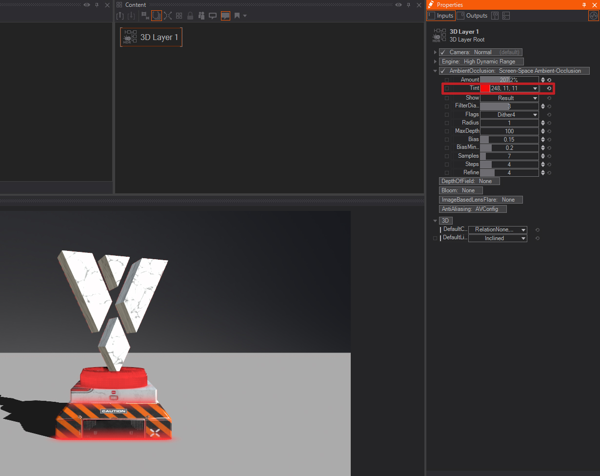

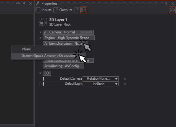

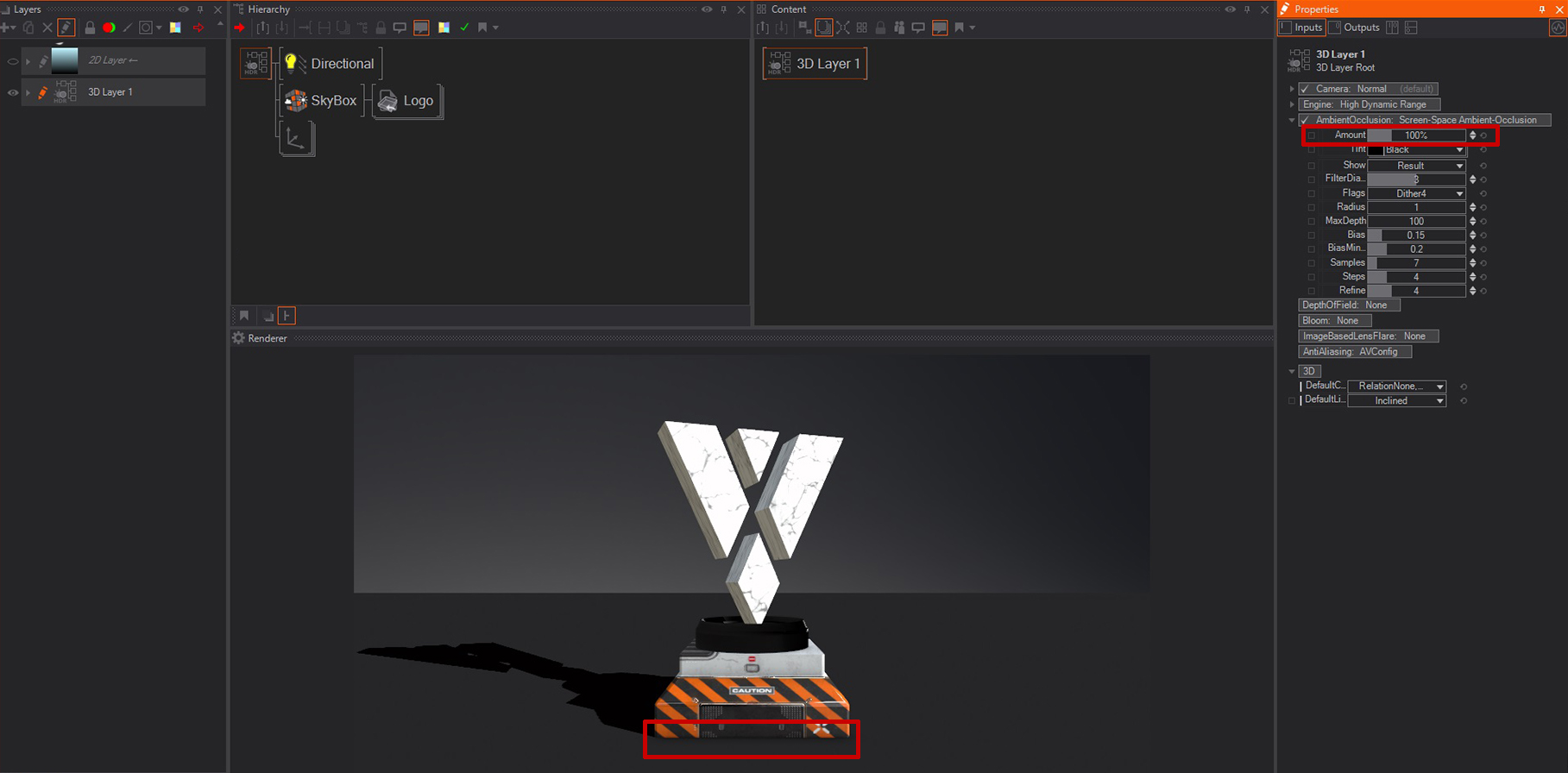

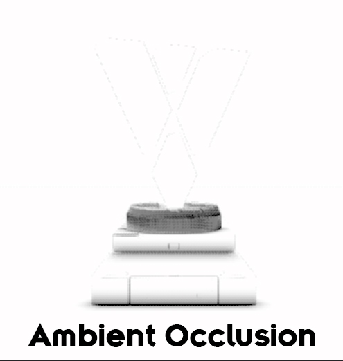

    Ambient Occlusion (SSAO)
    This enables the Screen-Space Ambient-Occlusion, which is a term for various techniques that try to create the effect of ambient occlusion by looking at the depth-buffer and the normals of all objects on screen and pixel by pixel. All screen-space techniques have the disadvantage that they can't react to stuff that is out of the screen, and they can't handle transparencies, because per pixel on the screen there is only information for the top-most polygon. The specific implementation of SSAO chosen for works like this:
    For every pixel on the screen (the center), we want to know within a given radius the percentage of pixels before the center. Before means before the plane created by the center position and normal. We can't test every pixel, so we cast a few rays from the center (in 2d), as far as the radius (converted from 3D to 2D screen pixels). For each ray, a couple of equal-distance steps are taken to see if the center is occluded. If a wall is hit, the steps are defined in a binary fashion to narrow down the precise position of the first pixel that occludes the center.

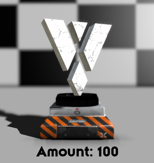

    • Amount: How much of the ambient occlusion is applied. You can go over 100% to exaggerate the effect.
    • Tint: Allows you to change the color of the applied ambient occlusion.
    • Show: Tuning SSAO can be tricky, and this option allows to look at various stages of the effect.
      • Result shows the final effect, Ambient Occlusion shows the ambient occlusion map that is the result of the averaging explained above. Depth shows the depth buffer, Normals shows the normals of the objects rendered, Camera Space Position shows the 3d position of the objects rendered, from the camera point of view.

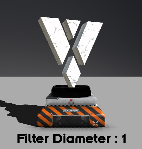

    • Filter Diameter: SSAO can be noisy, a little bit of filtering gets rid of this at the cost of making things more blurry.
    • Flags, 32-bit depth: To speed up the shader, the depth buffer is truncated and converted into a 16-bit depth buffer. When using a large MaxDepth, switching to full 32-bit depth buffer can increase quality.
    • Flags, half resolution: Half resolution is four times faster but more blurry.
      • Flags, dither: Without dithering and a low number of rays, the direction of the rays become visible as streaks in the AO. Dithering will randomly rotate the rays (in 2D), masking the streak effect but adding noise. The noise can be filtered with Filter Diameter.

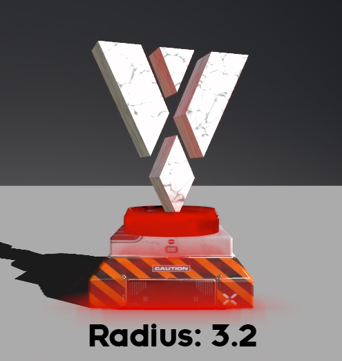

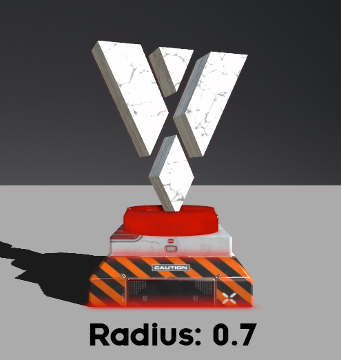

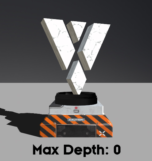

    • Radius: Radius in 3D-units for how long the rays are cast. Walls as described above will only be found within this radius.
    • MaxDepth: fade out the ambient occlusion behind this depth. Too large depth will limit precision.
    • Bias: Even on a plane surface, rounding errors might see occluding pixels where they are not. The bias will blend out small surface irregularities. The value given is the cosine of the threshold angle.
    • BiasMinRadius: during refinement, points very near to the center are sampled, which adds inaccuracy. This is a special threshold that is increased towards the center.
    • Samples: Number of rays cast.
    • Steps: Divides each ray in equal-sized steps, within the Radius.
    • Refine: After hitting a wall, do this many binary subdivision steps to refine the result.

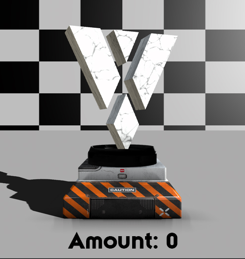

    Depth Of Field
    This enables the Depth of Field effect, an effect that is often used in filmmaking and uses the blurriness of the out of focus elements in the scene to drive viewer's attention to certain parts of the image. The options are None, Fast Depth of Field and Quality Depth of Field - the latter is available in two versions, one with simple settings and one with advanced settings similar to the Fast Depth of Field. Simple Depth of Field is a relatively fast method of calculating DoF, but it comes with a drawback: The quality is very much dependent on proper settings. At this point in time, it mostly is used in small amounts to add realism to 3D scenes. The Quality Depth of Field uses up more perfomance but is easier to control, especially the non-advanced version of it.
    Common Properties:
    This lists all properties that are present on all types of Depth of Field shaders:

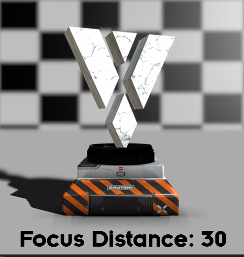

    • Show Focus Plane visualizes the currently used Focus Distance. You can also adjust its Focus Plane Alpha.

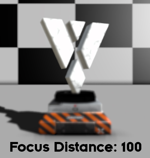

    • Focus Distance: This sets the distance to the focus point. Notice how the Focus gets pushed further away from the point of view with higher input.
    • Quality: Changes the render Quality of the Depth of Field effect. This is helpful if e.g.: the edges of an object have artifacts caused by low quality. Generally speaking, such effects are mostly pretty ressource hungry. For a better overall performance this should be set to the lowest value with acceptable results.
    Instead of an enumeration you can control the Sampling Quality of the Quality Depth of Field using a floating point number between 0 and 1. The effect of the property stays the same.
    Quality DoF:
    This lists all properties on the simple Quality Depth of Field:
    • Aperture: The aperture that is used to calculate the behavior of the Depth of Field. This parameter reflects the physical Aperture of a Camera. As such it controls the Near and Far Blur intensity as well as the fading from sharp portions of the screen to blurred ones.
    • Max Kernel Size: This artificially limits the size of resulting bokeh effects to improve performance - otherwise it would harshly drop the framerate and consume GPU power.
    Fast and Quality Advanced DoF:
    Following is a list of the common properties of Fast Depth of Field and Quality Depth of Field Advanced:
    • Amount: Controls the overall strengh of the depth of field effect.

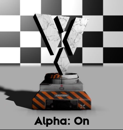

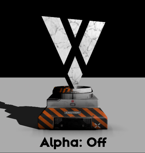

    • Alpha: With this option you can control if the Layer with the Depth of Field effect will have an Alpha applied. This enables blending with a layer beneath it. Again, producing an alpha channel will use up more performance.

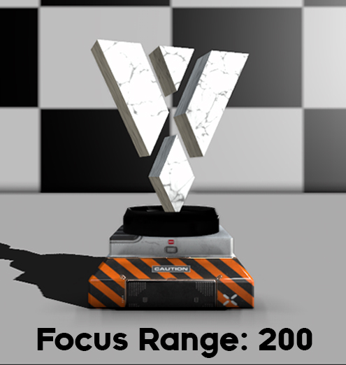

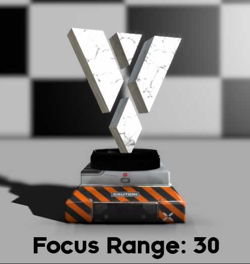

    • Focus Range: Determines the range around the focus point that is in focus. Also introduces a soft transition to the blurrier portions of the scene.
    • Far Range: Provides the option to get more of your scene into focus. But with this option the nearest blur line stays where it is and only the furthest point of the effect gets moved.
    • Near and Far Blur: This changes the Strength of the Near or Far blur.

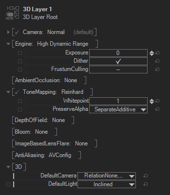

    With the Engine drop-down menu you can switch to High Dynamic Range. The calculation will then switch internally into a 16bit floating point precision which makes it possible to make proper use of real HDRi's (High Dynamic Range images) and lighting calculation for effects like bloom and glare.
    Unfold or Right Click the Engine property to show HDR specific properties. You can adjust the Exposure level then, to change the luminosity level. The Dither option reduces color banding. FrustumCulling works the same way as in the Standard Engine mode.
    Another Property group called ToneMapping is now available. In the drop-down menu you can switch between Reinhard, Linear, Filmic and Khronos PBR neutral tonemapping. The default Reinhard tone mapping lets you adjust the Whitepoint which sets the luminance level to use as the upper end of a tone mapping curve. The Whitepoint is mostly adjusted by artists to create a more colorful result. Linear and Filmic have no properties to change since they are based on fixed internal formulas, except for the PreserverAlpha. Linear renders really linear colors from 0 to infinity, while our monitor use colors at gamma around 2.2 from 0 to 1. When using the Filmic tone mapping, it happens that in the real world the Film itself is not capable of capturing the whole intensities, it uses a characteristic curve, it does not capture the intensities linearly. Film tone mapping, therefore, is an artistic tone mapper which emulates the natural film. There is a real advantage when using the Filmic Curve: You have Crisp blacks, a saturated dark end and nice highlights. Khronos PBR neutral tone mapping is designed to keep color accuracy and saturation. (More info: ​here)
    For all Tonemapping modes you can adjust the PreserverAlpha with a drop down menu. This defines what happens with the HDR-Layer when it uses alpha to blend over another layer. DiscardAdditive clips everything that is brighter than the alpha would allow it. This mode is used when you have mostly opaque objects. SeperateAdditive is the same as DiscardAdditive but allows additive post effects like the bloom and image based lens flare. Use Passtrough when you have a lot of specular reflections and transparency, it reproduces accurately additive reflections and effects. It might result in wrong alpha blending around object edges. MergeAdditive compromises between alpha and additive and reproduces both but makes color and highlights darker and saturated. This adjusts your materials: do not use it when your layer will be fully opaque since the other modes do not change the colors.

    Each 3D Layer Root node has a section to add Custom Effect Shaders and create custom 3D effect shaders and renders. Simply add a Custom 3D Effect and select a default shader. It automatically creates and bind the Shader Data input to the Custom Effect Shaders content node output. For detailed information of the properties and how to use this feature please see the node's page.
