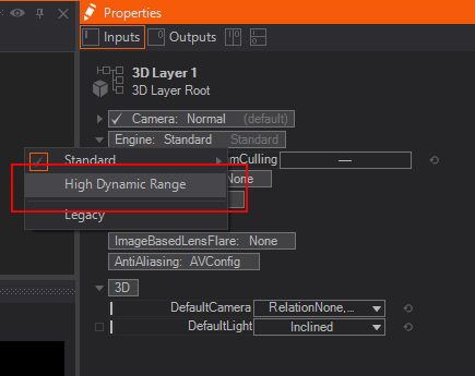

  1. Select the 3D Layer Root node - the very first node in the Hierarchy Editor in every 3D Layer.
  2. Inside the Properties Editor, you will find a dropdown menu for the Engine.
  3.  Click on Engine:Standard to bring up the selection menu and  click High Dynamic Range.
When switching from Standard to HDR, the overall colors will have a slight variation due to the nature of the HDR Mode.
When the HDR Engine is enabled, you will see additional properties such as: Exposure, Dither, FrustumCulling and another dropdown menu for the ToneMapping selection as well as another set of properties depending on the selected ToneMapping mode.

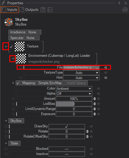

  1. Select the SkyBox node and select the SkyTexture Property, switch from None to Texture to load a HDRi.
  1. Unfold the Texture Property, unfold the Environment (Cubemap /LongLat) Loader and chose/load a Texture by clicking click  the File Property.

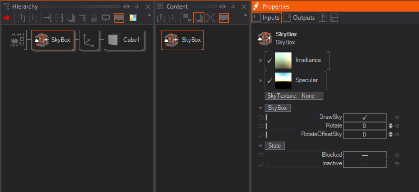

  1. Use the existing SkyBox or create a new one and load an Irradiance Texture into the Irradiance slot and a Specular Texture into the Specular Slot. You can find example Textures by using the interactive Help for the SkyBox or use the Link from the hint above to locate the example textures.
  2. Create a an Axis with ScalingFactor: 10 and a Cube with BevelRadius:0.1 behind the SkyBox node.
The SkyBox node works like a LightGroup. Only the nodes/objects behind the SkyBox will be affected by the SkyBox

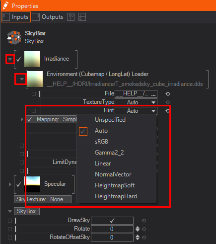

Most times the first step is to adjust the Gamma for the loaded images. Adjusting irradiance, specular and SkyTexture comes next. For each of these textures there is a dropdown property called Hint.
To access this property you need to unfold the Irradiance Property then the Cubemap Loader and there you will find the hint dropdown menu which is usually set to Auto.
Gamma
HDRi images will have a gamma value written in their metadata; Ventuz will try to adjust the gamma using this information as the default setting is Auto. If necessary, you can adjust the gamma manually to correct for errors. In most cases you will need to switch the hint to Gamma2_2. Its important to check if you need to do that for both or all used SkyBox textures. The hint is available for all texture loaders: Irradiance, Specular, and SkyTexure

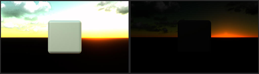

Exposure in Ventuz behaves the same way as a real camera does. You can find the Exposure property at the 3D Layer Root node. The higher the exposure value the more light will travel into the camera resulting in more brightness, the lower the exposure the less light will travel into the camera and therefore darken the scene/environment.
In the case of the HDRis from the Help Scenes, it would be wise to darken the scene, it still looks over-exposed (as long as you use our default textures). You will notice that starting with exposure values around -2.26, details such as clouds will be noticeable, and the cube will become more naturally lit. Adjust the 'Rotate: 70' for the SkyBox - this will rotate the whole sky and you should face the sun.
Experiment with the Exposure and lower the value to around -8.5 so you can spot the Sun-Disc.
The above example shows the difference between an exposure value of -2.26(left) and -11.0(right) - This way you can realize how much dynamic light information is stored inside the HDRi. Also notice that the environment also lights and colorizes the geometry, the beveled cube in this case.

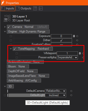

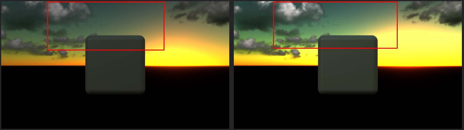

As long as you use the default set Tonemapping: Reinhard you can adjust the Whitepoint. By adjusting the whitepoint you simply tell the engine which brightness value is pure white. It will bring more clarity and detail to your image and eliminate the haze you see in many images.
In our case with the default Sky Textures we would adjust the Whitepoint, depending on the Exposure as well, by setting it matched to the "white in the clouds". You adjust the Whitepoint first to have the image, or in our case, sky, look more natural.
Adjust the following properties to match these values: Exposure: -6.28and Whitepoint: 0.24
You can spot the differences not only while you adjusted the values; You will see the differences in the clarity and that the clouds are not starting in the gray - they start with the corrected white and then have their gray scale applied.
