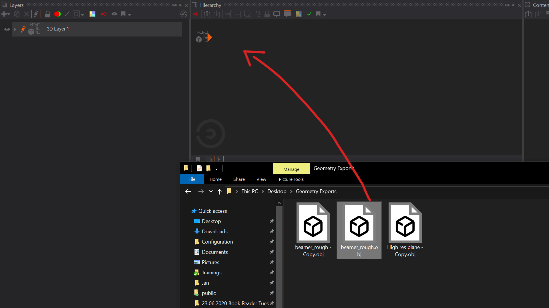

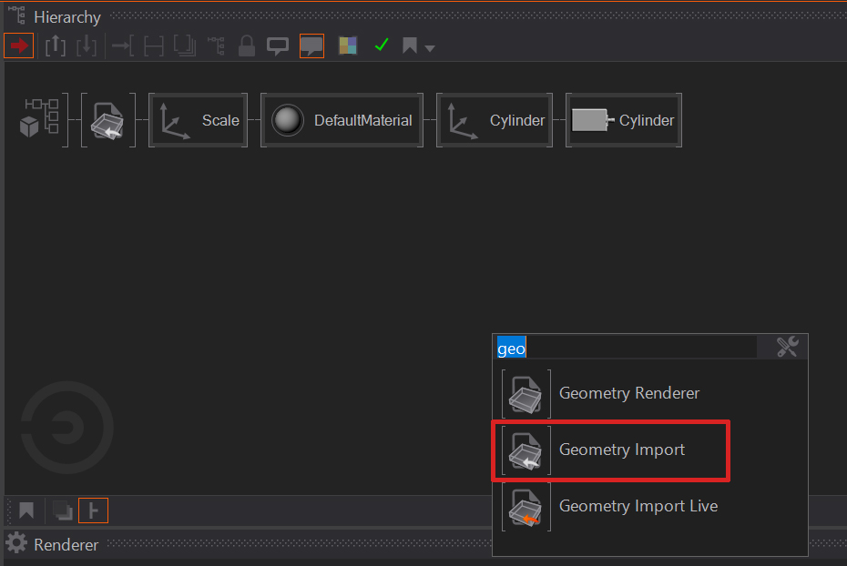

Generally speaking the import of a 3D asset from a geometry file is done very quickly by just dragging and dropping it from the Windows File Explorer into the Hierarchy Editor in Ventuz. For more supported 3D formats see further below.

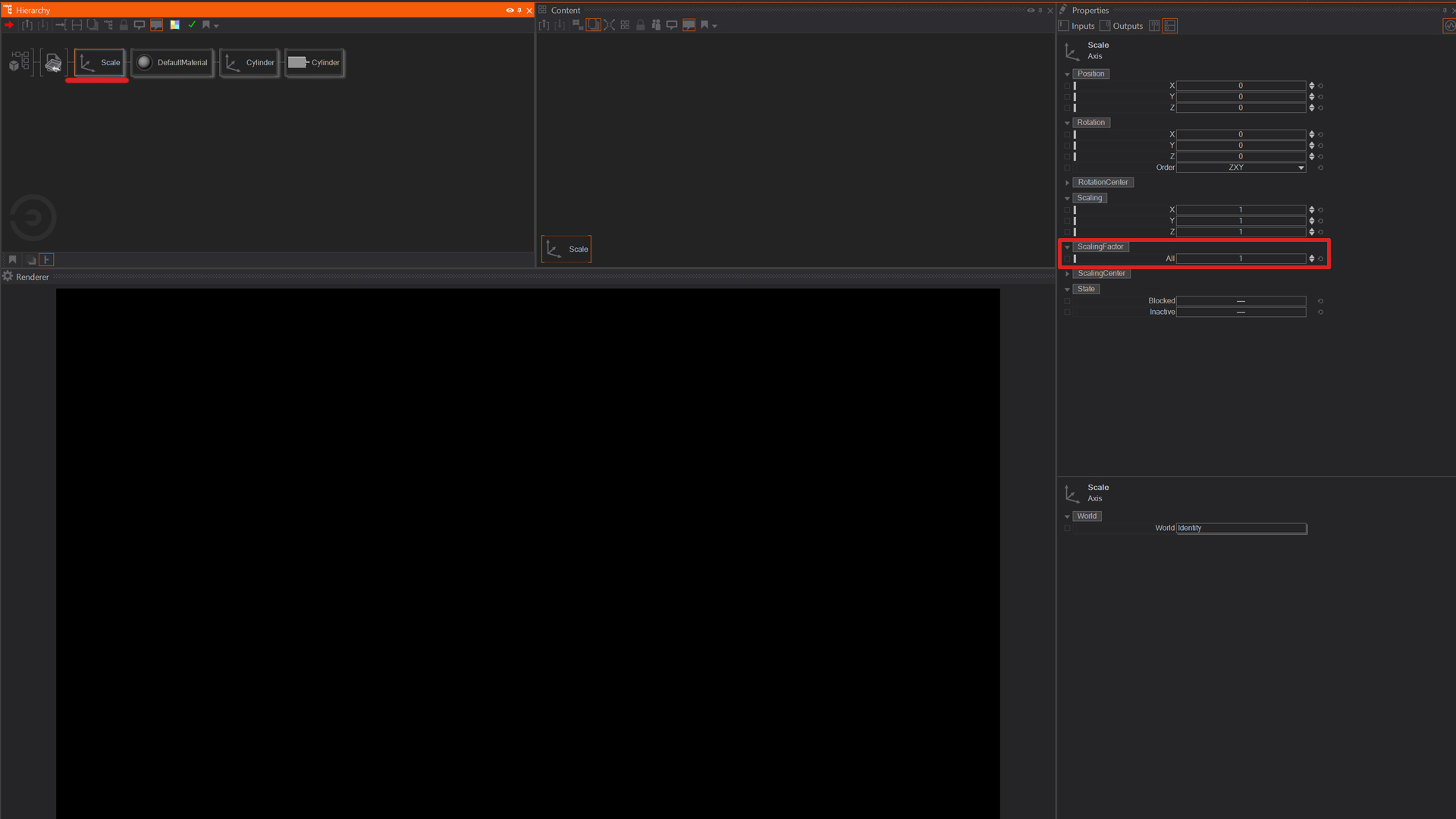

If you do not see anything in the Renderer Window that is probably because the units of the object are not set correctly to 1 Meter. So your object might be either very small or very big.
Always use 1 Meter as 1 Unit so your object keeps the right scaling.
For now you can just change the scaling of the first axis in your geometries tree in the Property Editor if you encounter this problem.
It is also possible to do it the other way around by grabbing a Geometry import node from the toolbox, clicking on the asset property and searching for your asset with the file explorer.

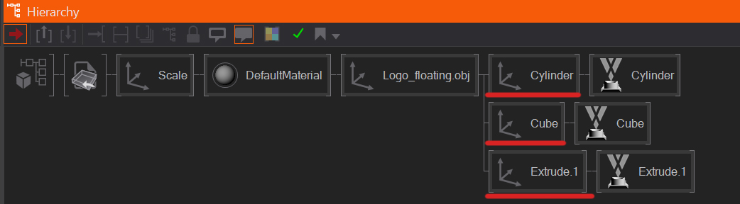

As you can see when there is no texture provided with the mesh Ventuz will just skip it (warn you with an error) and add a default material. Depending on the complexity of the mesh there will be more objects in the hierarchy editor. Ventuz will never merge meshes and will always display every mesh with its own axis and the corresponding name.

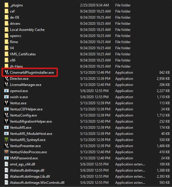

Another way of working with your 3D models is the Live import.The Cinema 4D plugin for Ventuz is included with the Ventuz installer. After you have installed Ventuz, simply locate your install folder and run Cinema4dPluginInstaller.exe and follow the on-screen instructions.
Cinema 4D must be opened once before the installation of the plugin!

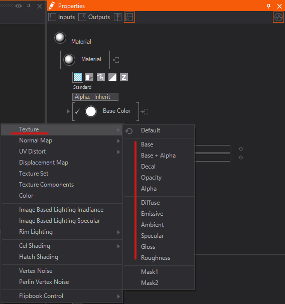

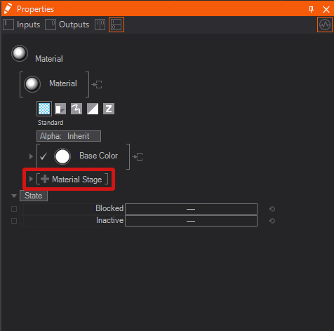

In the following short introduction into Materials you will learn about Material Stages. These are commonly referred as texture channels in most 3D Applications. You will find them directly in the Material that Ventuz created for you after the import of any 3D object. Or just grab a Material Node via the Toolbox.
By  clicking on the small plus you can add a new stage. There under Texture you will find many different types which you might be familiar with already.

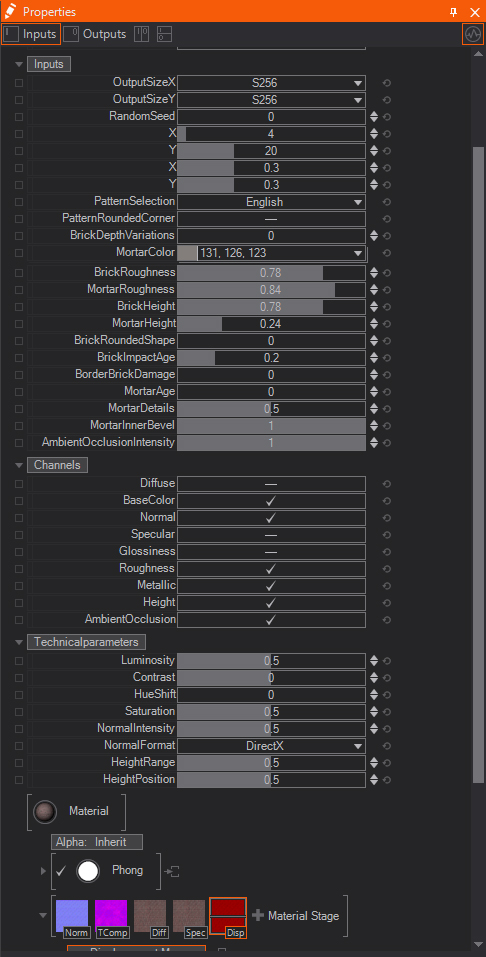

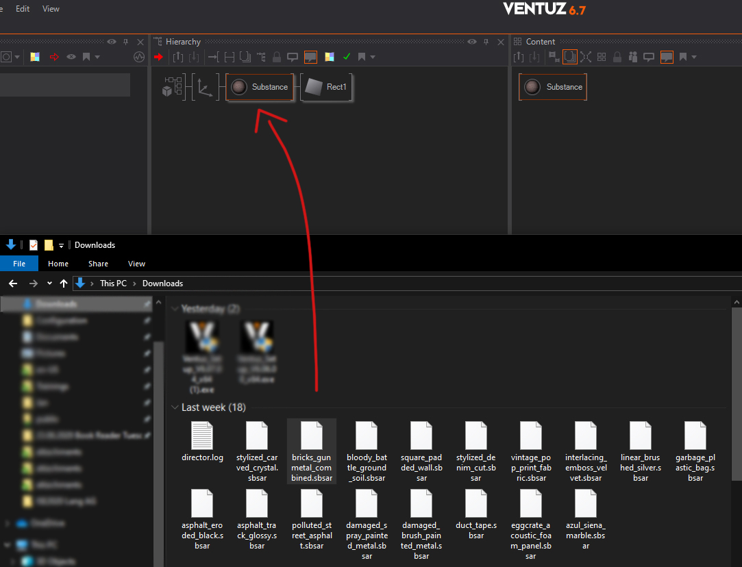

With this you can add as many stages onto the material as you need. Since Ventuz 6.4 we also added the possibility to use Substance Materials (.sbsar) which can easily just be drag and dropped into the hierarchy editor.
A good source for those textures is ​Substance, if you have a abo of their software you get free points every month to download high quality textures which can be used for commercial projects as well. These textures have predefined properties which you can change in Ventuz as well. You will find them in the properties window after clicking on the just imported texture in the hierarchy editor.
This is different from texture to texture depending on what the artist exposed while building it.
There are some things to keep in mind when working with such Materials. for a detailed description on Substance materials click here. We also have a How to where you can learn to use the Substance integration right here.
To learn more about the Material stages and its possibilities take a look right here.
