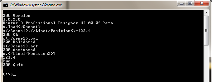

The current version of the Command Line Interface is not able to deal with multiple instances of the same Scene, because Scenes are addressed only by their Scene Identity. Also Layouts with multiple Ports are not supported. Activating a Scene always uses Port !#0 - the default Port
Establish a connection to the target machine via telnet.
telnet hostname port(configured in the Machine Configuration)
Simple example of a CLI communication.
