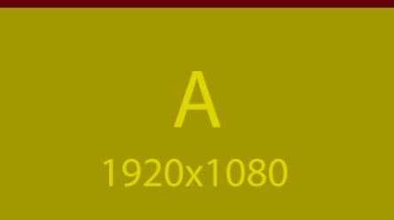

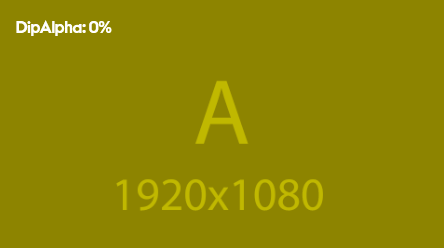

Effect : Dip
This allows to transition from A to a dip-color, and from that to B.
Property Default Function
Overlap 0% at 0%, A will fade completely to the dip color, at 50%, and then fade to B, A and B will not overlap. At 100% overlap, this behaves like mix with the overlap color not visible.
Negative values can be used to add a phase where the dip-color is shown for an longer time.
DipColor Black Color to dip to.
DipAlpha 100% Alpha to dip to.

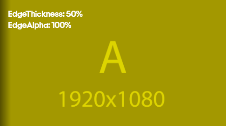

EdgeThickness 0 How thick the edge is, filled with EdgeColor and EdgeAlpha.
EdgeColor Red Color for the EdgeThickness
EdgeAlpha 100% Alpha for the EdgeThickness

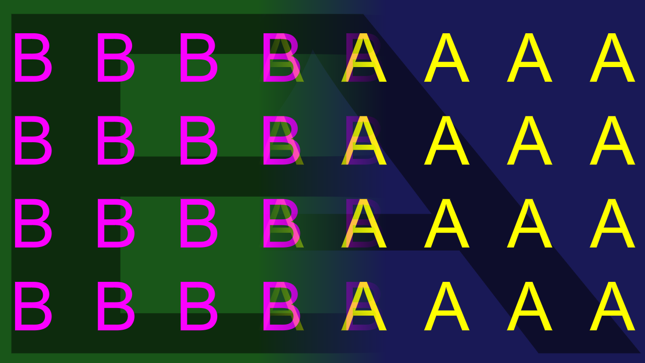

Clean Edge
Softness = 20%
Thickness = 1%
Softness = 1%, Thickness = 2%
If both softness and thickness are used, the softness can not be larger than the thickness, and the softness is applied to the transition from A or B to the EdgeColor / EdgeAlpha.

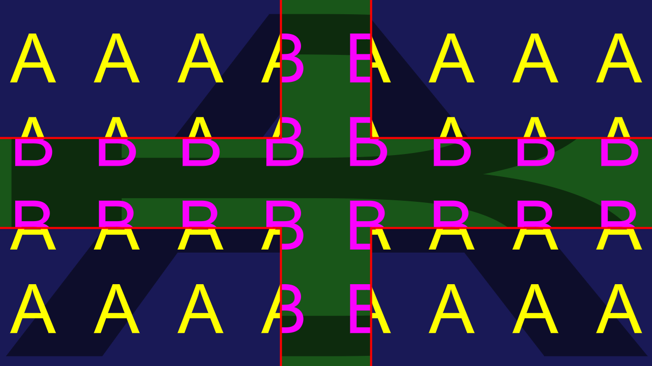

Direction : Horizontal / Vertical
Horizontal and vertical wipes. This can also be used for slide effects.
Split false Go from the inside to the outside, not from one edge to the other.
Invert false Switch the direction.
Direction Vertical Vertical or Horizontal.
SlideA false Move the A image with the edge.
SlideB false Move the B image with the edge.

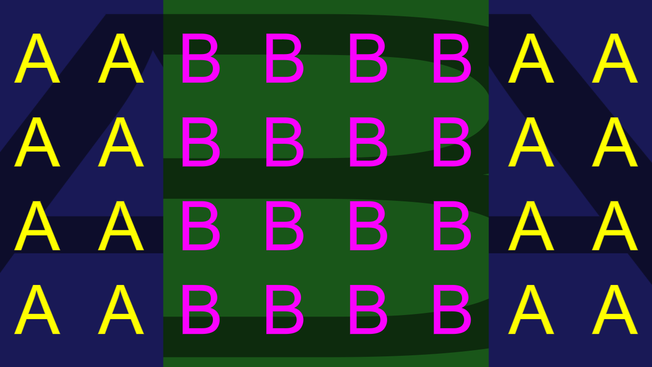

Horizonal Wipe:
Vertical Wipe:
Split:
Slide (both A and B):
Slide and Split:
In split mode, only the image that is on the outside can use the slide effect.

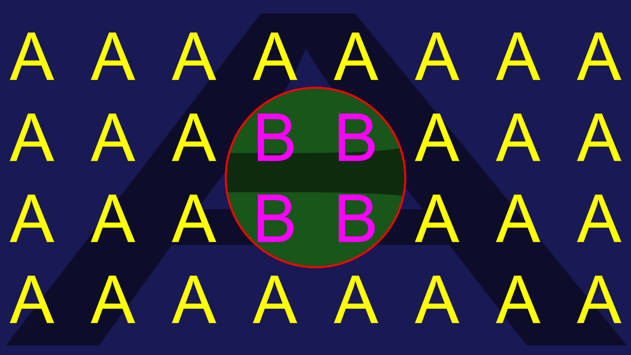

Circle:

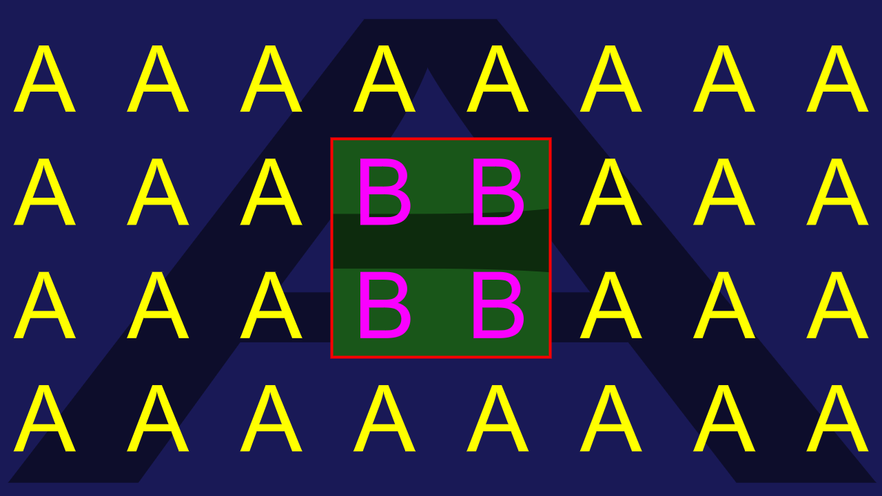

Rectangle:

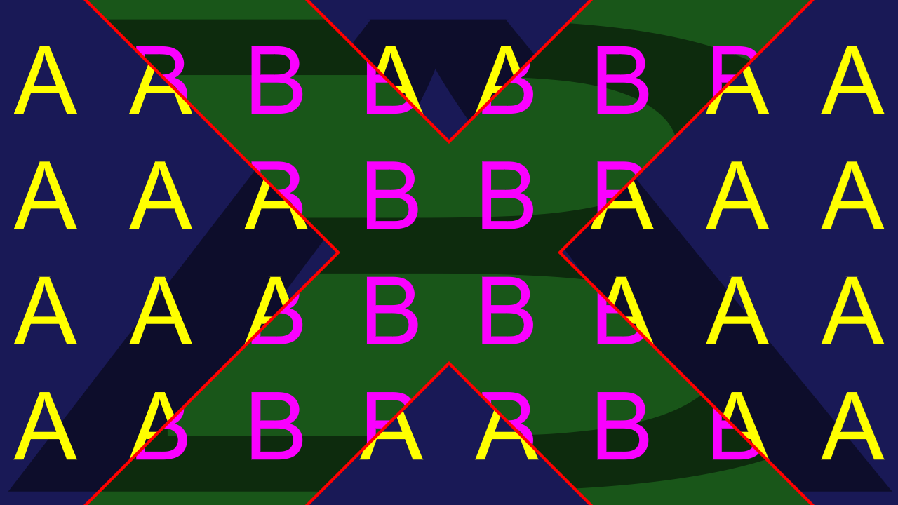

Diagonal Cross:

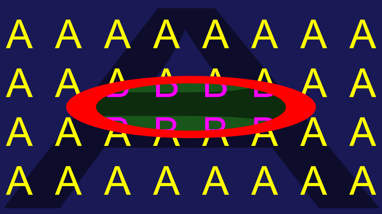

The circle shape has an additional problem: if edge thickness or softness is used, calculating the correct thickness of the edge becomes complicated, and correct results might look strange, so just stretching the border with the aspect might look better:
Circle 4:1, Correct aspect:
Circle 4:1, Stretched aspect:
