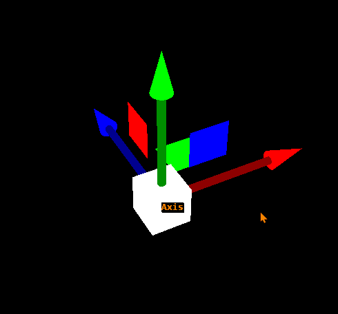

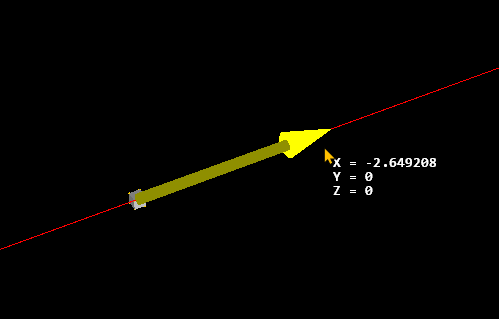

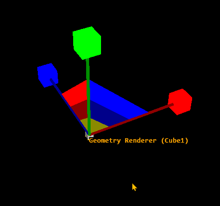

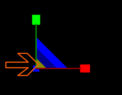

Translation
The translate gizmo has three axis and three planes. By hovering over an axis with the mouse, the axis will be highlighted in yellow. Clicking & dragging  on one of those axes will cause a translation in that axis only. A line will be shown as a guide while translating along one axis. Clicking & drag  on the planes in the gizmo, you will translate on either XY, XZ, or YZ plane. Clicking & dragging  on the center white box will allow translation based on the object's aligned in camera view. While performing a translation, the actual coordinates being modified will be shown on screen.
You can make use of the shortcuts (X, Y, Z) to enable an axis lock. When holding one of these keys, show only the selected axis will be shown.
Translation Modes Single Axis Translation Axis Lock
If an axis is bound to another Node, that axis and associated planes will be grayed out. While interacting the gizmo, the tool tip will show (Bound) for any bound axis. As shown below:
Bound Axis
While performing any kind of translation (TRS) - Right Click to cancel and reset the transformation to the value before you clicked it!

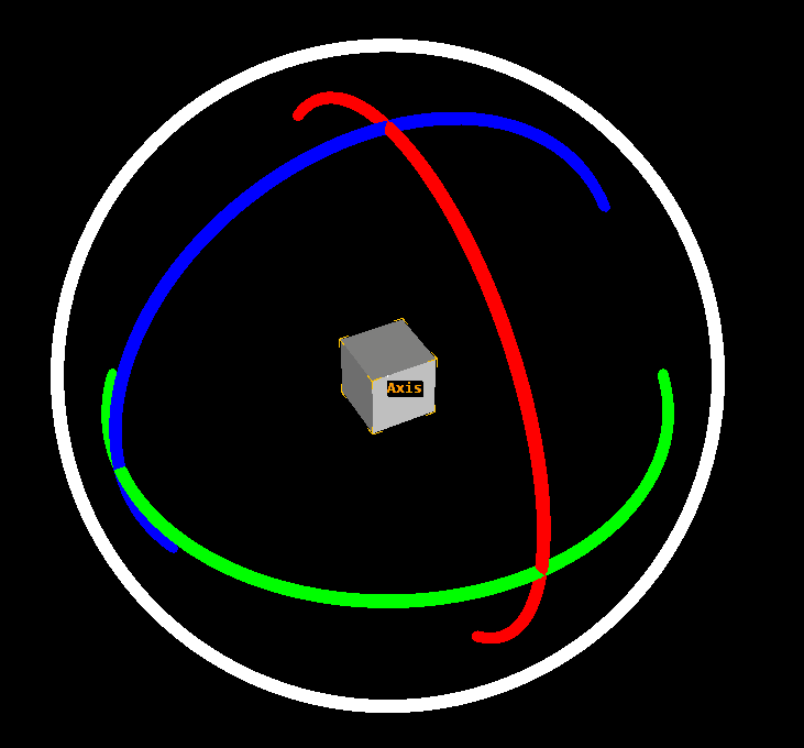

Rotation
The scale gizmo has three axis and a camera view aligned ring. By hovering over an axis with the mouse, the axis will be highlighted in yellow. Click & drag  on one of those axis will rotation based on that axis only. Click & drag  the outer white ring to rotate the object aligned with the camera's view. While performing a translate, the tooltip will show its actual coordinates.
The rotation will follow the mouse cursor. This results in better precision when the cursor is further away from the object!
Use the shortcuts (X, Y, Z) to enable an axis lock. This will show only the selected axis.
Rotation Modes

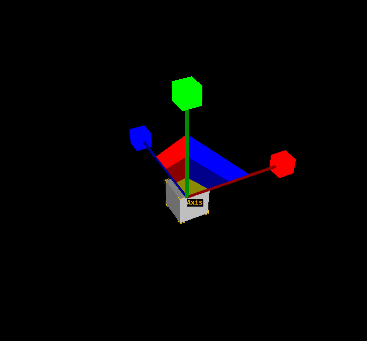

Gizmo Alignment
You can switch between three different gizmo alignments: Local, World, Parent.
The gizmo alignment buttons can be found in the toolbar:
Local World Parent
  • The Local alignment will align the gizmos along their local direction. Whenever you rotate an object, the translate gizmo will always be aligned to the local transformation following the objects initial pivot alignment.
  • The World alignment will keep the gizmos aligned following the Ventuz world coordinates no matter what orientation or rotation the object has.
  • The Parent alignment will inherit the orientation or alignment of the axis or object in front of its selected axis.
