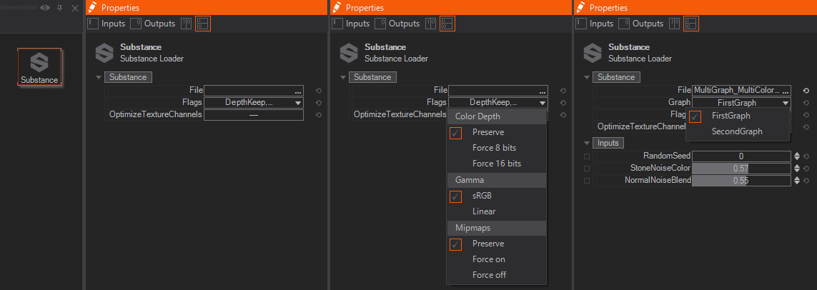

The common input properties for the Substance Loader node are the File to load a so called substance (as a *.sbsar format), Graph to select a specific part/graph, if there are more than one provided by the substance, and Flags which let you select Bit Depth, Gamma value and Mip Map's. Enable the OptmizeTextureChannels and Ventuz will compact all grayscale textures into one single output texture as long as their semantics do match. If a loaded Substance consists of several grayscale textures like an AO and Roughness, these textures will be combined into a single texture and use the R component for the AO and the G component for Roughness to save texture stages and outputs.
Bit Depth can be set for all output textures and you can set it either to 8Bit, 16Bit or Preserve which is the default predefined setting from within the Substance. Changing the Bit Depth will affect ALL output textures. Gamma can be set to sRGB or Linear. Changing the Gamma will affect only textures which semantics are set to sRGB or a different gamma value from within the Substance Designer and the ones that allow gamma changes. For example, if you force the gamma to sRGB, the NormalMap will still have its preset or own gamma. You can also set if and how Mip Maps should be generated. The available options are Force on which always generates Mip Maps, Force off to disable the generation of Mip Maps or to Preserve, the default set by the Substance.

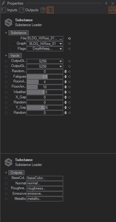

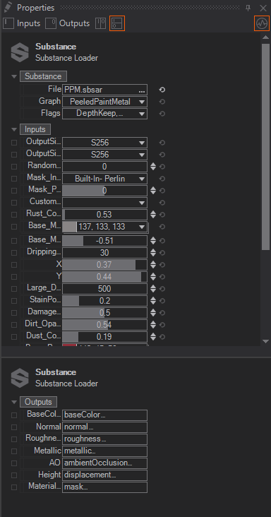

Please see the attached Images for examples of two different substances and their different in- and outputs:
  • Substance Material node
