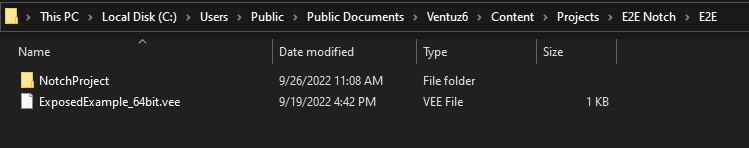

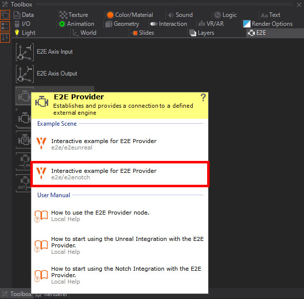

We need the example Notch Block to be copied into our project folder; an easy way to do this is to use the help scenes built into Ventuz. Create a new Project, name it for example, Notch E2E and create a new scene. Open the Ventuz Toolbox,  click on the E2E tab. hover over the E2E Provider node, and press F1. This will show the contextual help options;  click the Interactive Example for E2E Control for Notch:
A new scene will open. In the background, Ventuz automatically copied a the sample Notch Block to your current project folder and opened it. You can safely close the help scene.
The needed Notch block is now copied in your project location and can be found in: YOURPROJECT/E2E/NotchProject/
We created a project called E2E Notch in the default location. Therefore we will find our ExposedExample_64bit.dfxdll inside the NotchProject folder:
Whenever we reference to load the Notch Example Block, it can be found there.

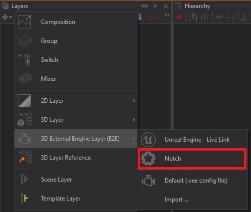

Add an E2E Notch Layer. To create the layer,  click on Layer -> 3D External Engine Layer -> Notch
Now select the newly created Notch Layer by  click it. In the lower part of the Layer Editor you can  click Engine and select Import:

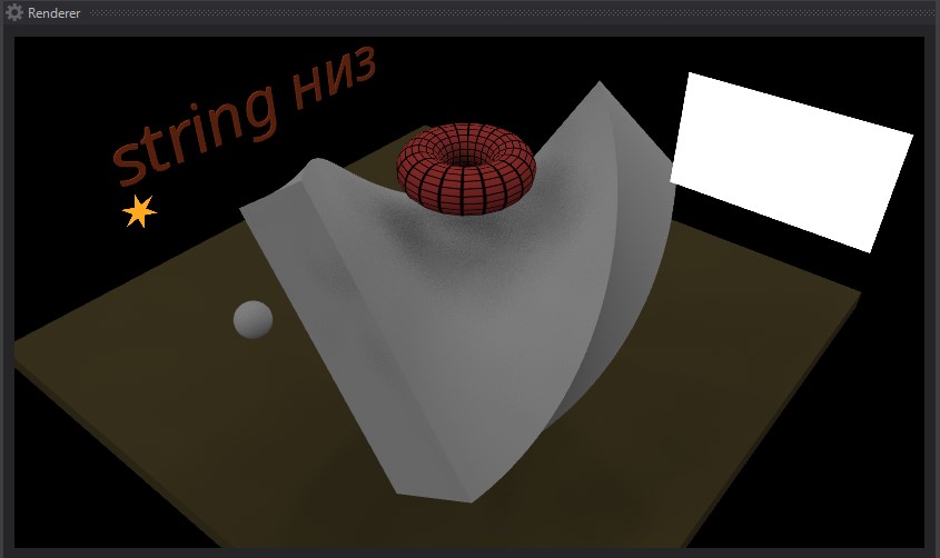

As soon as the Notch Block is successfully loaded, you will see its content rendered:

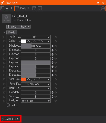

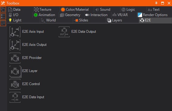

To access these exposed values we need to make use of the E2E Data Output Node. The E2E Nodes can be accessed trough the Toolbox or using the Alphabetical Searchbox:
Select the Notch Layer and  drag&drop the E2E Data Output Node into the Content Editor. Ventuz can automatically synchronize all of the Notch Block's exposed parameters. Simply  click the Sync Fields which can be found at the bottom of the Property Editor:
The above screenshot shows the synchronized fields.
Now you can bind the exposed values as you would with any Ventuz Scene. This example covers most of the available types such as strings, floats, integers, color and so on.
Whenever you press Sync Fields, all bindings to the E2E Data Output will be lost/deleted!

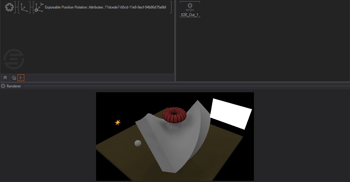

Use the E2E Axis Output Node to control an exposed property; in our example we'll be moving the torus from inside of Ventuz. All we need to do is fetch the Unique Identifier from Notch.
Select the Hierarchy Editor and create an Axis. Create an E2E Axis Output Node - either by  drag&drop the E2E Axis Output Node from the Toolbox or using the Alphabetical Selection, behind the Ventuz Axis.
Open the Notch editor and load the ExposedExample.dfx and find the property for the Exposable Null for the torus. Select and copy the whole Unique Identifier line into the clipboard using ctrl+c or  click and chose Copy.
Now go back to Ventuz Designer, select the E2E Axis Output Node,  doubleclick the Axis to rename it and paste the copied Unique Identifier to replace the name by using ctrl+v.
The scene will look similar to this:
You can now change the values for translate XYZ, for the Ventuz Axis, and the torus will move according to your changes in real-time.
This way you can directly access and change all exposed values from within Ventuz.

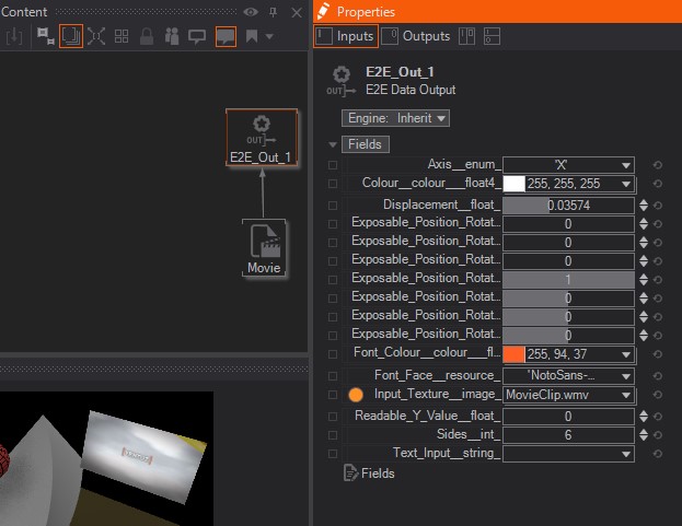

Send a Texture or Live Video to Notch
From within Ventuz, it is possible to send textures to a compatible Notch Block like live video, images and movies. With the example scene you can simply create a binding from the output, of a movie clip node, to the Input_Texture__Image_ of the E2E Axis Output Node:

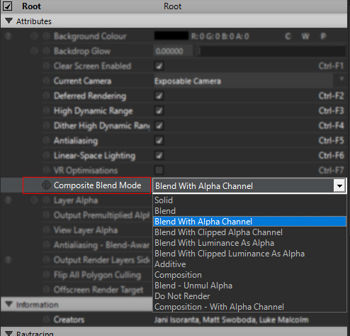

Keep in mind, that the Composite Blend Mode will be disabled by default for any custom made Notch Block. Therefore, if you plan to have your Notch Block blend with another Ventuz 3D layer or another Notch Block, you will need to change the Composite Blend Mode from within Notch before you compile the Block for a media server. You will find this setting in the Notch Root properties -> Composite Blend Mode

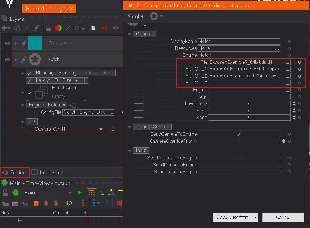

Running Notch on Multiple GPU's
In order to make Notch work on multiple GPU's you have to give every GPU its own notch block. For this simply copy the Notch block as often as needed and assign it to the GPU's separately.
To access the menu click on a Notch layer and find the "Engine" button in the lower left corner of the Layer Editor.
The "File" property is in fact MGPU 0 so always start with that. And make sure that every GPU, even if not used, has its own Notch block!
