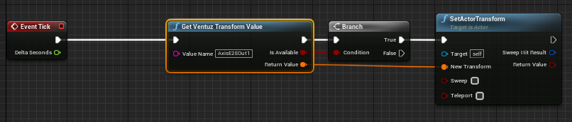

The more flexible way is to obtain the transform value whenever needed, manipulate it as desired and then apply it to any other properties of an Unreal Object. This is done via the Blueprint Nodes Get Ventuz Transform Value and Send Ventuz Transform Value. Illustrated below is a simple example that sets the Blueprint Actor's transform each frame to the current value coming from Ventuz. For this blueprint node to work you simply need to input the name of your E2E Axis Node.

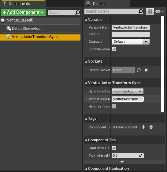

The other way is to use the Ventuz Actor Transform Sync component and place it on the actor that should continuously synchronize its world transform with the E2E Axis Node. Again, simply type in the name of the opposing E2E Axis Node on the Ventuz side and select whether to synchronize To Ventuz or From Ventuz.
The Relative Transform flag on the component determines whether the World Transform or the Relative Transform to the actor's parent is used (set or read respectively).

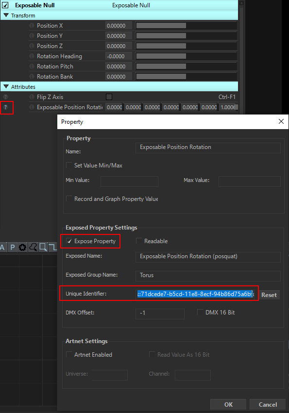

On one hand all exposed parameters from ​Notch can be accessed by using the E2E Data Output Node and using the Sync Fields custom verb, you would need to know the Unique Identifier from the Exposable Null node from Notch. You would need to  click the ? in front of the Exposable Position Rotation... attribute, set a checkmark in the Exposed Property Settings for the Expose Property and select the whole line that contains the Unique Identifier. Copy the value by either  click and select Copy or use ctrl+c.

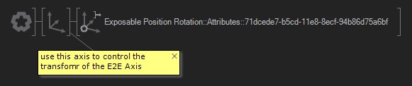

Rename the E2E Axis node by  double click and paste the copied Unique Identifier by using ctrl+v:
You can now use the standard axis node to control the E2E Axis Node.
