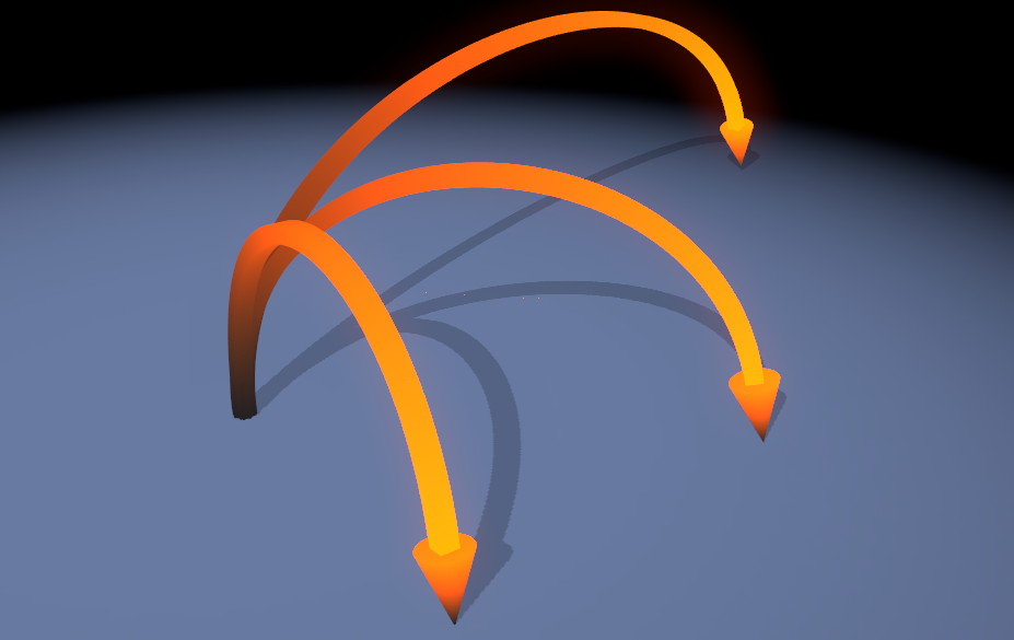

The Arrow Nodes are able to render extruded lines in the scene. There are two types of Arrows for the different kinds of definitions of the line: The Anchor Arrow renders a line from its position to the position of a given Anchor. The Path Arrow extrudes a given Path. The type of the arrow can be changed with the Source property group.
In the Profile property group you can define the shape of the extrusion.
At the end of the rendered line you can place a Tip Mesh with its own Transformation and Material. Tesselate adjusts the tesselation of all arrows and the ShaftLength defines to which point the extrusion reaches, moving the Tip to that point.

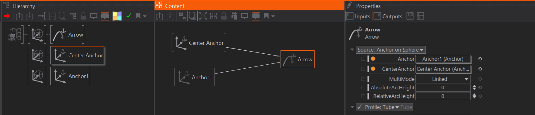

Anchor Arrow on Sphere
This mode is meant to draw arrows on a sphere. To draw an arrow, it needs the Arrow node, one bound Anchor and a bound Anchor as CenterAnchor. The center anchor is needed to render the arrows and mathematically to define the center point of the sphere, where the arrows are drawn on. The first arrow renders between the Arrow node and the first Anchor.
A basic setup would use the Spherical Axis and two anchors:
Most properties are identical to the Anchor Arrow mode described above. The different MultiMode FromFirst draws arrows with the Arrow node as starting point and each connected anchor as single endpoint, similar to FromCenter.
