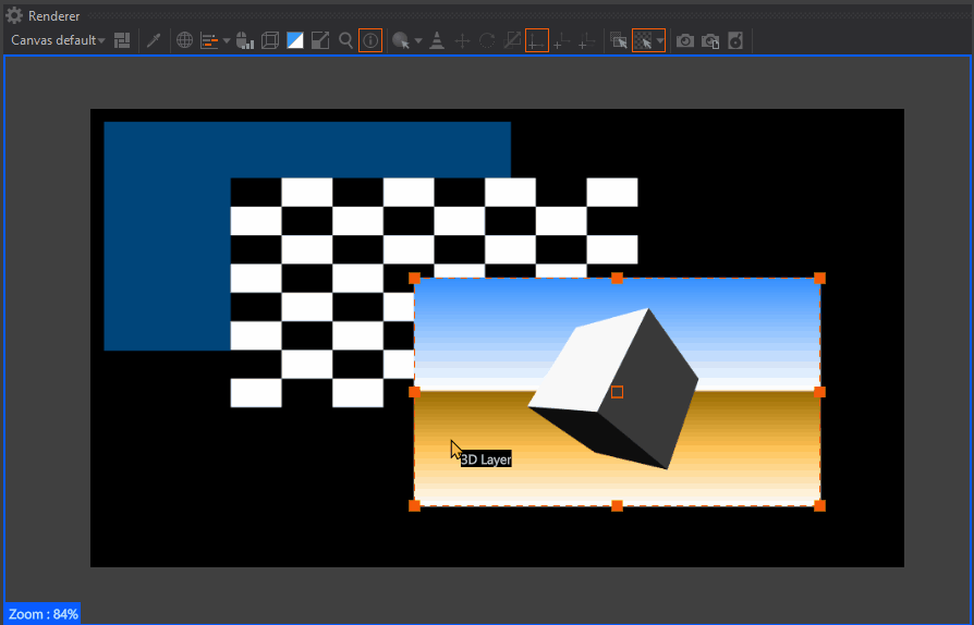

There are several ways to select a layer while your in In Scene Editing mode:
Auto Selection
Enable the 'Layer Auto Select' by clicking  the button:
Toolbar Button
  • Hovering over a layer, the layer will be highlighted with orange dotted line.
  • Click  to select the highlighted layer.
  • To select a layer that is behind or obscured by a different layer, hover over the boundary of the layer you want to select, while holding ALT, click .
    • If there are multiple layers behind each other, this method will cycle through each layer the cursor is over each click .
Without "Layer Auto Select" you can translate a layer from anywhere inside the Render Window. With "Layer Auto Select" you need to be inside the active layer to translate.

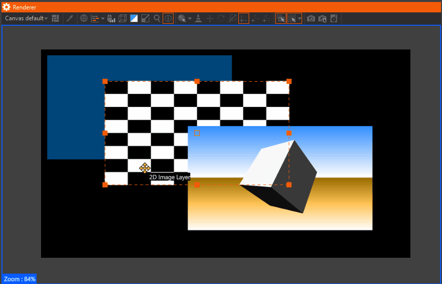

Layer Scale and Translate

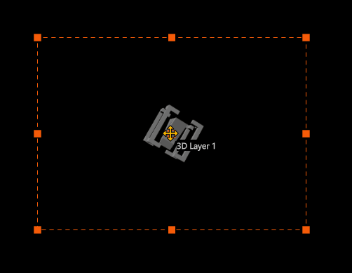

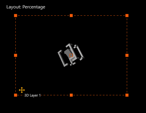

While ISE Mode is active, the selected layer will be indicated with an orange dotted frame. Handles will be available to modify its Scale and or Position. Click & drag  any of the handles to modify the scale of the selected layer. Per default, the scaling will happen in percentage. To change this, need to select a different Layout in the Layout Properties.
Click & drag  the center handle to translate the layer, either in percentage or pixels - based on your layout selection.
As you can see by the images above, while translating and even scaling you will see white snap-lines. If you translate the layer horizontally or vertically, you can have the translation snapped to the automatically created snap-lines, or custom guideline(s).

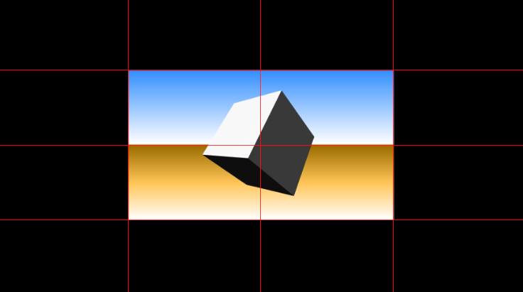

A snap will happen for simple translate or scale for the selected layer. There default snapping lines:
This means, that each of the "red lines" will snap to another layers "red lines": left, right, top, bottom and center lines.
Snapping will ignore the contents of a Layer and use the center and sides as the snap regions.
Note: The "red lines" are just for visual representation of the snapping here, they are not visible in the Renderer Window.

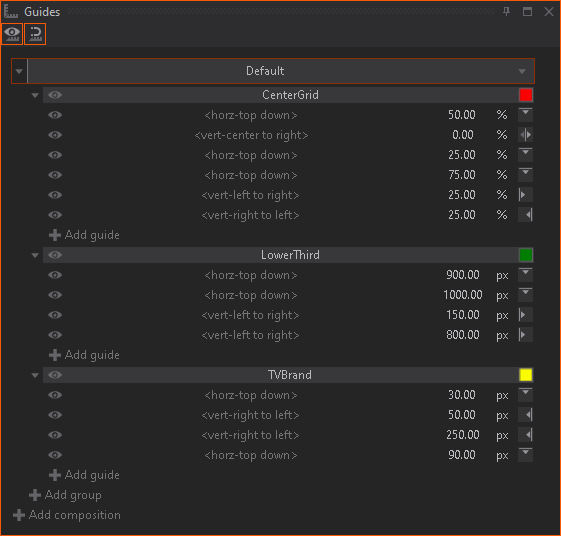

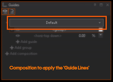

In a new project, Guides Editor will be empty:
To create Guide Lines, click  the + Add composition get started. Per default the Default composition will be used. If multiple compositions exist and you want to assign a different composition, click  open the drop down menu and select the desired composition:
Create a new Guide Line by click  + Add Guide. A new Group and a new Guide Line will be created.
Ensure to have the Guide Lines set to Visible by clicking the Eye button in the Guides Editor Window. Active will be indicated by an orange frame around the button - as shown below!
The above screenshot shows:
Default is used as used composition, for <group>, with one <horiz-top down> guide line at 0.00 % with top alignment.
You can collapse individual Compositions, and Groups to keep the editor organized!
Visibility can be switched on and off for individual groups and lines! (Eye Icon)

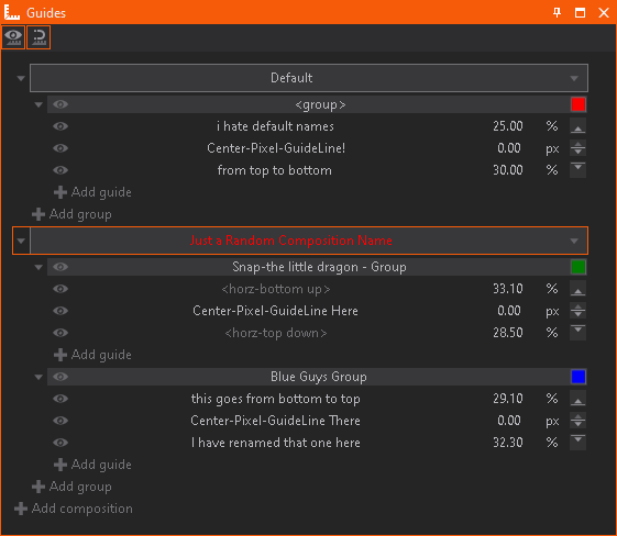

Groups
Each group can have its own color. It is possible to have several groups within one composition. To rename a group double click  the <group> name and assign a different name. To assign a different color to the group, click  the color-box to bring up a color palette. The 'Guide Lines within this group will be colored with the selected color.

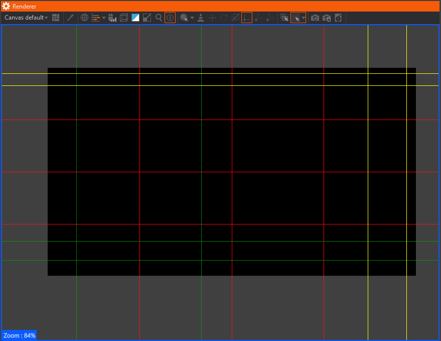

While Center/Middle alignment value changes will move the Guide Line Down(Center) or Left(Middle) for positive values - Bottom/Right alignment will move the Guides Up(Bottom) Left(Right)- according to the brighter triangle direction indicated in the icons above!
Snapping to Guide Lines will happen only when guides are visible! - Snapping to 2D Layers will be still active since this can be turned on and off with the snapping button in the Toolbar!

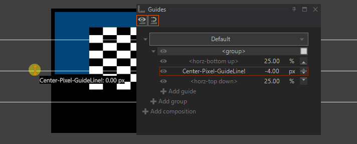

Interactive Guide Lines
You can translate the Guide Lines not only by changing the values. While you are in In-Scene Edit Mode you can drag&drop  the Guide Line at the outer areas of the render view (Gray Area). You will see the mouse cursor transform to an arrow when hover over with the mouse:

You can copy and paste whole composition Guide Lines, Guide Line groups, and individual Guide Lines.
Select the element inside the Guides Editor window you want to copy (composition, group, or single guide line) by click  on that particular element and press Ctrl + C (copy) and use Ctrl + V to paste it back into the Guides Editor window.
If you select a different composition in the window, it will paste its content into that. The same is true for Guide Lines.
Take note that you can paste the buffer into an notepad++ or similar editor!
It is also possible to have multiple guides sets using the same composition. If for any reason you copy a guide set that contains a composition that doesn't exist or has a different name, it will be indicated with red text as seen below:
To fix this, assign a composition using the drop down, or change the name to an existing composition.
