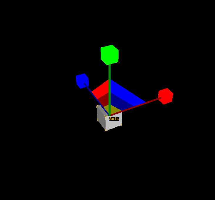

Transformation Gizmos are used by 3D modeling packages to transform objects without having to care about the actual numerical values. Ventuz has three Gizmos (Translate/Rotate/Scale) which can be activated with the respective buttons in the renderer window or by pressing short-cut keys (T, R, S) while the mouse focus is on the renderer window.
See below the icons to switch between the different TRS modes:
| Translate / Move | Rotate | Scale |
Note: The renderer has to be in Editing mode to show the gizmo. You can either switch between normal run and edit mode by pressing Tab while the renderer has the focus or by pressing the respective button in the renderer toolbar. While in editing mode, an orange selection highlight shows which objects are selected.

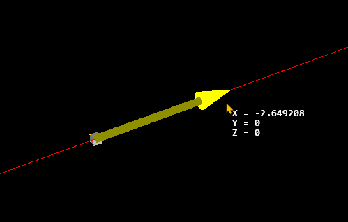

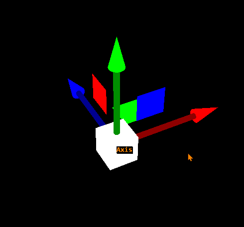

The translate gizmo has three axis and three planes. By hovering over an axis with the mouse, the axis will be highlighted in yellow. Clicking & dragging on one of those axes will cause a translation in that axis only. A line will be shown as a guide while translating along one axis. Clicking & drag on the planes in the gizmo, you will translate on either XY, XZ, or YZ plane. Clicking & dragging on the center white box will allow translation based on the object's aligned in camera view. While performing a translation, the actual coordinates being modified will be shown on screen.
You can make use of the shortcuts (X, Y, Z) to enable an axis lock. When holding one of these keys, show only the selected axis will be shown.
| Translation Modes | Single Axis Translation | Axis Lock |

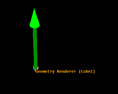

If an axis is bound to another Node, that axis and associated planes will be grayed out. While interacting the gizmo, the tool tip will show (Bound) for any bound axis. As shown below:
| Bound Axis | |

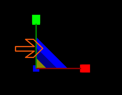

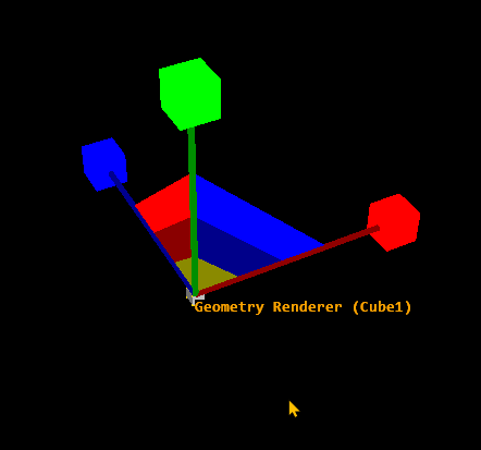

The scale gizmo has three axis and three corner areas. By hovering over an axis with the mouse, the axis will be highlighted in yellow. Click & drag on one of those axes will scale the object along the selected axis.
| Scaling Modes |

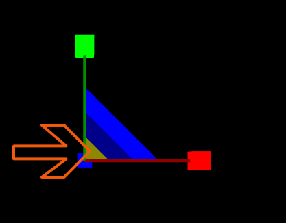

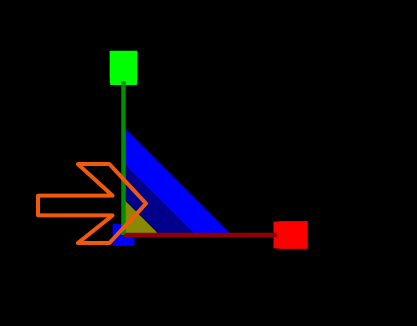

The corner areas in the scaling gizmo are divided into several sections for each axis pair, like XY, XZ, YZ, as well as a dark yellowish corner where all of the Axis meet.
| Scaling Modes and Areas | ||
| Uniform Scaling | Planar Uniform Scaling | Planar Non-Uniform Scaling |
You may scale negative! This will result in a flipped mesh and also flip the gizmos!
