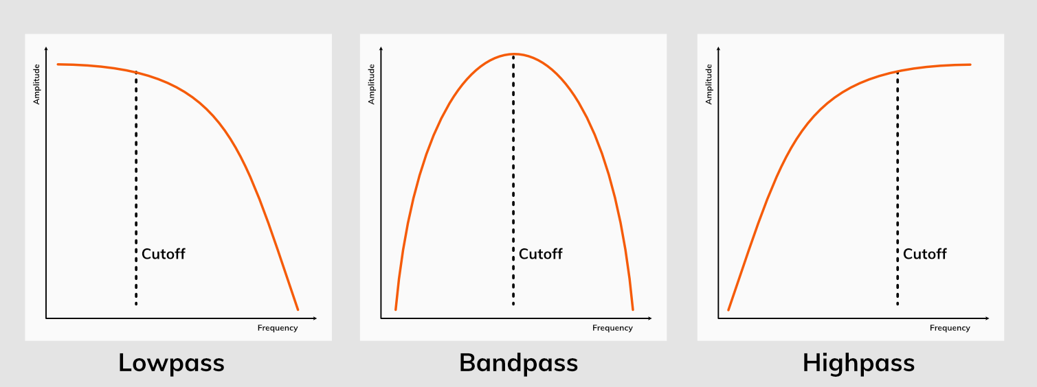

FilterCharacter switches the Value Filter between a lowpass, bandpass or highpass filter characteristics as shown below.
Cutoff sets the normalized cutoff frequency for the filter in the range 0 (lowest) to 1 (highest mathematical correct frequency).

Note: The graphics are a scheme figure and not measured.
