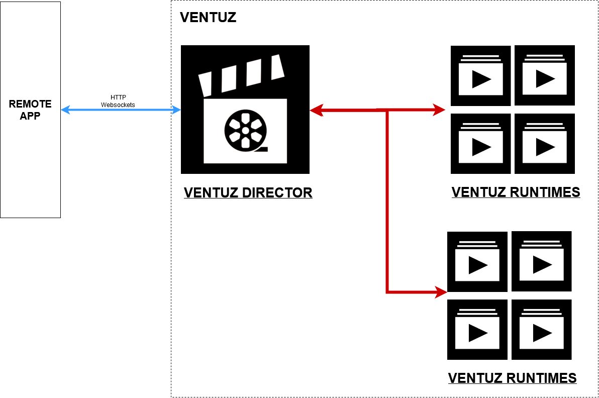

Ventuz Director is a template-based show control application that has been designed to remote control one or multiple Ventuz Runtimes. The already large range of functions can be extended by Plugins. Nevertheless there are some use cases where it makes sense to control Director itself. This is possible since Ventuz version 5.4.0 by using GPI triggers and now gets extended by a full Remoting API that allows you to connect via ​Websocket or ​REST.
This makes it possible and fairly simple to integrate Director into any existing workflow. It can easily be connected to existing software like a broadcast controller or just be controlled from a custom web app.
