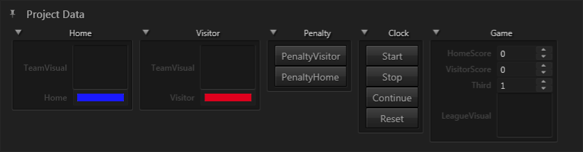

Inside of Director, all project data is automatically analyzed when opening the show. Similar to the Property Editor, a customized user interface is built. Project Data is part of the Default Window Layout but hidden by default. To open the panel, go to Windows / Project Data in the main menu. If no such entry exist in the current window layout, it can be added in the Window Management.
The values entered in the project data panel or events triggered are immediate; and currently neither stored in the show nor recorded on the Timeline.
Any modifications done in the Project Data panel are immediately reflected in the outputs. They are independent of the cue/take mechanism that is used for templates.
