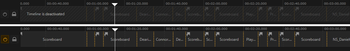

Activation
As mentioned above, all channels on the Timeline are inactive by default. This way neither any user operation is recorded nor does any information stored on the timeline interfere with what the operator wants to do. A channel's timeline is activated by  pressing the respective toggle button on the far left side of the channel's time strip.

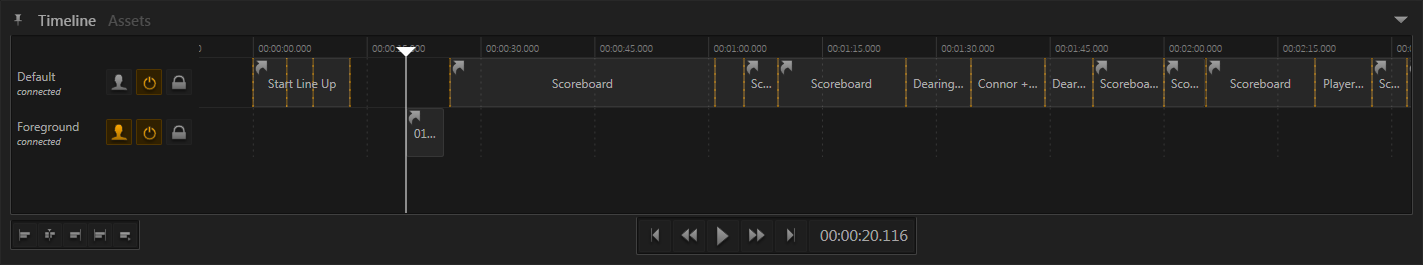

Current Time
Inside the Timeline window, the current point in time is visualized as a white vertical line with a triangle on top. The Timeline Item that lies beneath it is currently on air (in this case "Scoreboard") and the next one will automatically be cued ("Deari..."). The orange lines symbolize Takes. So shortly after 01:20:000, a take will be executed to bring "Deari..." on air and thus take "Scoreboard" off air.

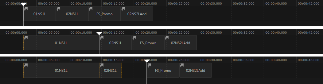

Let's have a look at what happens as time moves on. The following example shows three different points in time within the same show:
  1. In the first image, the show has just started and there are four items cued. As time progress the cued item stay cued and thus move forward with the current time marker.
  2. Shortly after the first image was taken, the operator performed a Take (orange line). As time progressed, the first item stays on air and its length grows with the current time marker.
  3. Shortly after the second image was taken, another take was performed followed by a take out. As time moves on, the gap between the last item on air and the next cued item becomes bigger as nothing has been on air.
