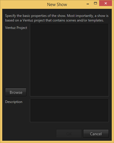

When launching the Director, the window shows icons for the last three shows opened as well as three icons underneath to create a new show, browse for an existing one or opening the help. Press the create new show icon. As an alternative, choose File / New... from the main menu.
The most fundamental information of a show is the Ventuz Project it is based on. Without a project, a show simply would have no templates that it could use. So when creating a show, the operator is first greeted with a list of recently used projects. If the desired project is not already listed here, use the browse button to locate it and add it to the list.

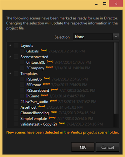

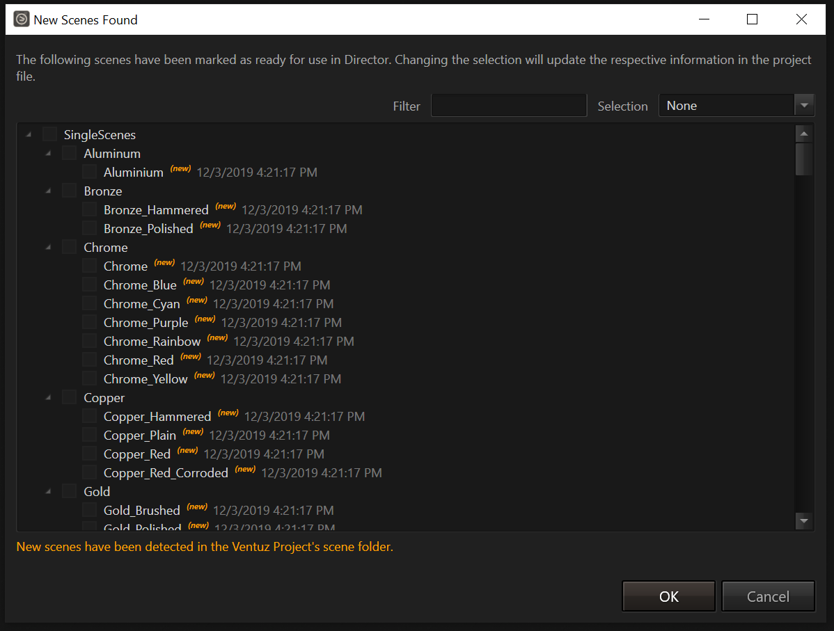

A Ventuz Project file contains a list of scenes that have been marked as ready for usage in Director as opposed to work in progress or none-template scenes. If a show is opened and new scenes have been detected, the operator is presented with a dialog where he can mark the scenes that are ready for use. Or filter through the list by typing into the "Filter" property.
Changes made in this dialog are saved back to the project file so the dialog will not re-appear unless new scenes have been added. The same dialog can also be accessed via Show / Project / Published Scenes in the main menu.

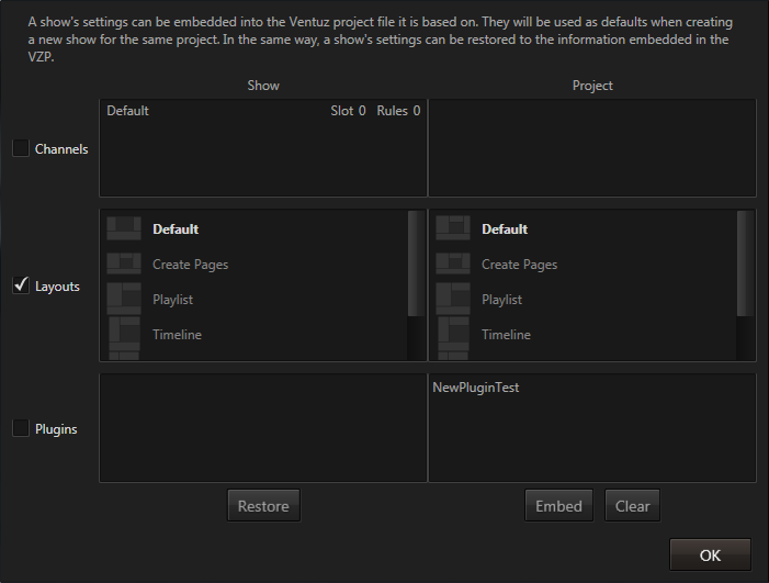

In a similar fashion, other attributes of a show that usually stay constant for a project can be embedded via Show / Project / Show Defaults in the main menu. Currently supported is the channel configuration (e.g. number of channels and where they are connected to), window layouts and plug-in configurations. Default window layouts will be used when there are no layouts for the project in the user settings and channel/plugin configuration whenever a new show is created for the project.
Changing show defaults values will not have an effect on any existing show since each show has its own copy of those value or stores them in the user settings. To set the show's values back to the defaults in the project file, use the revert button.
