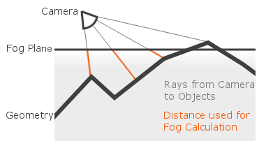

The Ground Fog basically works the same as the normal fog but extends it by one functionality: It will calculate the distance to either the camera position or a defined plane in space, whatever comes first. This way you can create a look of fog that stops at a certain height. The image below illustrates this:
The Inclination and Azimuth define the rotation of the Plane and the Translate properties define the position of its origin.

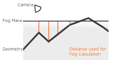

When the Billboard flag is turned on the Object's color is not blended based on the distance to the camera but only based on the shortest distance to the plane, an image is shown below:
