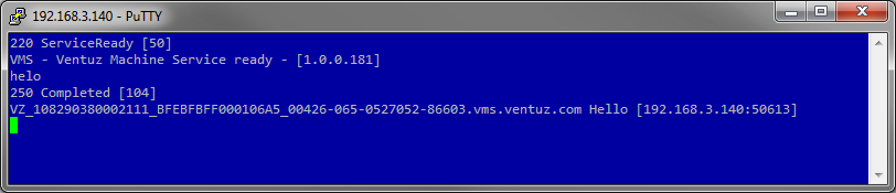

VMS runs as a multi-client TCP server on port 20405 (Ventuz 5 VMS listens on port 19405. A list of ports used by Ventuz can be found here: VentuzIpPorts). The actual communication protocol is text based (UTF-8) and accepts simple human readable commands. A user can use a ​telnet client like ​Putty or ​Microsoft Telnet Client to connect to VMS.
After logging into VMS it displays a welcome message showing the version number of the VMS server.
Typing HELP displays all available commands:

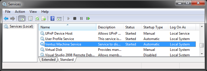

Configure Windows Service
To configure the VMS administration permissions are required. Press the Windows key and enter services.msc into the Search programs and files field. Press ENTER. The Services administration control panel starts up.
Locate Ventuz Machine Service and double click on it to open the service properties.

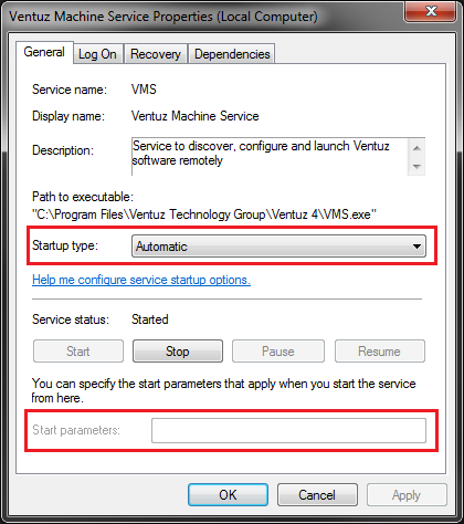

Disable VMS
To disable the service generally turn the Startup type to Disabled. Press the Stop button. VMS will not be started as service anymore. To re-enable a disabled VMS, just turn the Startup type back to Automatic and press the Start button.
Configure IP Restrictions
To apply any IP restrictions to the service, make sure that the Startup type is in Automatic mode. Stop the service if it is currently running by pressing the Stop button. Now enter the IP restriction command line argument described below into the Start parameters field. Press the Start button to start the service again.

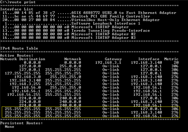

VMS broadcasts status and version information every 5 seconds in order to allowed remote clients to monitor all machines with a network. The UDP packets are sent to 255.255.255.255 in IPv4 networks and to 255:255:255:255:255:255:255:255 in IPv6 networks. The VMSDiscovery class can force all VMS services in the network to send their heartbeat immediately if they receive a discovery request. This request is sent by calling the method Discover()
Please note that VMS uses IP Broadcast to send its heartbeat packets (or discover requests). Microsoft Windows routing rules restrict broadcasting packets if your system has multiple connected IP interfaces with the same metric only the first entry in the routing table for one metric value will transfer the broadcasted packets. You can see the current routing tables by entering the following command in the windows command prompt:
route print
In this routing table only the interfaces with the addresses 127.0.0.1 (loopback) and 192.168.3.140 will transfer the VMS broadcast messages. The interfaces with the address 192.168.56.1 won't transfer the broadcast packets.
This ​Microsoft page explains in-depth the metric system and how to change the metric at the end of the article.

HELO
HELO (short for hello) return a message that contains the unique system identifier (SystemID), the version number of the VMS and the IP endpoint of the connected client.
HELO
250 Completed [104]
VZ_108290380002111_BFEBFBFF000106A5_00426-065-0527052-86603 Hello [192.168.3.140:50613]
The unique system identifier is used to identify a physical hardware within the Ventuz network regardless of its IP address or IP addresses. The VMS Discovery uses the SystemID to identify a system if it appears multiple times (multiple IP addresses) or the IP address is changing. The SystemID is constructed by several system identifier separated by an underscore sign (_). Not all system provide proper unique values for Mainboard-serial or Processor-ID. The combination of multiple identifiers should make this string usable for us:
