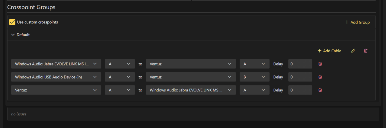

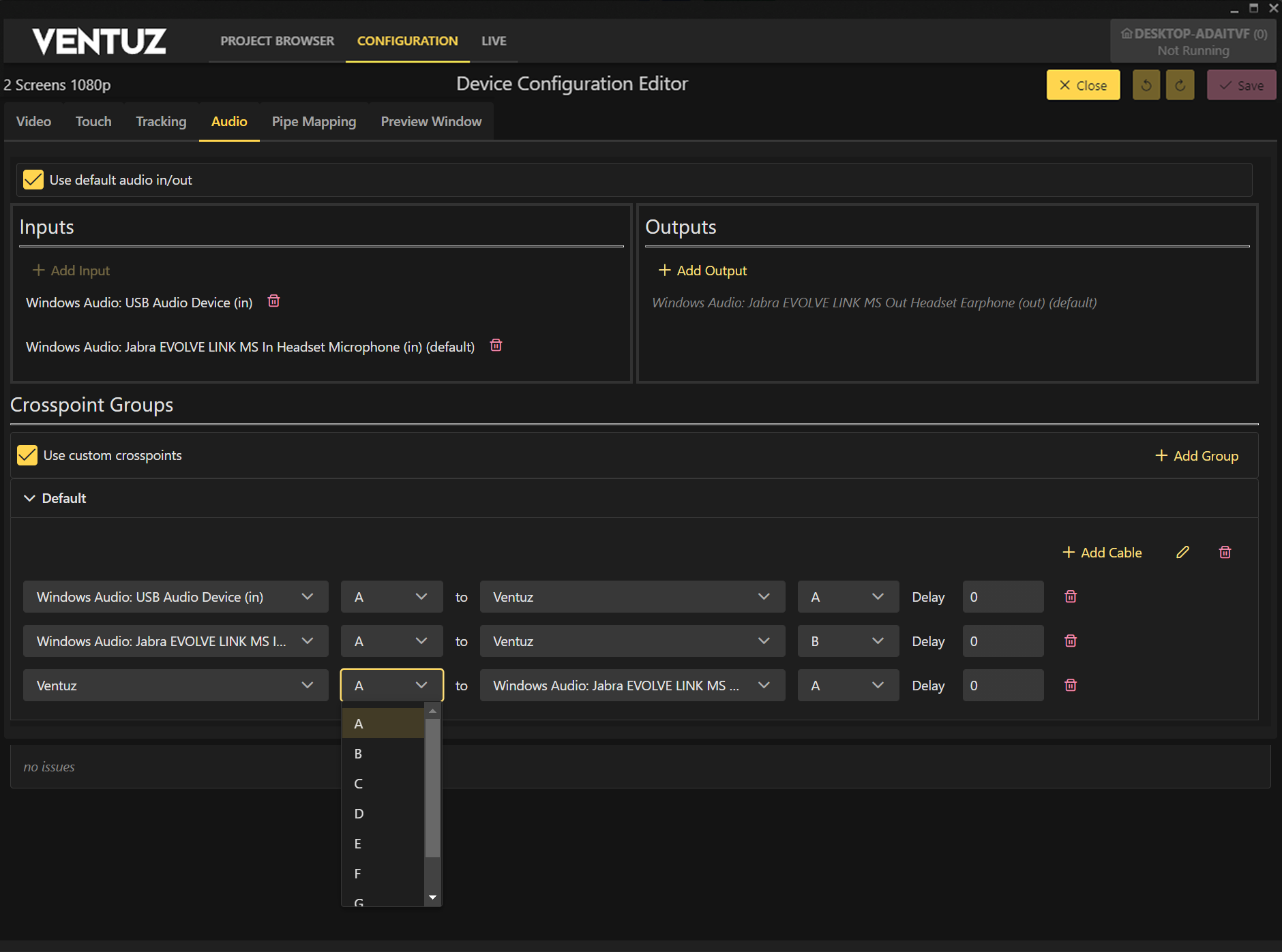

    1. Ventuz Audio Interaction
    2. Crosspoints Example: Adding Ventuz to SDI

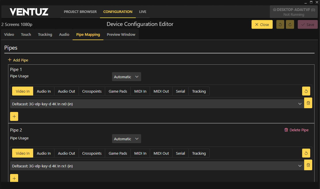

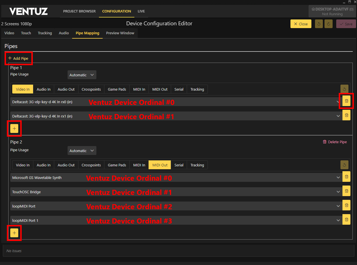

  7. Pipe Mapping

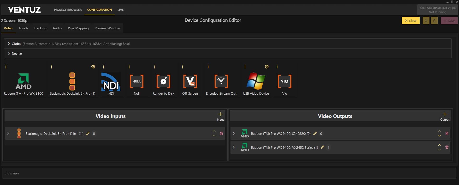

Video
In the Video section all settings are made for video input and output devices. Settings marked with (Live Option) can be edited during running runtime in the linked Live Options.
Global
The Global settings are set for all devices across the machine.
Setting Description
Global Frame Rate Set the global frame rate for the machine. If set to Automatic the output device defines the global frame rate. All outputs must use the same frame rate. It is not possible to render in mixed frame rates from one machine. If set to specified frame rate, Ventuz will try to set the output to this frame rate. GPU out modes can change the output frame rate of the physical to the selected one. The Global Frame Rate is used to calculate many processes inside of Ventuz, such as the Mover Node regardless of this setting. This is still true if the connected display cannot support the set frame rate.
Frame Multiplier Increases the steps of the Cluster Clock by the multiplier factor. This is necessary for a mixed frame rate scenario in a Cluster.
Max Resolution The maximum resolution the Ventuz engine will scale up to while rendering.
Antialiasing Sets globally the Multisample Anti-Aliasing (MSAA). Best (default): Selects the highest available level of multisampling quality depending on the output device. Medium: Selects the mid range (Best/2) of available quality levels. Low: Selects low quality level. None: Disables Antialiasing.
Border Color Default background color of a Screen when no Content is mapped on or the Content is blended with additive blending.
Show Mouse Curser Enables the visibility of the mouse curser in the outputs.
Effect Bleed (Live Option) The Effect Bleed adds an extra margin around the rendered content. The value is the percentage of the output height, which will be added to all sides. It will not extend the visible/physical output, but will allow layer effects to create better results close to the output border or across machine borders in Cluster Setups.

Video Input
Inputs can be dragged into the Inputs window or added by pressing on the Plus sign. There is only one input mode, but some output modes include input streams as well. When adding these streams to the input or output window, the correct stream is added automatically. The stream settings are mirrored on both sides.
These inputs can be used in Ventuz with the Live Video Node with the ordinal number of the stream.
Setting Description
Video Format The input format can be configured independently from the video format of the outputs. For best results, the frame rate should be the same as the output and all signals should be genlocked together. Most video boards support Autodetect mode. If the video mode of an autodetect input switch, the video engine will synchronize on the new signal. If the video board is not in autodetect mode, it will report signal lost until the stream switches back to the configured video format.
Note: There are specific boards, e.g. Deltacast SDI boards, which do not support mixed framerate. See: SDI hardware information
A list of available formats can be found here, but not all boards support all formats.
Use on GPUs Since Ventuz 7 and Multi GPU support, it is possible to select the availability of input streams on a certain GPU with the Use On GPUs setting. Which might be necessary for performance reasons. Per default, all input streams are usable on all GPUs.
Mipmaps Input streams can automatically create mipmaps. Mipmaps are only useful if the incoming video is displayed either in 3D or smaller than 50% of its native resolution.
For more video input settings, check the Advanced Video Options
Some devices may change their stream configuration, depending on the connected physical cabling. In such a case Ventuz will report a missing stream on start-up.
Video Output
Outputs can be dragged into the Outputs window or added by pressing on the Plus sign. Depending on the device, the output mode is a simple output rendering or a different Stream Modes. Depending on the device, select the port to use. For GPU outs the name of the connected display is shown or the port number for SDI devices.
The ID behind the stream name is especially important when setting up the Output Mapping in the Render Setup, since they match with the Output Number in the Mapping tab. With the Pencil Icon it is possible to edit the output to a different existing connector of the device. For example on a GPU out with multiple physical outputs, the used output is changeable without re-creating the whole stream with its settings. For GPU outs the (0) at the end of the output name shows the PCI-slot used for the card.
The number in brackets following the name of the GPU and display name, refers to the physical GPU itself. This number refers to the PCIE slot that the GPU occupies on the motherboard. It is not possible to change this number.
Setting Description
Pipe Select the Pipe to be used for this output. With the Pipe Mapping it is possible to create multiple independent pipes. With this setting you can bind an output to a pipe. With Default the editor automatically maps the next pipe. With no configured pipes, all Outputs are mapped to the one default pipe.
Resolution The resolution Ventuz is rendering on this output. Some Output Modes will disable this property.
Video Format On SDI devices the output is configured as format. The list of available outputs depends on the hardware used. With a specified input stream, the configurable formats might change. For more information: here
Interlaced Activate interlaced video on a specific output stream. (e.g NDI and Render To Disk)
Allow Scaling With multiple outputs rendering the same content, (e.g. one Screen is mapped on a 2160p output and a 1080p GPU output) Allow Scaling will enable upscaling or downscaling the rendering, instead of rendering for each output independently and save performance. For more details see: here
Render On GPU Select the rendering GPU for this device out. With a SDI output device you can specify the rendering GPU. Default will render on the GPU the output is connected to.
Output Mode With the Output Mode the GPU display mode is set. In the Performance Statistics you can check if the selected Output Mode is set and applied correctly
Floating Window: Runtime opens a bordered window in the specified Resolution. The window is movable and resizable. The rendering will stay in the set resolution but might get scaled or filled up with the set Border Color in the background.
Full Screen (Desktop Rate): The output is displayed in full screen at the desktop resolution and refresh-rate. The Resolution Property is not changeable and therefore greyed out. Windows Fullscreen Optimization is used, so there is no output mode change on runtime start and the performance is the same as Exclusive Fullscreen. If there is another application taking focus on the output screen, the rendering will stay in fullscreen on top. Be aware that Windows internal desktop features, (e.g. thumbnail of the Runtime in the Taskbar or highlighting a single application), might result in frame adjustments. Exclusive Fullscreen mode is not affected by this, since it is not using fullscreen optimization.
Full Screen (exclusive): The output is set as a exclusive fullscreen. When starting Ventuz Runtime, the output is re-initialized and will flicker. With more monitors connected, it may take longer for Windows to initialize all of the outputs. In this mode there is no Windows Fullscreen Optimization active. The Resolution might be changed manually, and therefore the rendering is scaled up or down or the aspect ratio changes. The output will always use the full screen. Note: The selected resolution must be supported by the output device. Most screens only support specific formats of resolution and refresh rate. If there is another application that takes focus on the output screen, Runtime will be minimized. Be aware of background programs like malware detection. Ventuz is able to set the frame rate for exclusive fullscreen mode. If the Global Frame rate is specified, the output will be changed to that frame rate if the display device supports it. If a display does not support the specified frame rate, Ventuz will render in the output frequency. Note: Switching from Full Screen (Desktop Rate) to an exclusive fullscreen mode, may require restarting Runtime. With the Performance Statistics you can check if the output mode is set correctly. We recommend using Full Screen (Desktop Rate), since this mode works better with multiple outputs running synchronously
Full Screen (Swap Sync): The same output mode as Full Screen (exclusive), but it behaves differently in a Cluster scenario with hardware synced GPUs on all machines. In such a scenario the Swap Sync mode will only play out a frame on all machines together. If there is a render stall on a single GPU, all GPUs will wait and the frames stay in sync. If there is no sync-board configured, this mode will automatically fallback to Exclusive Fullscreen.
Render to Disk Name File name of the output file, when rendering the output with Render to Disk
Output LUT Applies a LUT on the device output. The LUT's location is either as absolute path, a relative Ventuz:// project path entered or a ​http:// address (only image LUTs) . For linear color spaces: If the Display Transform is set to Bypass the LUT is applied directly onto the linear pixel values. If set to None or a display transform, the output transform is first applied and then the LUT. SRGB (none-HDR): the LUT is applied on the sRGB pixel values. A potential channel conversion to YUV is always done after the LUT.
Touch Groups With these settings you can override the touch settings in the Touch section of the Device Configuration for a specific output. It is possible to map the incoming touch of a GPU touch monitor to a different Touch Group than the other outputs.
Alpha Output There are different modes for rendering the alpha and color channels with external keying for NDI and SDI
Straight: Non-Premultiplied, as most common image formats that allow for alpha (png, bmp)
Premultiplied with lifted Alpha: For some effects, like glare and bloom, Ventuz uses additive blending internally. This can result in an higher color value than the alpha. For premultiplied output this will results in false colors in other applications. When a color value exceeds the alpha value, the alpha value gets lifted in this mode, to make sure, the color never exceeds the alpha value
Premultiplied with additive headroom: The multiplied color value is allowed to exceed the alpha value. Unfortunately, most other software can not deal with this and this will result in wrong color outputs or gamut errors.

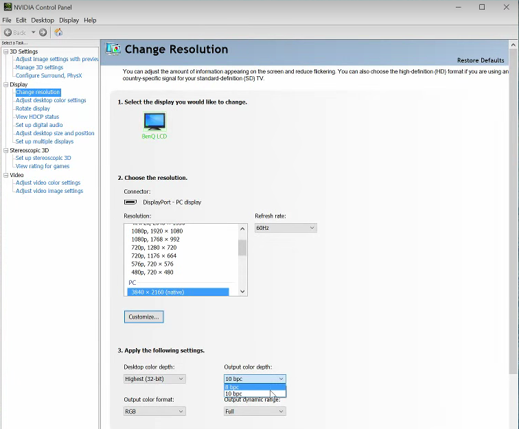

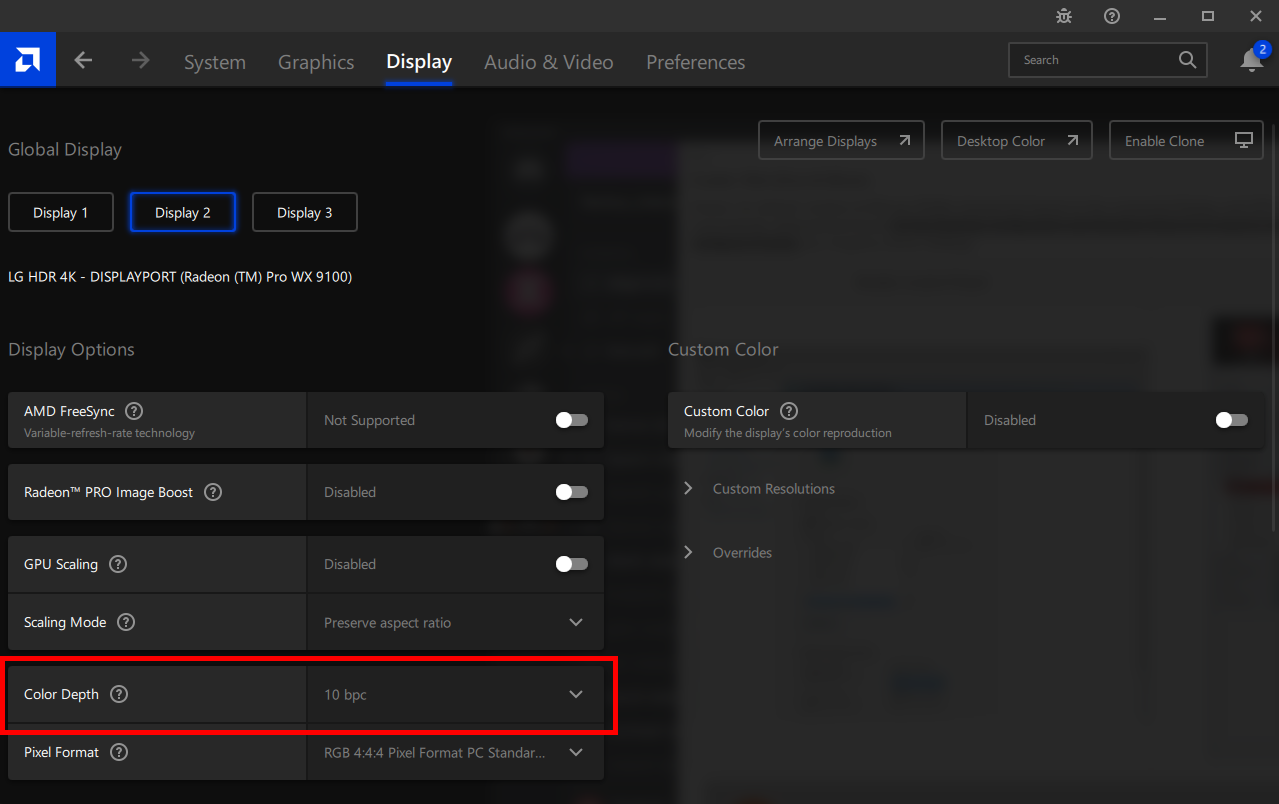

Enable 10bit (DirectX-Mode)
Ventuz renders at 8-bit per RGBA channel by default. However, based on the capabilities of the connected display and GPU, it can also output in 10-bit color depth when in DirectX Mode. This is automatically determined by the desktop configuration, so no changes to the Ventuz settings are necessary.
To enable 10-bit output, simply configure it in your graphics driver settings.
Nvidia Control Panel
AMD Software Pro
Enabling 10-bit color processing is more performance-intensive and may impact overall system performance.

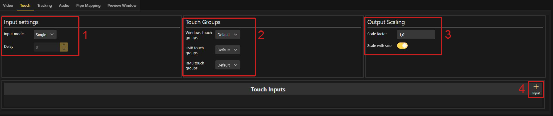

This section provides options to configure Touch Inputs. Input modes for clustering can be defined, specific Touch Groups can be enabled, and the handling of output scaling can be adjusted.
Since Ventuz 7, Windows Touch inputs are no longer defined by the Touch Rectangle set within the Render setup. Instead, they are always mapped onto the entire canvas. To define specific Windows Touch areas, it is recommended to use Touch Groups.
The Windows Touch API was introduced by Microsoft with Windows 7 to provide a standardized method for devices to interact with the Windows operating system. It is typically utilized in simple setups, such as a single touch-enabled LCD display connected to a standalone machine. To enable multi-touch interaction with Windows applications that lack explicit multi-touch support, a Windows Touch display generates both touch input and artificial mouse input.
The TUIO network protocol is commonly used by dedicated multi-touch or other input devices. It has become the de facto standard for transmitting touch information between devices and machines. However, touch-enabled LCD displays often only support the Windows Touch protocol.
Cluster Input Settings (1)
The Ventuz Input Subsystem is capable of distributing input information from one machine to a cluster of machines. For example, a mouse attached to the host computer can be relayed to a number of rendering client machines. For more information, see Input Handling inside Ventuz. Please note that a valid Cluster License must exist to enable the Cluster Networking for interactivity.
Single The machine will only react to input information from devices attached to itself. The information will neither be broadcast to the network nor will the machine react to any information that may be broadcast by a Master machine in the same network.
Master The machine will broadcast the information received from hardware devices attached to it into the network. It will not react to the information directly but listen to the sent network packages in the same way as a Client machine.
Client The Ventuz scene will not receive any input from hardware devices attached to the local machine. However, it will receive and react to input broadcast by the Master machine.
Delay When using multiple machines, each may have a slightly different latency when it comes to receiving information from the input Master. A machine caches received information until the machine's clock matches the timestamp in the input information package plus the processing delay. So if it takes up to 3 frames to send information from the host to one machine but only 1 frame to get it to another, a sufficiently high processing delay forces all machines to process the information at the same time.
Touch Groups (2)
Windows Touch Groups This setting specifies the Touch Groups used for touch events generated by Windows Touch devices. Deselecting all groups will disable Windows Touch functionality. By configuring Touch Groups, it is possible to map touch events to a specific Touch Group. In all Ventuz touch-related nodes, a group can be selected, ensuring that the node only responds to touch events from the designated group and ignores events from other groups.
LMB & RMB Touch Groups These properties define the Touch Groups used for the left and right mouse buttons. The mouse input generates artificial touch events to enable interaction with Touch Nodes. If set to None, the mouse input will not interact with Touch Nodes.
Output Scaling (3)
Scale Factor Use this value to scale the Inertia and Tick Attraction Threshold for all Translation/Rotation/Transformation Nodes. This is particularly useful when the target presentation system has a significantly larger physical display size (not resolution) than the system on which the scene was authored, ensuring consistent Node behavior across different setups.

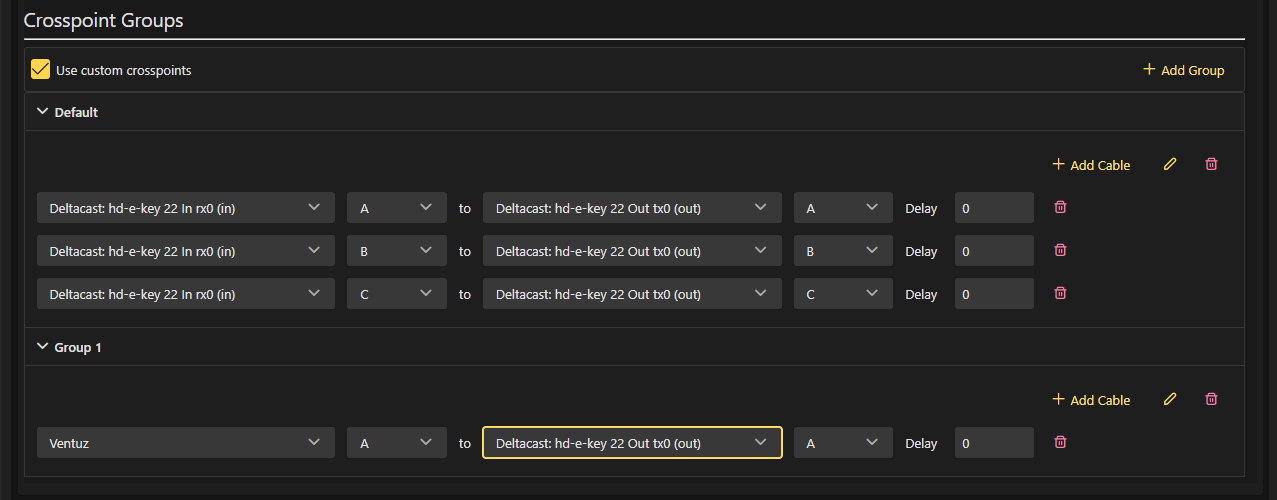

In the absence of a hardware keyer (internal or external) with audio mixing support, the software keyer must be utilized. This example illustrates how to pass through a 5.1 audio signal (not Dolby) from SDI input to SDI output while incorporating stereo sound effects from Ventuz.
The AV configuration for such an situation is as follows:
There are two groups in this configuration:
  • The first group, LoopThrough, loops the SDI audio input to the SDI audio output.
  • The second group, SoundEffects, adds Ventuz audio in stereo to the SDI output.
The volume of each group can be managed using the Volume Control Node. For example, the SDI loop-through volume can be reduced (ducked) before playing sound from Ventuz.
A common mistake is attempting to loop SDI output through Ventuz. This approach will not work. To better understand, consider how normal audio equipment operates: Ventuz audio output functions like a synthesizer. When incorporating a synthesizer into a mix, one does not loop the signal back through the synthesizer itself; instead, the synthesizer is connected to the mixer.
In this analogy, the SDI input is comparable to a microphone input, while the Ventuz output is akin to the output of a synthesizer. To simplify this concept, avoid thinking in terms of inputs and outputs. Instead, approach it from the perspective of a matrix mixer, where audio sources are represented on the left side of the cross-points window and audio destinations on the right. From this perspective, the Ventuz output serves as an input (source) to the mixer.
