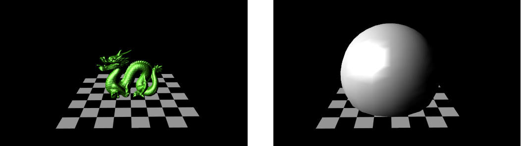

In the following example, we have a dragon model sitting on a plane that we want to be rotatable. Since the dragon is a bit small and has too many concave areas, we're going to put a sphere around it as a touch proxy.

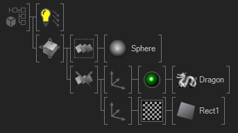

The hierarchy is quite simple: between the Orbit Rotation node and the sphere, a Touch Proxy is added. This will automatically make it invisible. Beneath the Touch Proxy is a Touch Excluder that prevents hit testing to spent any time on the actual rendering geometry. It also has the effect that the plane will actually not be reacting to touches. To temporarily unhide the proxy, activate the Visible flag on the Touch Proxy node.

As mentioned on the Multi Touch page, Ventuz's Multi Touch System supports nested gestures. So if we add a Touch Button node right in front of the dragon mesh, the hit testing will ignore the plane but react on the dragon. In fact, the dragon can now be rotated and tapped when hitting the dragon geometry but only rotated when hitting the sphere. This allows for very complex interaction scenarios.
