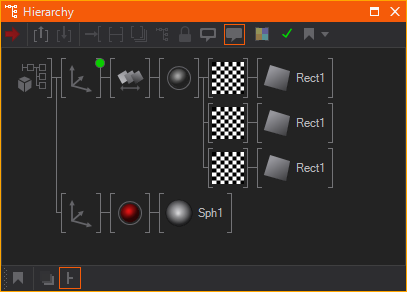

When a new touch is registered, Ventuz calculates which geometry has been touched and relays that information to all interaction nodes that are associated with this geometry - all interaction nodes that lie on the path from the geometry to the scene root. The interaction nodes perform some calculations to translate the 2D touch position to meaningful values such as the angle of rotation that is implied by the users movement in case of a Touch Rotation node. These values are both provided as output properties as well as used by the nodes themselves. For example, a Touch Translation node contains an axis inside and automatically performs the appropriate motion for the touch movement. A Touch Paint node works like an Overlay Rectangle and automatically displays the texture that is painted by the touch movement.
In the example shown here, touching any of the three rectangles and moving the touch will cause the Touch Translation to update its internal axis and thus move all nodes in its subtree of nodes. The sphere however is neither affected by this nor does it itself react to touch input.
No bindings are required. Inserting the interaction node will automatically associate that node with all geometries underneath it.

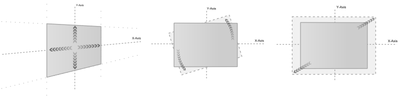

When an interaction node receives touch information, it performs some calculations of its own to map the 2D touch position to meaningful values. For example, the Touch Translation first computes the intersection point of the viewing ray with the X/Y-plane of the world coordinate system as it is for the translation node. So any Axis above the interaction node will affect how the touch movement is mapped. If the axis contains a rotation of 45 degrees in the Y-Axis, the translation will map and move along the rotated X-Axis.
The translation node will output the amount of units that the internal axis would have to be shifted in the X- and Y-axes such that the object stays fixed with respect to the touch. Other nodes have similar properties that provide the interpreted values.
Except for the initial intersection point, no part of the mapping process uses the geometry that was hit. It is therefore important what position/orientation the interaction node has versus what the geometry has.
The Touch Transformation nodes have Limit properties that can artificially restrict the interval into which the touch information is mapped. For example, a Touch Translation can be restricted to always have a Y-value of zero or a Touch Rotation can be restricted to only rotate between plus and minus 45 degrees. These values also are based on the world coordinate system at the interaction node level.
To re-iterate, the way that touch movement is mapped, and thus translated to numeric values, does not depend on the shape/size/position of the object but the position/scaling of the interaction node itself. Whether inserting a translating/rotating/scaling axis as a parent or child of an interaction node produces two different results!
