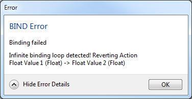

The Loop Breaker stores the value passed to its Input property and only updates the Output property after all validation is done. This has two effects: For one, it delays the value propagation by one frame, for the other, it decouples its input and output properties, thus breaking the dependency loop.
Chances are that a typical user will never need to employ this node. Either he will never run into this problem in the first place or be able to solve it by a redesign of his binding hierarchy. As long as the following error message does not pop up, simply ignore and avoid this node!
