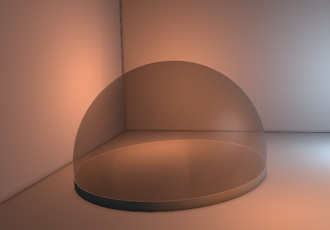

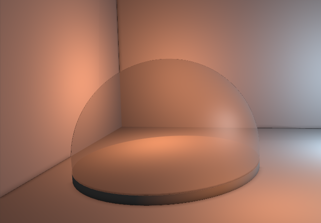

Write Normals can be turned off to prevent normals from being written. This normally is turned off only if the Write property is set to off as well. Normals are used e.g. by the Screen-Space Ambient Occlusion (SSAO) effect on 3D Layers. The SSAO would not be rendered for areas behind transparent objects, because only the depth and normals of the transparent object's surface is known. By turning off writing both Depth and Normals the SSAO is now calculated for objects behind (but not for the transparent object in the front).
Z-Write YES NO NO
Normal-Write YES YES NO
