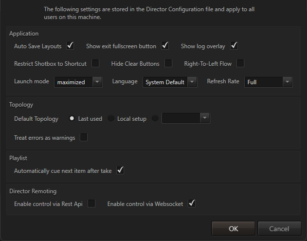

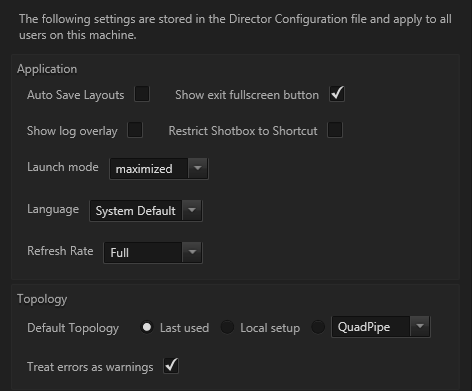

The Director application settings are various options that can be used to customize application behavior. They can be accessed via the main menu under Tools / Options and are stored in the Director.dcfg config file. As a consequence, they affect all users on the machine.
Application
Name Default Description
Auto-save layouts Enabled By default, Director will save all modifications done to the window layout back to the user-settings when a show closes. To prevent this from happening and thus always having the original layouts back when opening a show, deactivate this option.
Show exit fullscreen Enabled Enables a small exit fullscreen button in the right top corner.
Show log overlay Enabled When a warning or error is logged, Director will display a short message on top of the application window. That is helpful to make the user aware when a problem occurs and he should check the log. This can become distracting in some scenarios.
Restrict Shotbox to Shortcut Disabled If enabled, the shotbox will only open when the defined shortcut is pressed. If disabled, whenever the property editor window is in focus, the shotbox will open as soon as the operator starts to type.
Hide Clear Buttons Disabled Removes the buttons which allow clearing of output from various interface elements.
Right-To-Left Flow Disabled Changes the flow direction of text in the Property Editor.
Launch mode Maximized When Director is launched, the main window will start in this mode. Options are: windowed (normal window), maximized (normal window but using complete screen), full screen with menu bar (same as previous but without window frame) and fullscreen (not showing menu bar). Especially for dedicated Director machines, it might be a good idea to always start in full-screen mode and prevent the operator from seeing the rest of the application.
Language System Default By default, Director will start with the System language but can be switched explicitly here.
Refreshrate Full Updates the Director Views with the same refreshrate the Runtime is actually rendering. Do not confuse it with the refreshrate of the Renderer! It is not influenced by that option.
Topology
Default Topology Last used When Director is launched, this topology will be activated. For a dedicated Director machine in a fixed environment, it is advisable to change this option to the specific topology that is always used for that environment.
Treat errors as warnings disabled Any error in the active topology will be treated as a warning and therefor does not prevent to go on with you current show.
Playlist
Automatically cue next item after take Enabled When taking an item in a playlist the next item will be automatically taken when the previous take is done
Director Remoting
Enable control via Rest Api Disabled Enables Director Remoting via Rest API (see Director Remoting)
Enable control via Websocket Disabled Enables Director Remoting via Websocket (see Director Remoting)
