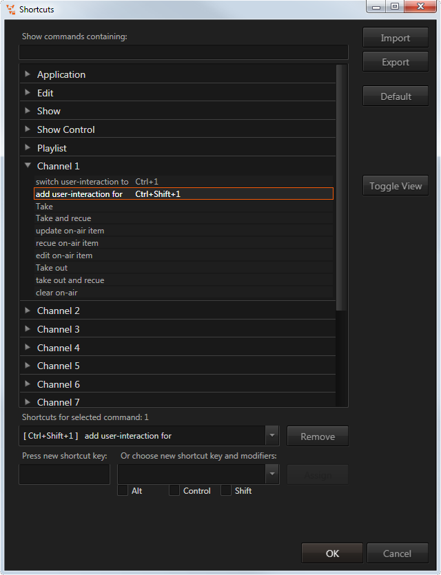

Starting with Ventuz Director V5.4, the shortcut manager was revamped to allow e.g. multiple keys per command. The shortcut manager can be found in the main menu under Tools / Shortcuts. The shortcut layout is stored in the user settings on a machine. To transfer a layout to other users and/or machines, use the export and import buttons.
The list below shows the most important default keyboard shortcuts. To reset a shortcut layout, use the "default" button.

Assign Keys
Every command can handle up to 3 triggers. To assign a new trigger to a command simply follow these steps:
  • select a command in the list
  • either assign a key by pressing it on your keyboard
  • or choose the key and modifier from a list of keys
  • press Assign
Keys that are not on your keyboard can be assigned through the provided list

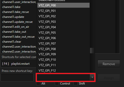

Assign GPIs
To assign a GPI trigger follow the steps above and select VTZ_GPI_Pxx from the provided key list.
The GPI configuration and the assignment of the pins is documented here.
Remove Keys/GPIs
To remove a key or GPI from a command follow these steps:
  • select a command from the list
  • select one of the assigned keys/GPIs
  • press Remove
