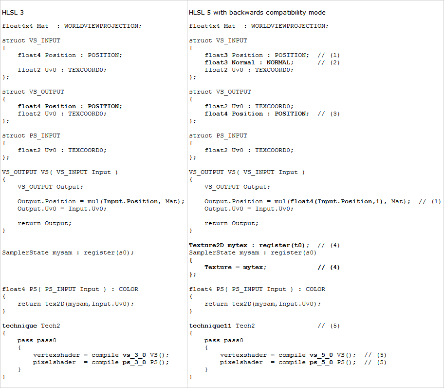

HLSL 5: How To Rewrite Shaders for the HLSL Node
The HLSL node is based on Microsofts Effect Framework. Unfortunately, DX9 shaders (shader model 1.0 to 3.0) will not run on DirectX11. The effect framework has been updated to version 11 so it generates shader model 5.0 shaders, as required for DirectX11. This introduces many incompatibilities with the HLSL source code in the HLSL node.
Here is an overview of what needs to be changed:
Position and normal are float3
DirectX9 allowed to define position and normal as float4. The system would automatically set the w value of the position to 1.0 and the w value of the normal to 0 when the vertex format did only provide x, y and z. This will not happen in DX11:
  • specify position and normal as float3
  • when doing the matrix multiply, extend the vectors to float4 with a proper value for w.
Vertex Formats
In DirectX9 it was allowed to have the vertex format in the shader to be different than the vertex format of the vertex buffer. A conversion step was applied automatically. This is not allowed in DirectX11 anymore since it added overhead and complexity to the graphics pipeline.
Ventuz detects the required vertex format in a rather crude way by scanning the source for certain names, assuming these names are used as vertex shader semantics.
If your source contains the word "BINORMAL", we use
float4x4 Mat  : WORLDVIEWPROJECTION;
struct VS_INPUT
    float3 Position : POSITION;
    float3 Normal : NORMAL;
    float3 Tangent : TANGENT;
    float3 Bitangent : BINORMAL;
    float2 Uv0 : TEXCOORD0;
Otherwise, if your source contains the word "TANGENT", we use
struct VS_INPUT
    float4 Tangent : TANGENT;    // 'w' contains sign of bitangent
You are supposed to calculate the Bitangent like this:
float3 bitangent = cross(Normal,Tangent.xyz)*Tangent.w;
Otherwise, we use
struct VS_INPUT
Make sure you use one of these three templates.
Passing Variables from Vertex to Pixel Shader
DirectX9 allowed mismatching declarations of vertex shader outputs and pixel shader inputs. This causes additional overhead when matching vertex and pixel shaders. So in DirectX11, the pixel shader input variables, in type and semantics, must match the vertex shader output variables.
  • The Vertex shader may output more variables than the pixel shader reads, but the variables the pixel shader reads must match in type and semantic name, in the right order, starting at the beginning.
  • Semantic names may be anything, not just TEXCOORD(X).
  • System Values (like POSITION) should be added after the normal variables. This is the most common problem.
Textures must be Tied to a Sampler
DirectX9 had a fixed mapping between 16 textures and 16 samplers. DirectX11 allows for 128 textures and 16 samplers, so it requires a variable mapping between textures and samplers. This is enforced by the effect compiler.
For every texture, you must provide a sampler that is bound to the texture.
New DirectX 11 Keywords
Since we are now compiling for shader model 5.0, the technique keyword must be replaced by technique11 and the shader models must be updated from xs_3_0 to xs_5_0
