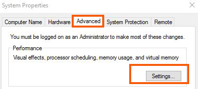

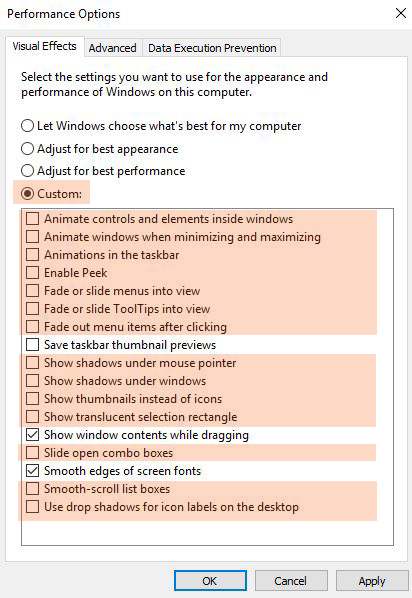

  • Disable Windows Visual Enhancements with the following steps:
    • WindowsKey + R to open the command prompt
    • enter: sysdm.cpl and press enter
    • System Properties Window will PopUp
    • Select the Advanced tab and click the "Settings" in Performance:
    • Disable the Following marked elements to increase the Visual Performance from Windows
