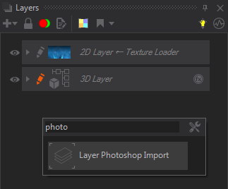

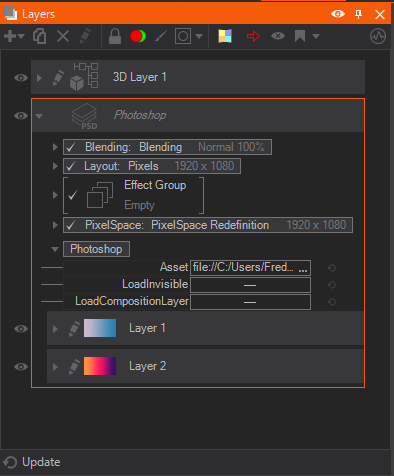

You simply need to add a new Layer of the Type Photoshop Import. It will create a Photoshop Layer Group - a special Layer Group that can read out PSD files and create Layers based on the original layers into that file. For each layer it creates a Texture Layer and copies the Opacity, Blending and Layer Mask to the new layer. Alternatively, you can Drag and Drop the PSD file intp the Layer Editor.
After import the created layers can be edited like any other Texture Layer, and the Photoshop Import Layer like any other Layer Group. Both the PSD Layer Group and the individual layers features the same properties as any other layer inside Ventuz, they support effects and their layout, blending, etc can be edited like any normal Ventuz layer.
Note that Text Layers will rasterized before import and the text itself is not editable anymore. The Layer behaves like any normal Layer. The order of the Layers will be shown in opposite direction to the Photoshop Layer Editor, because of the render direction within Ventuz.
Blending operations, including modes, opacity and masking, can be switched ON or OFF for each individual layer by Clicking on the check mark close to the Blending caption. If the check mark is shown, the blending operation, including opacity, mode and mask, is calculated for the current layer. If a dash is shown in front of the Blending options, the blending operations are not calculated.
The properties available allow editing the Blending Mode with the same standard Blending Modes used by most compositing software packages like Photoshop, Blending Opacity, where 100% means totally opaque, and some controls that allow connecting or disconnecting layers, like Blending Blocked.
