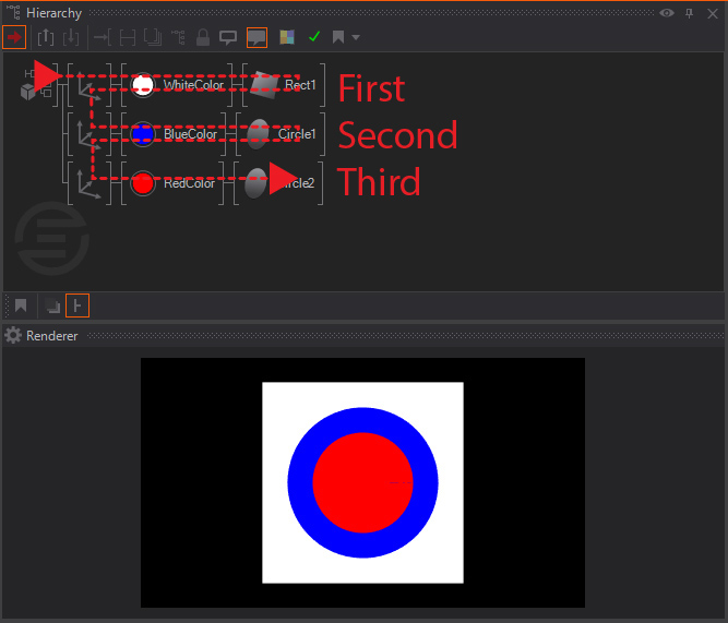

The way the hierarchy is shown also reflects the rendering order of the engine. Generally speaking the engine is processing the nodes the way they are sorted in the hierarchy. It processes node by node from top left to bottom right.
This way it is easier to understand how to sort objects - this is important because e.g. objects that are drawn first will be occluded by objects that are drawn later if they are located at the same position (see also Z-Buffer).

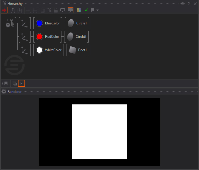

Following is an example of a hierarchy and its rendering:
Order and Sorting
The above image illustrates the render order and the sorting order. In this example the images share the same z-position and are still layered over each other, therefore the hierarchy order plays a big role to decide what gets drawn first and whats on top. If you would resort the same scene and put the bigger white rectangle in the third place, it would cover all other elements, since this white rectangle would be drawn last.

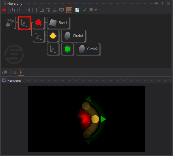

The hierarchy order is not only important for the rendering order it is also important for the way you would e.g. Transform (that is moving, rotating and scaling) elements. By default all objects are placed in the origin of the world with no rotation and a scaling of 1. With one or several axes in front of an object you can change this transformation.
As you can see by the following image, the very first axis is used for rotation and all axes behind that very first are depending on its rotation. Therefore if you rotate the first axis, all others are depending on that. The same goes for the translation. If you change the translation for the very first axis, the rest will follow since they are in the same branch of the hierarchy. If you alter the position for the second axis, the third will still follow. This way you can create a bunch of arranged elements, for user interface elements for example, but still move a whole group. Keep in mind that the same goes for scalation, translation, colors etc. In fact every hierarchy node affects each node in its Subtree.

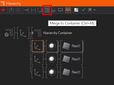

Aside from creating a group node in front of a bunch of hierarchy nodes to get a better kind of structure you can also merge nodes to a hierarchy container. Just select from where you would like to merge the nodes into a container and click  the Merge to Container icon in the top bar of the hierarchy editor or use the ctrl +  m shortcut. This creates a new node that contains all merged hierarchy nodes. It behaves just like its contained hierarchy tree.
You can have very complex and deep layers by creating containers, since you can container in a container and so on. To navigate between these container levels you can use the Level Up/Down buttons or use the shortcuts ctrl +  u for up and ctrl +  d for down. Middle-clicking the container moves your view inside of it as well. Double- or middle-clicking the arrow on the top left of the hierarchy when inside a container will move you outside of it.

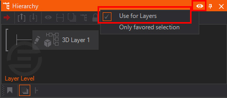

Another useful feature is to use the Hierarchy Editor for Layers. You can enable this feature by click  on the Eye icon at the top right of the hierarchy editor window and select the Use for Layers.
This way the Hierarchy Editor will switch to a view users are used to have from older Ventuz versions, without the layers workflow. The mode makes it possible whenever you navigate to the top of the hierarchy - the Layer Level - to visualize the individual layers as nodes in a hierarchy used way. The Layers View itself will then be unused and appears to be disabled. You can as well hide it now with the View menu in the menu bar of the designer or with the SHIFT +  F5 shortcut.

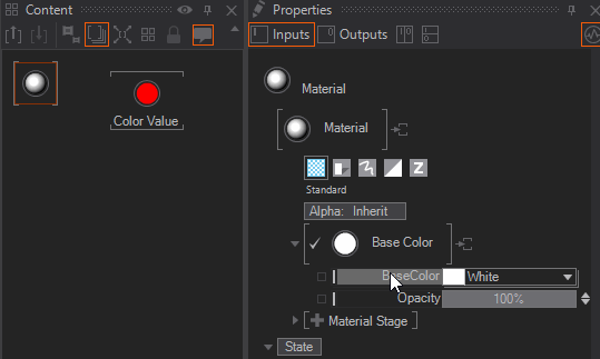

Bindings are visualized with an arrow going from the providing node to the receiving one. To bind a Property of a node to a Property of another node you need to drag  the receiving property you to a node that contains the wanted property:
If there are multiple possibly fitting properties a dropdown menu will pop-up asking you to select the target property.

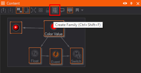

To have a better overview of the content area, especially for big projects and complex logics, it would make sense to use the family, which is a kind of grouping, or to merge parts of the logic into a container. In many cases it makes sense to create a family out of a group of nodes. This will generally help you to get a better overview for yourself or a colleague who is working with that project as well. Next to it will visually keep nodes together and mimics the sense of that the nodes are in a kind of relation - therefore the naming family. Select a bunch of logic nodes and use either the shortcut ctrl +  shift +  f or select/ click  the Create Familiy icon in the top bar of the content editor:

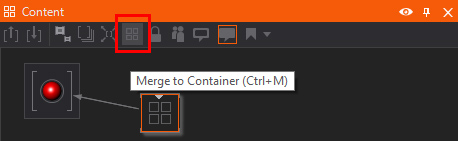

The same way you would merge nodes into a Content Container - you select a bunch of logic nodes and use either the shortcut ctrl +  m or select/ click  Merge to Container
You can have very complex and deep layers by container, since you can container in a container and so on and so forth -the same way like with the hierarchy editor. To navigate between these container levels you can use the Level Up/Down buttons or use the shortcuts ctrl +  u for up and ctrl +  d for down.
