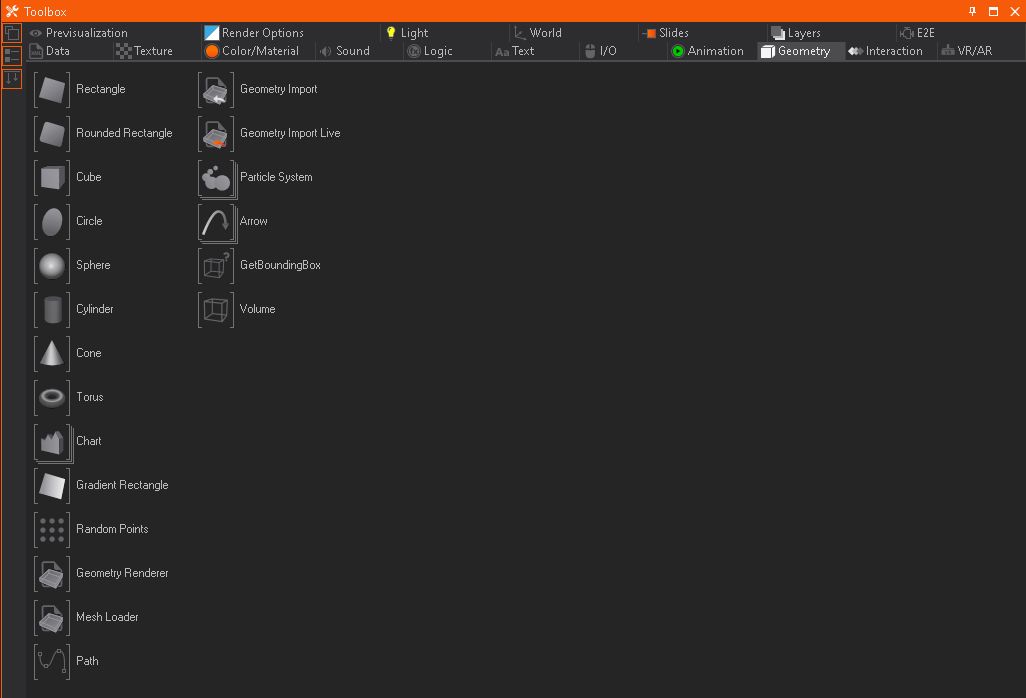

The Toolbox contains all the Nodes that ship with Ventuz. Each node is either a Layer (brackets in all corners), a Hierarchy Node (brackets to the left and right of the icon) or a Content Node (brackets at the top and bottom of the icon) and belongs to exactly one category (i.e. World, Interaction, ...). Some of the entries shown in the Toolbox represent more than one node which is visualized by lines to the lower right that represent a stack underneath the icon. or  click on those entries will show all nodes that belong to that set of similar nodes.
A node can be added to the scene by dragging it from the Toolbox to the appropriate editor, depending on the node type (Layer, Hierarchy or Content).
For some nodes, such as the Text node, dragging the set representative into the scene will activate a wizard that will ask for the desired provider type at the end of the drag & drop operation. The wizard will then create additional nodes which are necessary for correct operation. This is different from right-clicking the set representative and choosing the specialized node, which will only add that one node to the scene.

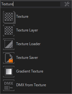

The Fast Toolbox offers a faster way of accessing Toolbox nodes than by using the Toolbox window itself. The Fast Toolbox can be opened anywhere on the screen by pressing SPACE if the Hierarchy or Content Editor has the window focus. Ventuz offers two types of Fast Toolboxes. Which Fast Toolbox is used can be selected by clicking the wrench icon inside the Fast Toolbox or by pressing Ctrl +  Space while the Fast Toolbox is open.
The Alphabetical Toolbox lists all nodes, sorted alphabetically. By entering characters, the nodes listed will be filtered. Nodes can be directly drag&dropped from the Alphabetical Fast Toolbox.
The Categorized Fast Toolbox lists all Toolbox Window tabs in a list. Nodes can be access from the toolbox by either clicking on a topic with the mouse or by pressing the keyboard shortcut displayed on the left side of a topic. This will open the appropriate sub menu listing all available nodes in that category.

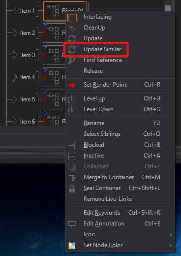

A common way to use the repository is to create Interface Containers that then can be added to the repository as a new kind of node. The big advantage of using an Interface Container is that you are able to apply changes made to the original repository item very easily to instances of this item used in scenes.
Every Interface Container that you added to a Scene using a Repository Item will keep a reference to that item.
Make the changes you need to do in one of the scenes in which you used the item and drag and drop the Interface Container onto the Repository Item in your Repository Window. Now you can either change all instances you need to change by dragging the item from the Repository to every instance you want to be updated or  click onto each instance of the Repository Item and click on Update. You may also update all containers referencing an item inside a repository by  clicking the Update-Icon on the top of the Repository Window. It is also possible to update all similar Interfacing Container by clicking on the Update Similar in the context menu, which is opened by  click and hold. This will update the selected Container and all others in this scene which also reference the same Repository item.
Note that only Interface Containers in currently opened Scenes will be updated.
Locate Repository Container
It is possible to locate used Repository container in the Hierarchy Editor via the context menu on the corresponding container. Simply hold the and click on Find Reference. If your Repository window is open it will highlight the selected container.
