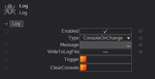

Inputs
  • Enabled: Boolean, enables or disables the Log Node.
  • Message: User can define a custom log message message.
  • Write to log file: Boolean, En or Disables the ability to also write everything also into the log file.
  • Trigger: Event, Triggers the Node once. Needs the right type selected to be working.
  • Clear Console: Event, clears the console.
The Type property defines the way the message should be logged.

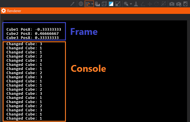

  • Frame updates the message every frame in the statistics
  • Console prints the message to the console of the statistics every frame
  • ConsoleOnChange only does so when the message is actually changed
  • OnTrigger prints the message to the Console every time the Trigger method is fired. This way also Events can be tracked. The event argument can be accessed by writing {0}  inside the Message string.
  • With Clock inserts the Cluster Clock in the printed string
